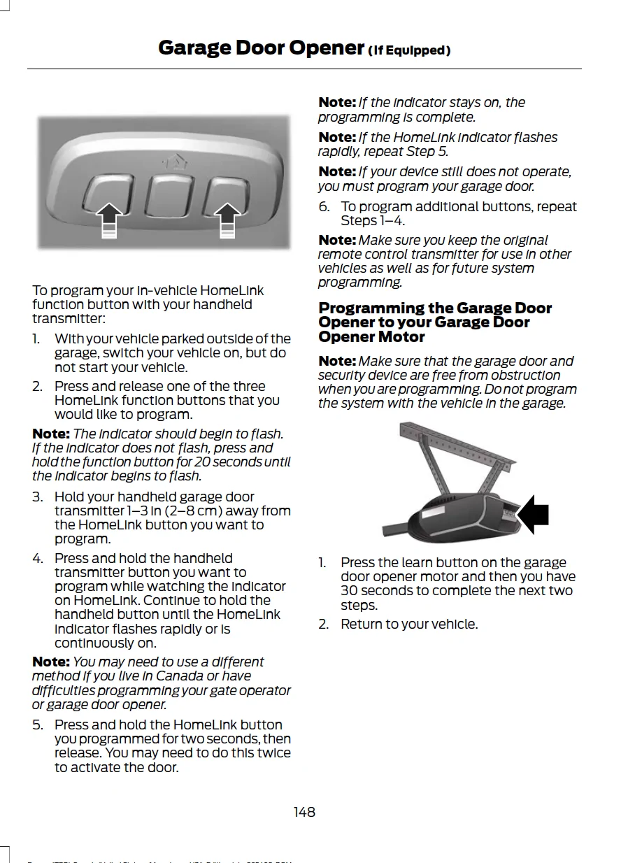

I did mine without a remote even though I have extra remotes newer GDO with rolling codes you just need to hit the learn mode on the opener

Actually, this worked. I hadn't bought a remote yet but was reading about how it works and rolling codes. Seems it would have been a waste of money anyway because I've read that the rolling code remotes won't work. Mine is working... thanks to all who answered! :like:
