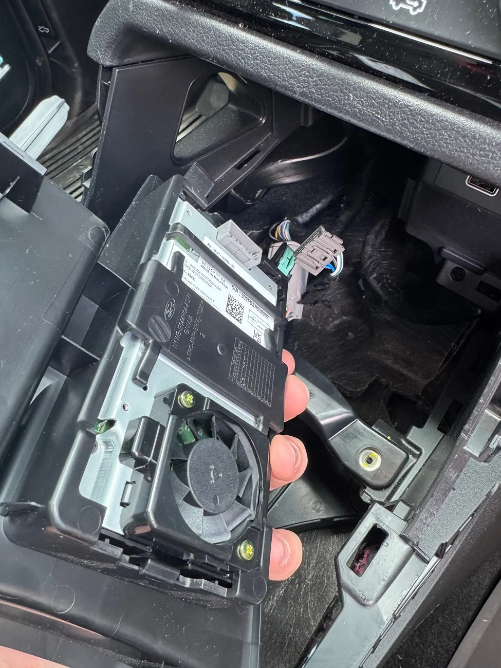

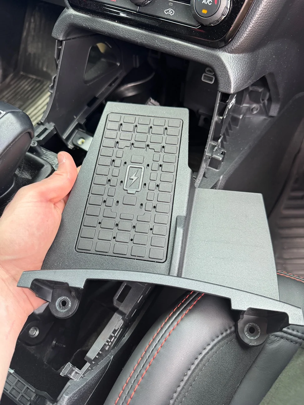

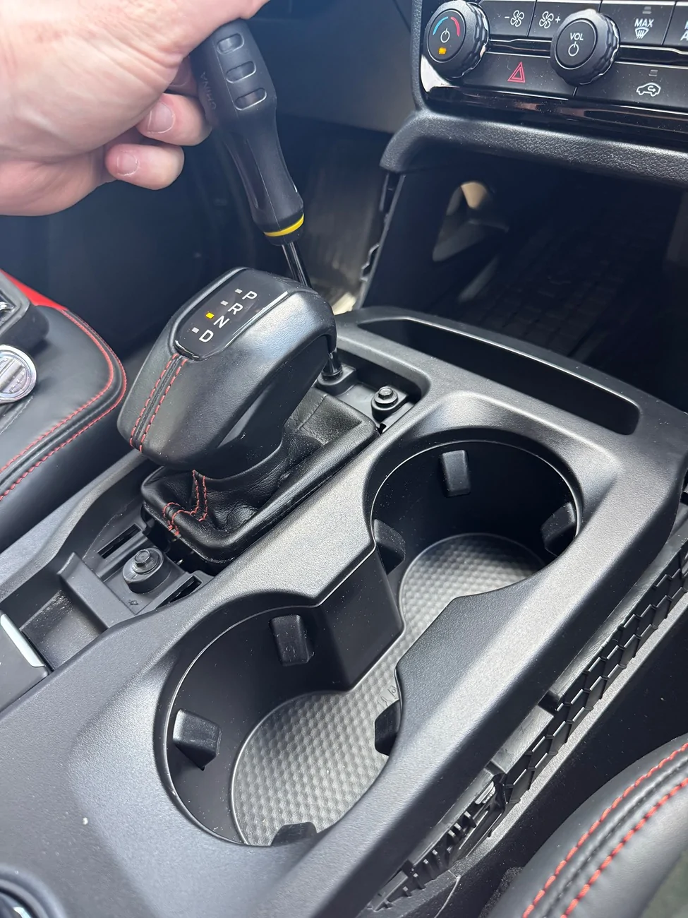

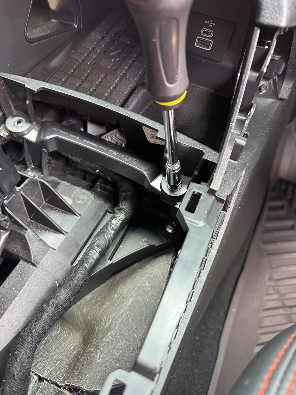

Was able to unplug the wireless charging pad from the harness. No more blistering, hot phone, and no codes thrown.

If you don't want to disassemble the console, you can remove the wireless pad directly. If you look at the bottom of the pad, there's a small "slot" in the bottom center. Take a trim removal tool or small flat-head screwdriver that fits and slide it into that slot, then lever forward a bit. That will release the clip that's holding in the bottom of the pad (you can see the clip in the first image above, bottom center, right behind the fan). You'll know you've released it b/c the pad will pop up a bit. Now you can pull it straight up, there's enough slack to flip it over and unplug it. I had to do this b/c the pad in my original truck was bork'd and Ford "wouldn't throw parts at the problem." I bought my own pad and replaced the broken one with the new one, problem fixed. BTW, thanks, Ford. I found a video online showing how to get the pad out without having to pull things apart, which I was very thankful for.
