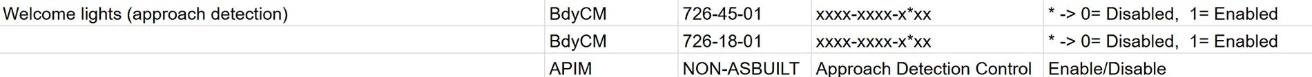

So just want to confirm if we want to activate approach lighting we have to change all 3 of these settings?
What are you looking at here and how would you change it ? I'm missing something in all this talk. Any help would be greatly appreciated !

Ok I changed the settings in Forscan so far so good.
This is a cool setting when you walk up to the truck it turns on all the zone lighting.
I also turned on Bambi mode and upped the heated steering wheel from 35c to 37c
So far no issues but haven’t tested everything and haven’t driven much

Can you tell us what settings you changed? I made some changes but nothing that turns the lights on when you walk up.
changed all the settings for approach lights per the forscan sheet we have here
