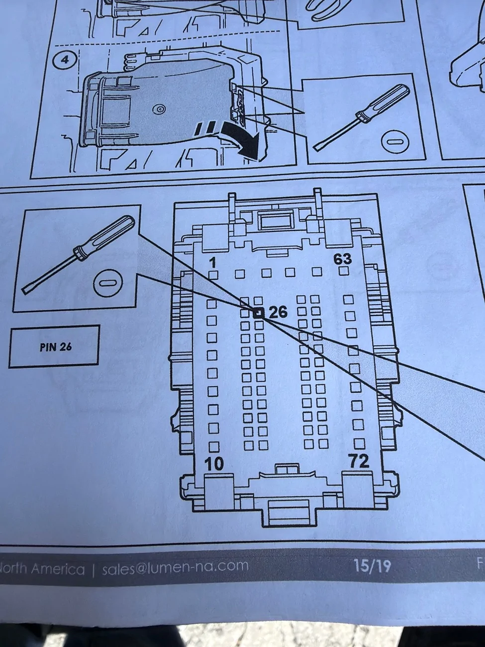

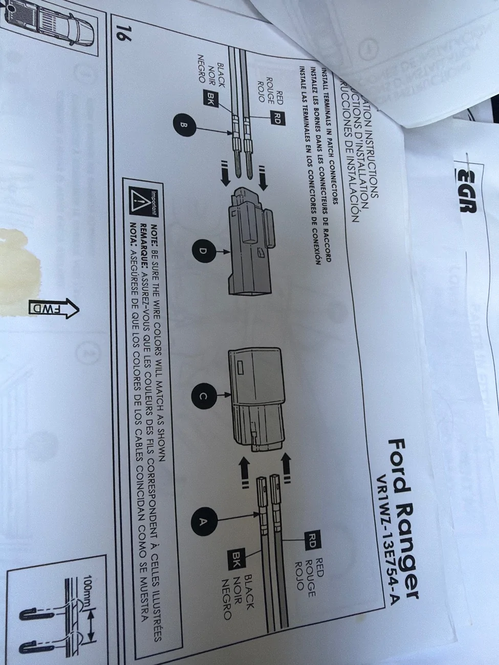

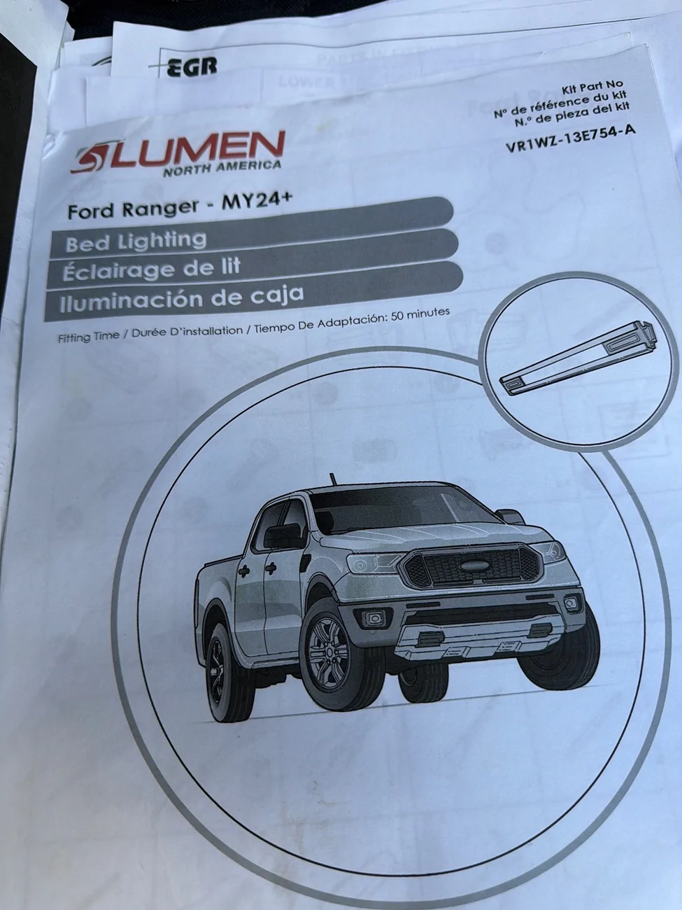

Ford accessories website has a kit for bed lights that are triggered when the dome light comes on. The instructions are on the site. But it isn’t easy-peasy for sure.

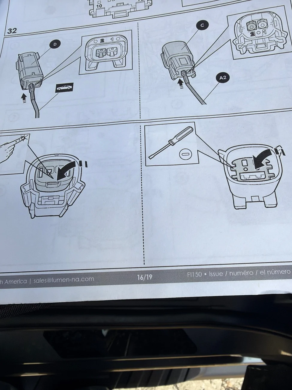

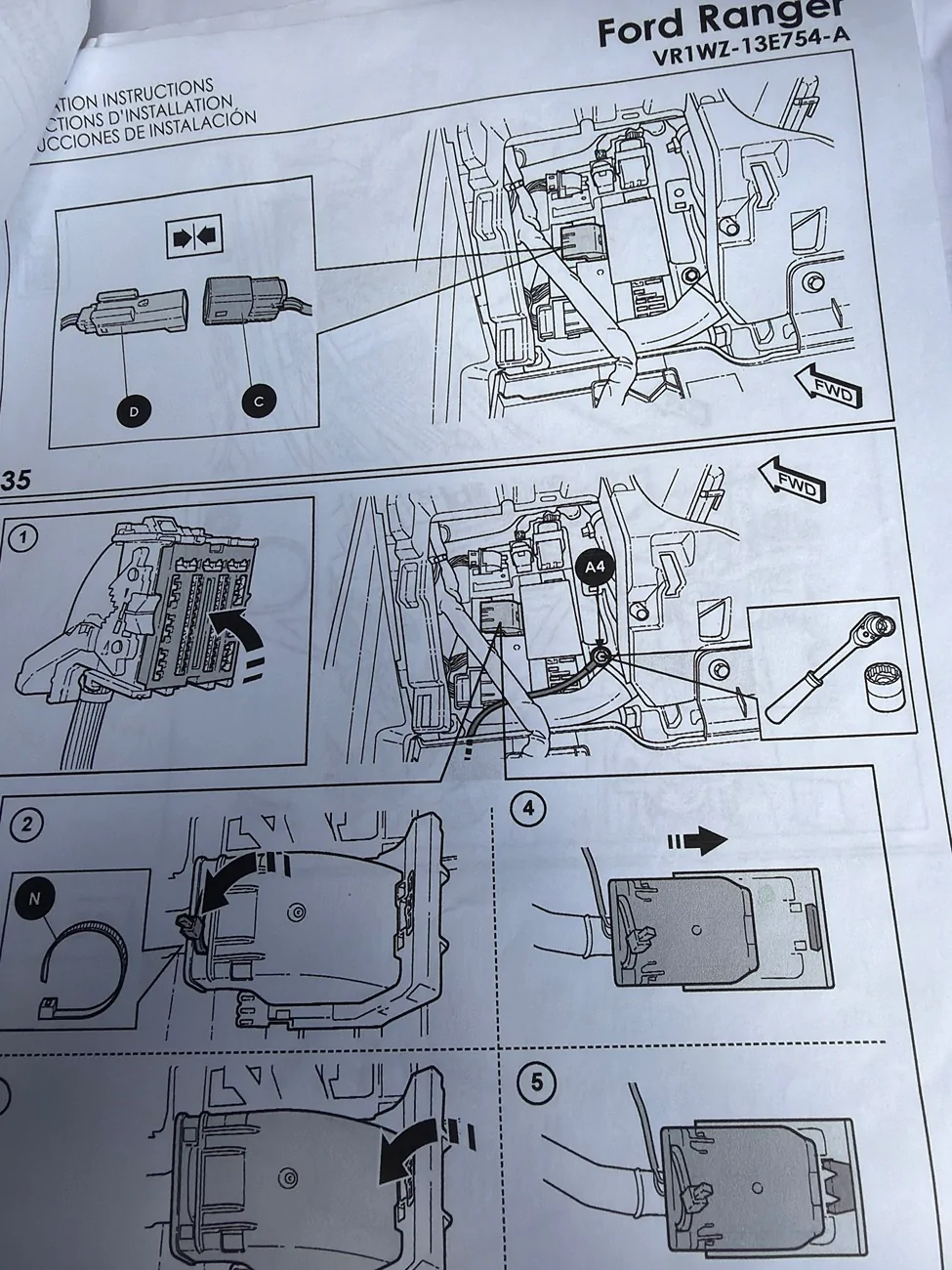

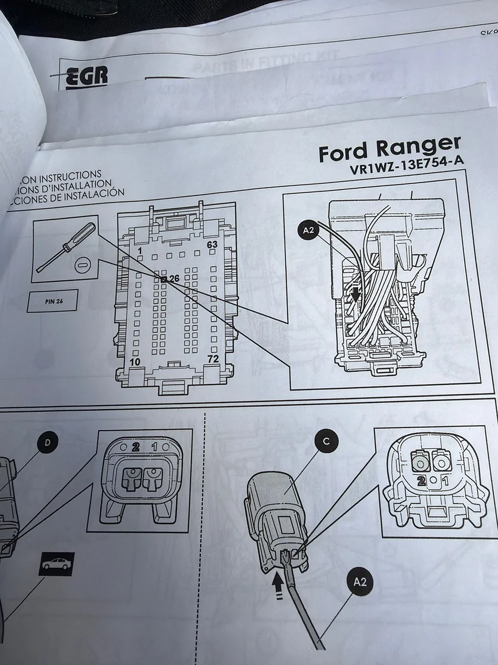

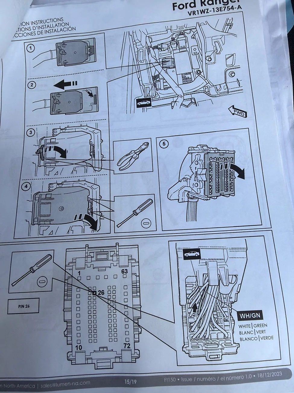

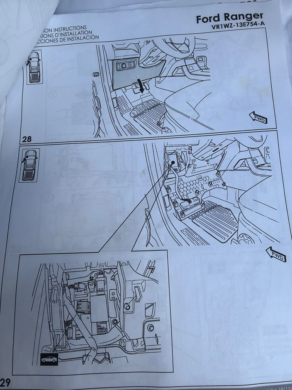

It’s this kit

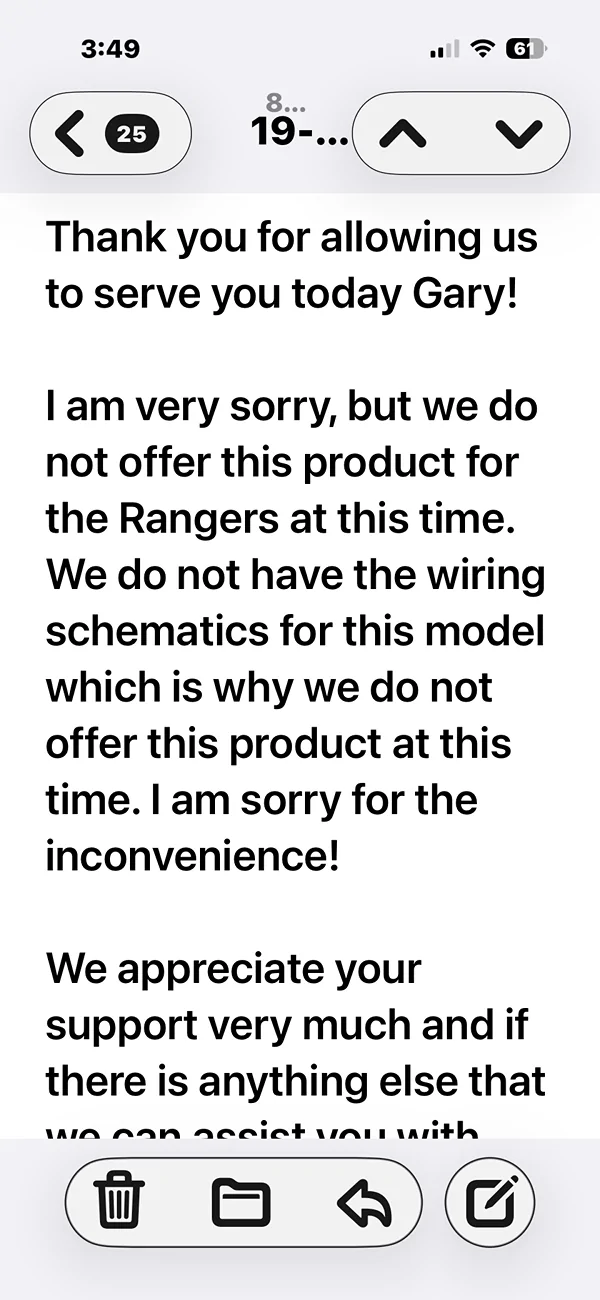

Just checked with F150leds customer service, they can’t say whether the 19-23 kit will work on a 6th generation. So if you would please photograph where you tap into the loom for the power and post it here.​
seems like when I was trying to do it and posted here, it was reported 5th & 6th generation were different.​

This is F150leds response

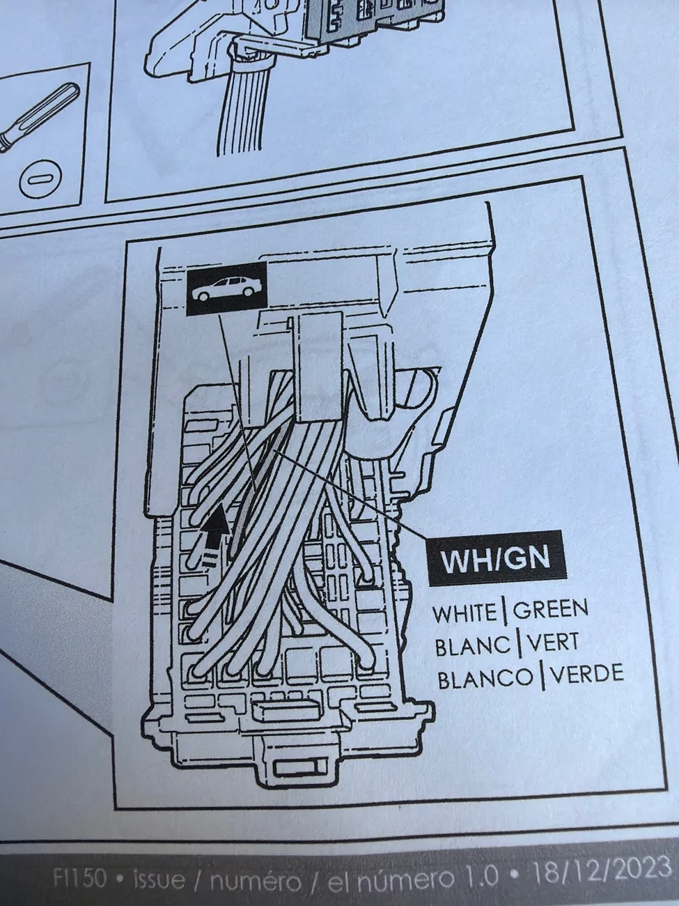

Hey there, all. Curious if this project was done. I installed LED running board lights on my last truck tied in to the interior dome lighting to work as puddle lights (also had them as running lights and turn signals), and I'd like to do this to my new truck as well.

I've seen many kits online that do what you want to do. Here's a link to just one: https://www.amazon.com/dp/B0BSF4N2G...C9T7BMLPK&ref_=list_c_wl_lv_ov_lig_dp_it&th=1
I only want the puddle lights and not the running/turn signal lights. I just need to find that white/grn stripe wire running to the back.

Thanks, Paul. I have the same kit as I had on my last truck, just looking to connect to an interior light without having to run wire all the way to the cargo light again.

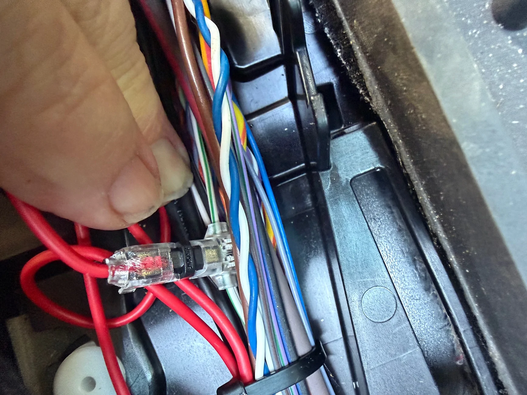

Brian:
There is a white with green stripe wire in the bundle that runs through the passenger side under the trim between the seat and the door. I tried hooking my bed lights to it. There was power, but the lights were very dim. My friend who does auto electronics suggested it could be enough to trigger a relay. But I put a remote in my system and never pursued the relay idea. I did leave the red + wire in case I changed my mind.
