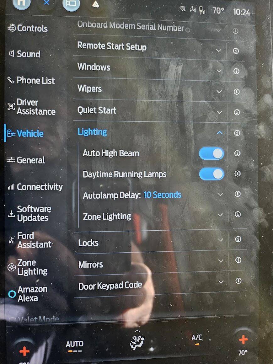

I would like this, however - I cannot find the setting. According to the 'Owners Manual':
Switching Welcome Lighting On and Off
Welcome lighting slowly turns on the exterior lamps when you approach your vehicle with an authenticated device or unlock the doors.
  1. Ford Ranger Key fob approach lights {filename}
    Press the button on the touchscreen.
  1. Press Vehicle.
  1. Press Lighting.
  1. Switch Welcome Lighting on or off
Here is a screen shot of my 'Lighting' settings. There is no "Welcome Lighting" Option:
Ford Ranger Key fob approach lights 1730471273947-n4
  1. Ford Ranger Key fob approach lights 1730471273947-n4
  2. Press Vehicle.
  3. Press Lighting.
  4. Switch Welcome Lighting on or off

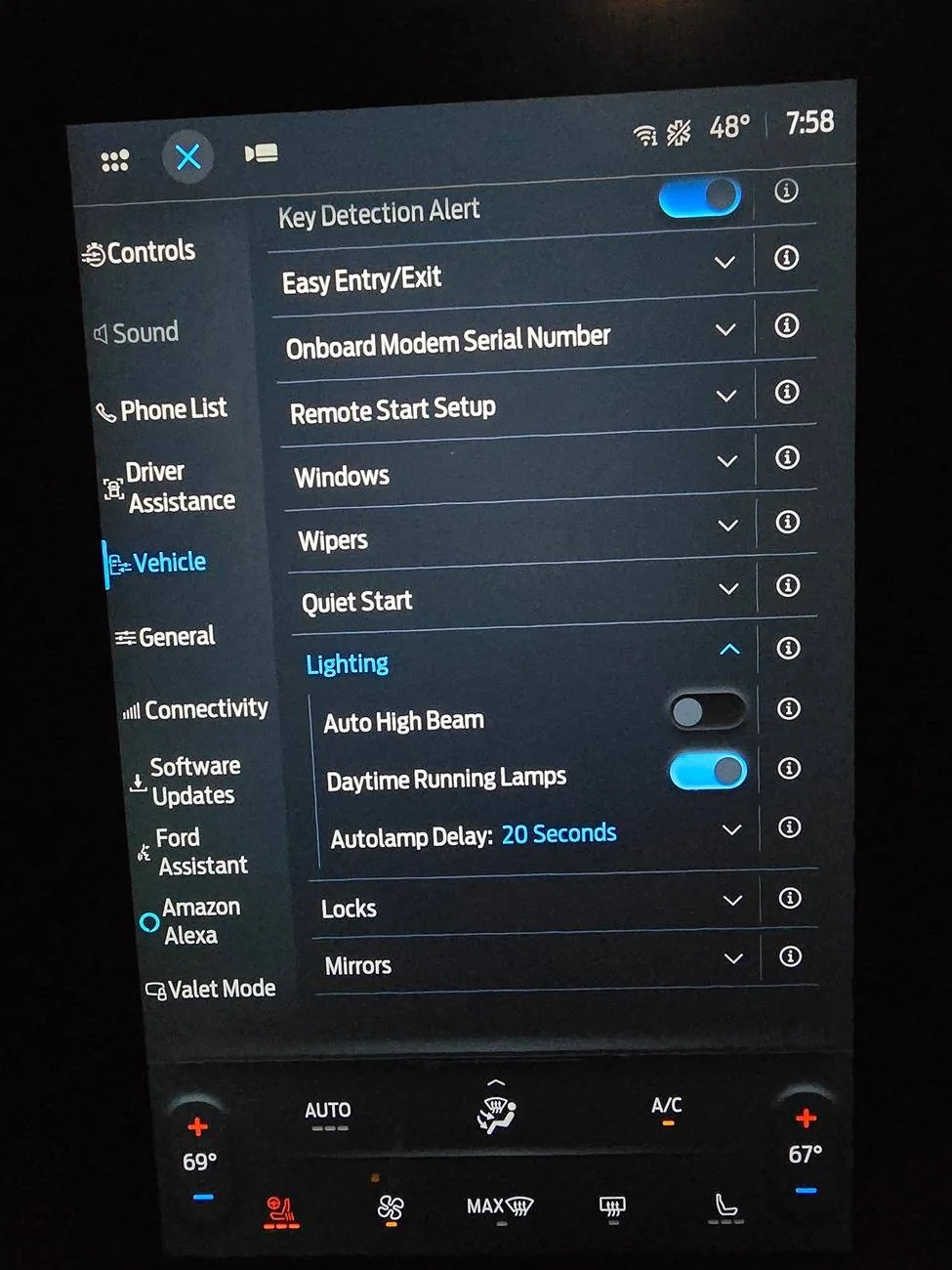

Yeah my display doesn’t have the zone light setting like yours. Did you try opening zone lighting to see what options it gives you ? And you said you have a Ranger Raptor as well, correct ?
Ford Ranger Key fob approach lights 20241101_195731

Look at your zone light settings.???
I just found my zone light setting. Funny, my wife's RR has things in different spots than mine, on the screen, and both are updated software ?. Anyways there is no setting on mine for approach lighting.
Yes Raptor and No, no 'Approch' settings in there.

So just want to confirm if we want to activate approach lighting we have to change all 3 of these settings?
Ford Ranger Key fob approach lights 1731092352085-y9
