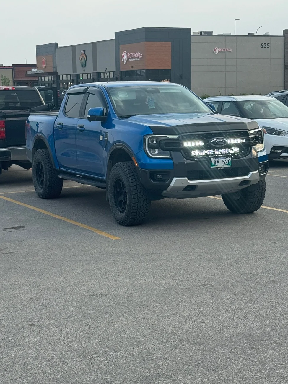

How did you mount it (I haven't even found any specific mounts/brackets for BD light bars to go with the ranger raptor)? Do you think a 30 would fit?
Also, did you think about putting it behind the grille?
A 30 would fit if you mounted the same way I did but in either case I made a custom bracket to suit. Neither would fit behind the grill because the BD lights have such large heats sinks on them and as it was I had to “tweak” a few plastic parts to make them fit.
They work amazing and no loss of light behind the grill. The 20 matches with the spread of the ditch lights to give an amazing amount of coverage.

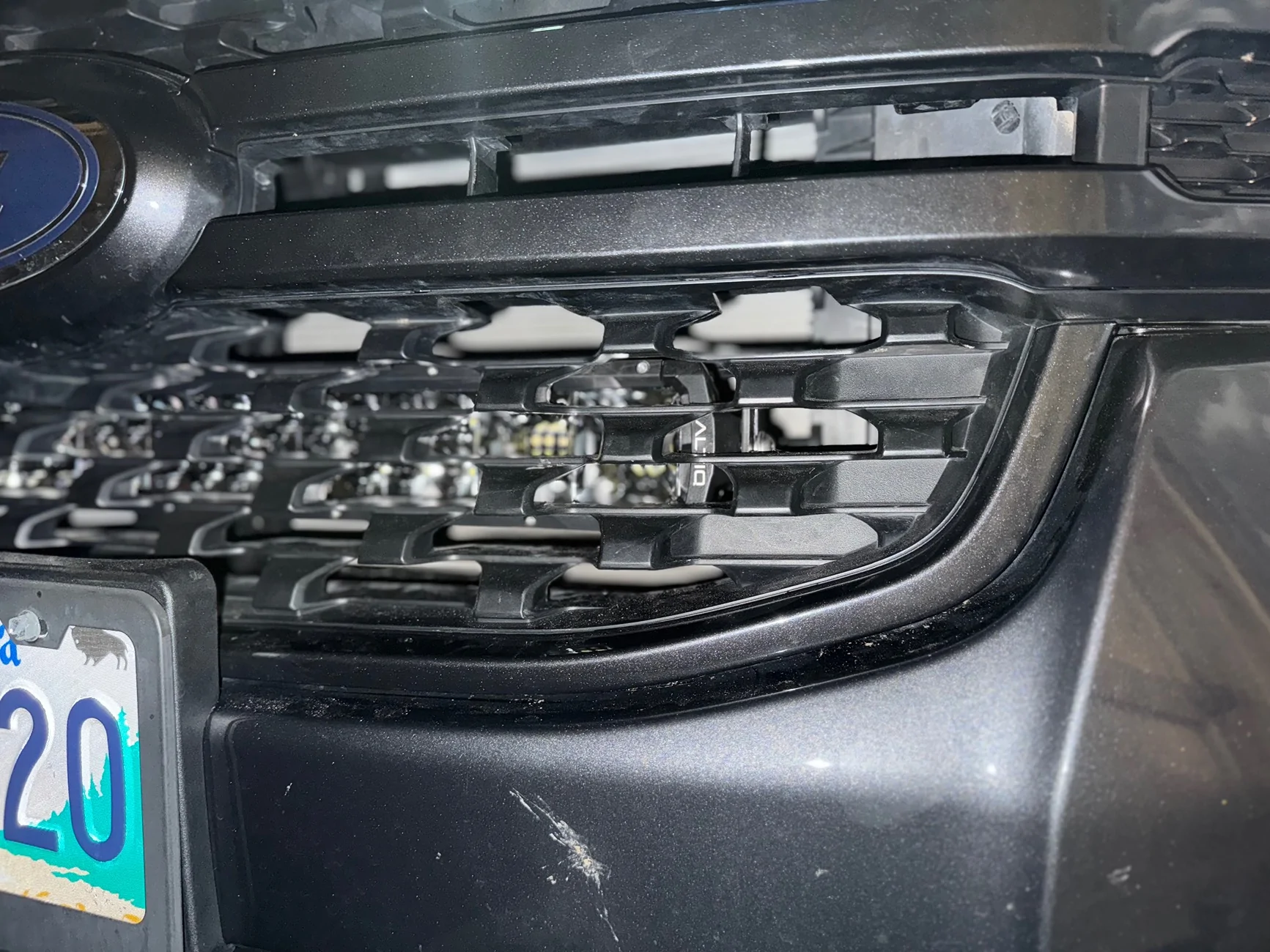

Ah OK. Thanks. Any closer pictures of the brackets or how they're held into the grill (assuming the grill itself and not any structure under the lights or behind the grill)?
I'm actually thinking of putting the BD 30" S8 behind the grill since:
1. Another member mentioned they fit behind the grille unlike the onX
2. They have an Amber DRL feature even if they're a little less bright than the onX
3. If I had the choice, I'd want to keep it looking more stock with behind-grille lights

This install video for the Altiq Light Bar gives you a good idea of the area to work with and mounting points available.

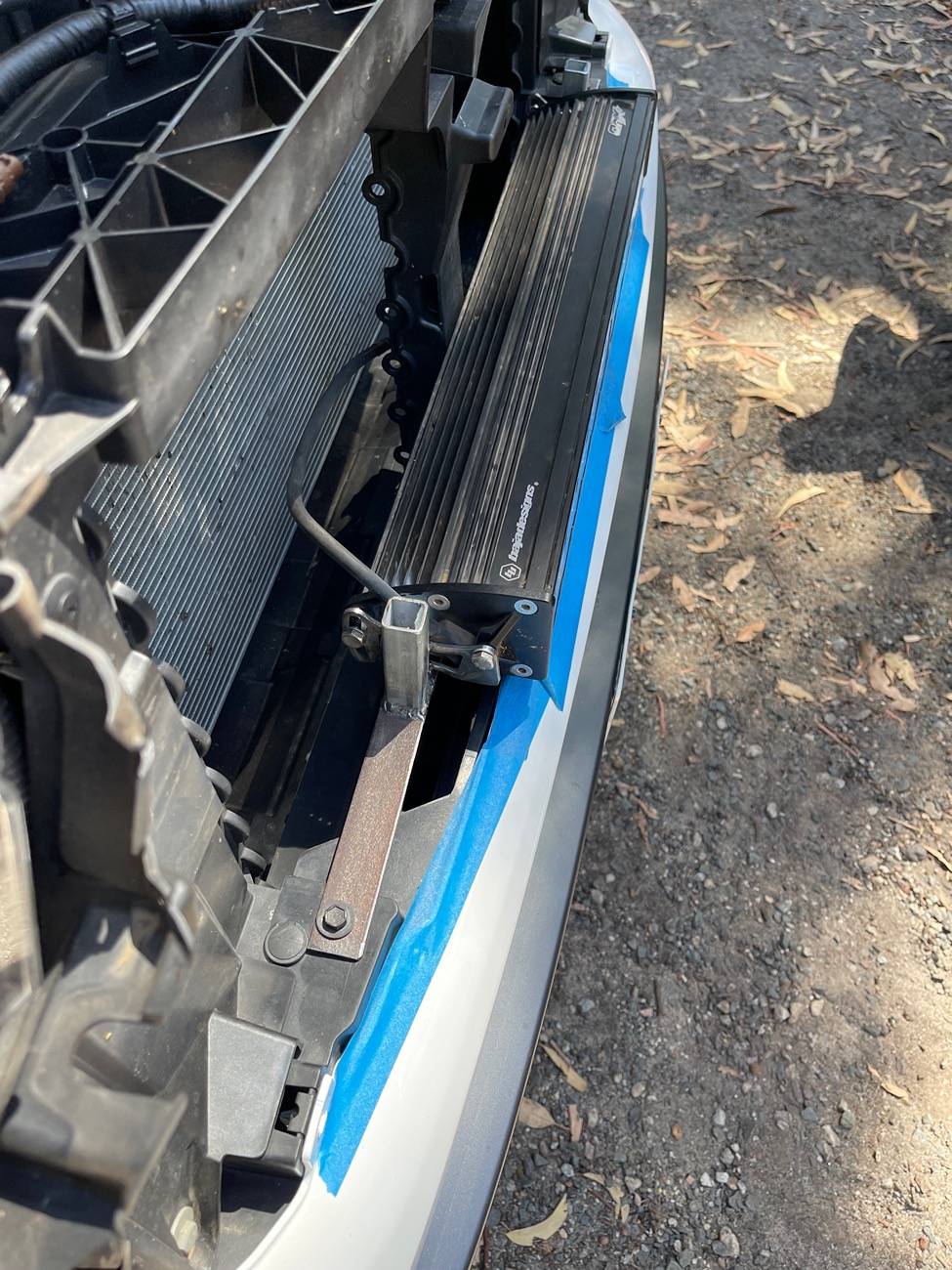

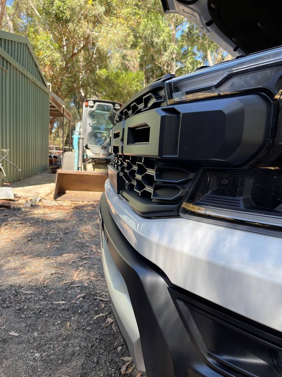

Here it is,
obviously cutting of the grill was necessary, but that was easy.
You can see how deep the Onyx is. Performance wise I’ve had BD lights for over 10 years now and definitely wouldn’t choose anything else.
