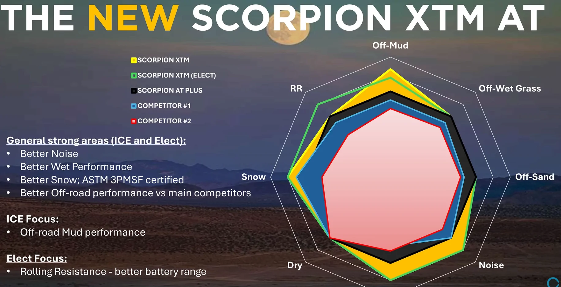

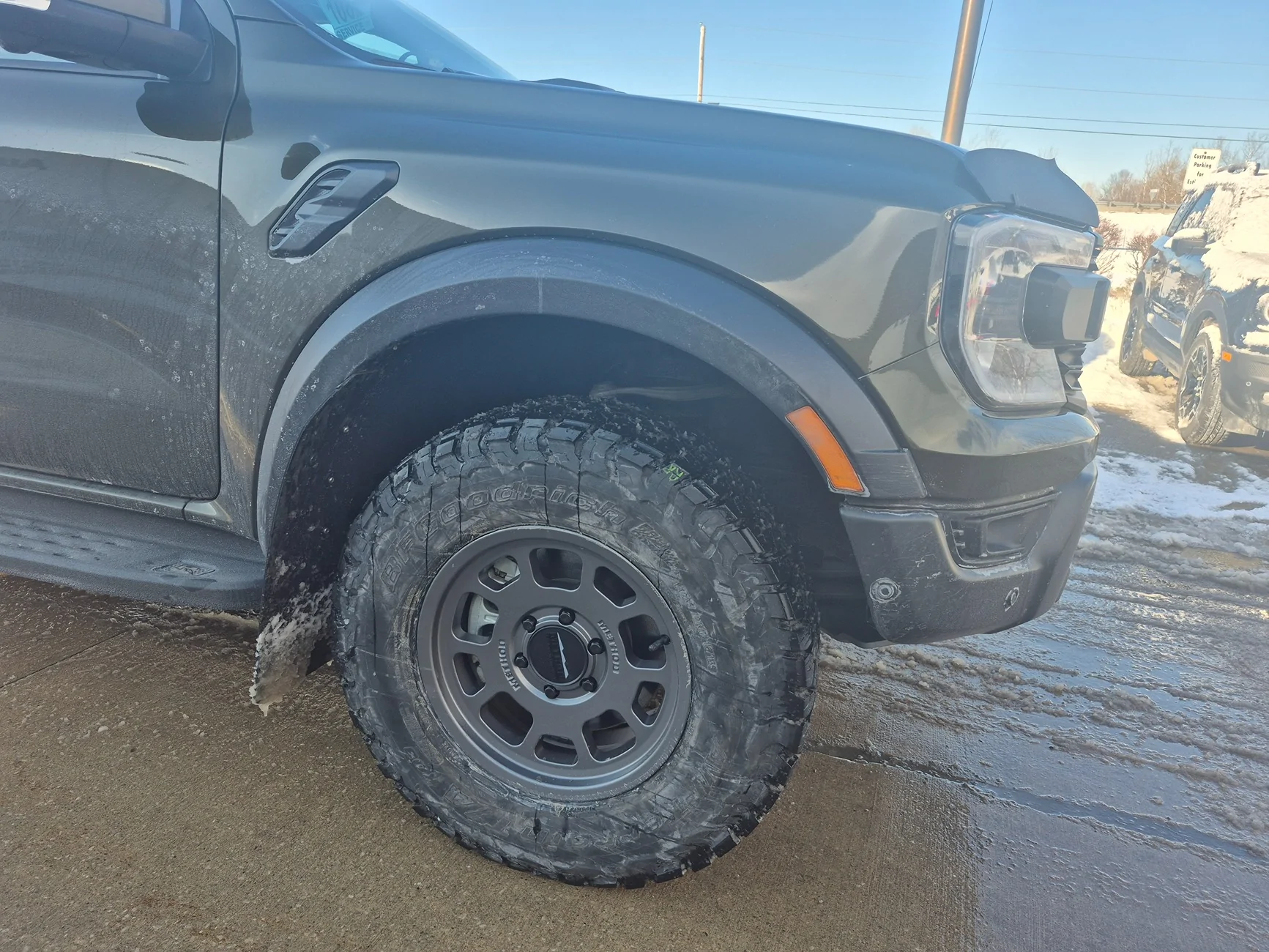

XTM's in 285/70R17 are 53 lbs per tire vs. the OE Ford spec. BFG KO3 at 56 lbs per tire. So, your dropping 12 lbs in tire and another ~ 12 lbs in wheel mass.
I came over from Ford Beadlocks, which were insanely heavy at 36 lbs per wheel! So, stock setup with OE beadlocks = 56 lb tire + 36 lb wheel = 92 lbs.
My final set up will be Method 705s + Pirelli XTM = 53 lb tire + 25.2 lb wheel = 78.2 lbs.

I think the Method 705 + Pirelli XTM AT 285/70R17 is the perfect combination for Road / Rally Truck. It's not a "big tire rock crawling" setup, it is more of a high performane race truck setup tailored for higher speeds and better handling, braking and acceleration. It enhances steering precision and also performance on a prepped track, dirt roads, gravel roads, sand dunes etc. anywhere that is high speed.

5. Method 705's in 17x8.5 ET+35mm @ 25.2lbs per wheel
6. Pirelli XTM AT 285/70R17's (lighter than KO3's, same off-road traction, better steering and less weight, once my KO3's are worn out, I will switch over).

Also, the Pirelli XTM AT's have 1" wider tread, so makes them look bigger than OE KO3's (9.7" vs 8.8" tread width), all without actually going to bigger / heavier tire. I get why factory size is 33", good balance between performance vs. clearance, much lighter than larger tires and the Ranger is a Rally truck, NOT a rock crawler. It is the ONLY truck with a Watts Link and the only mid-size truck with 405 hp stock, 455 hp with Pro Cal.
