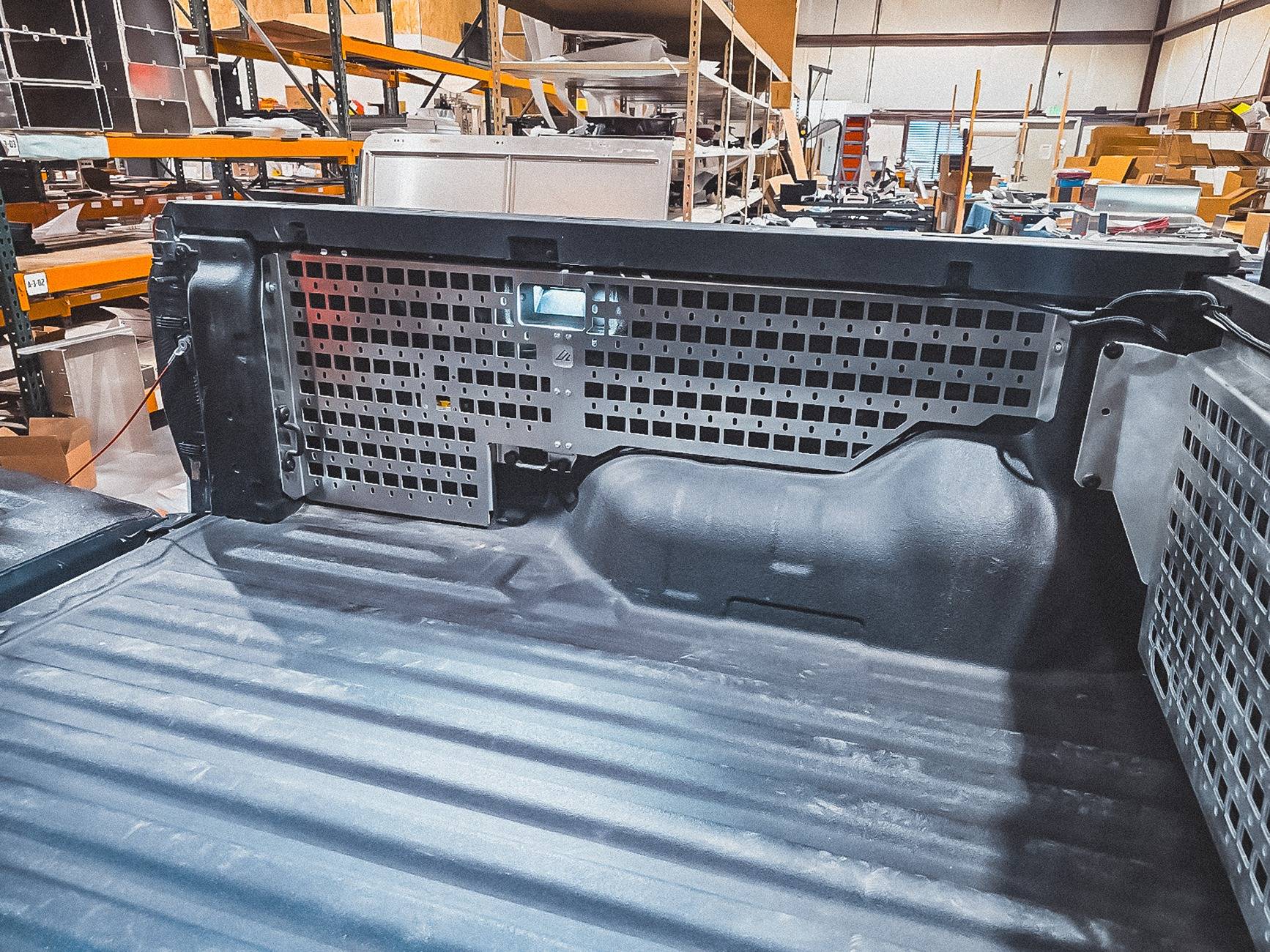

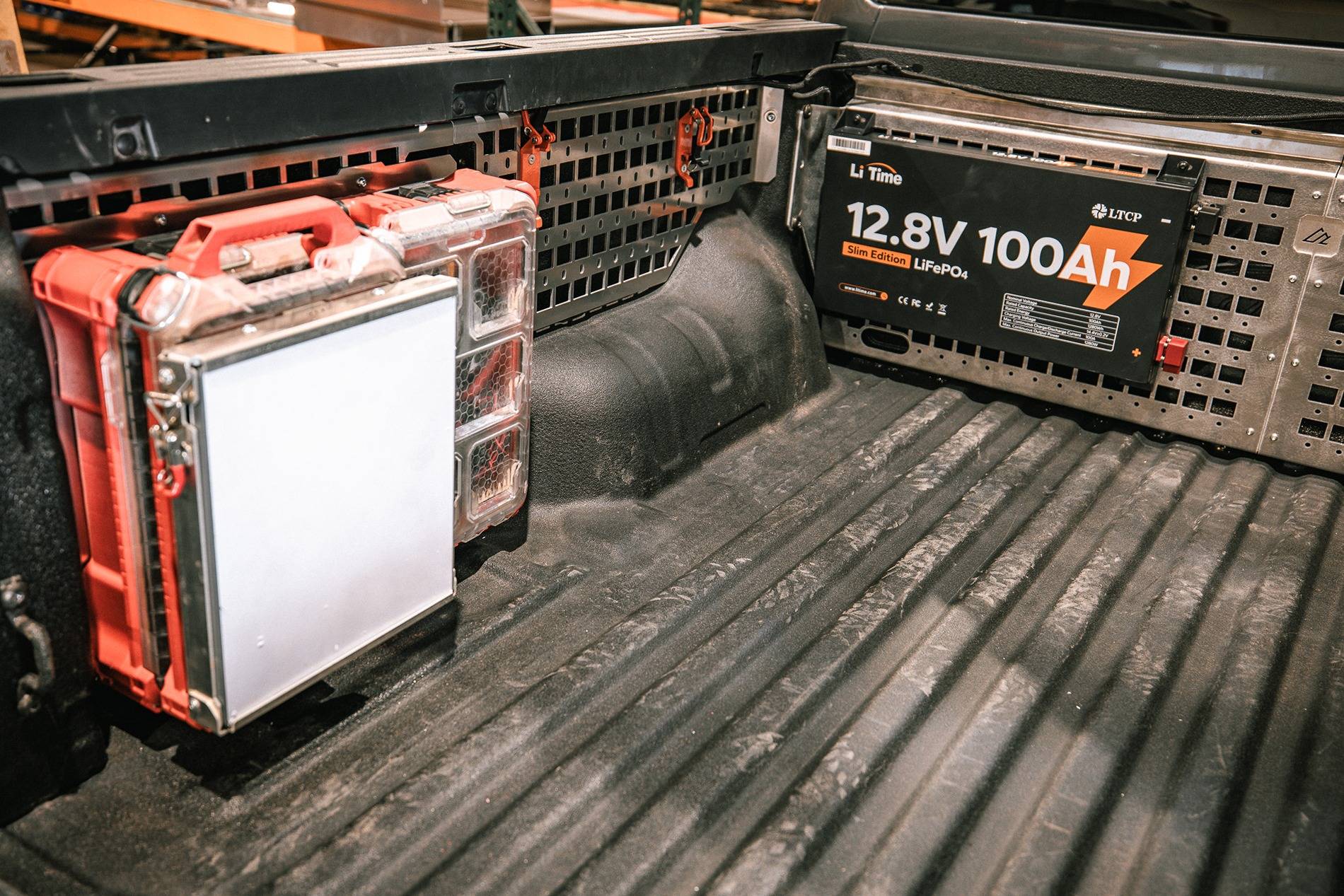

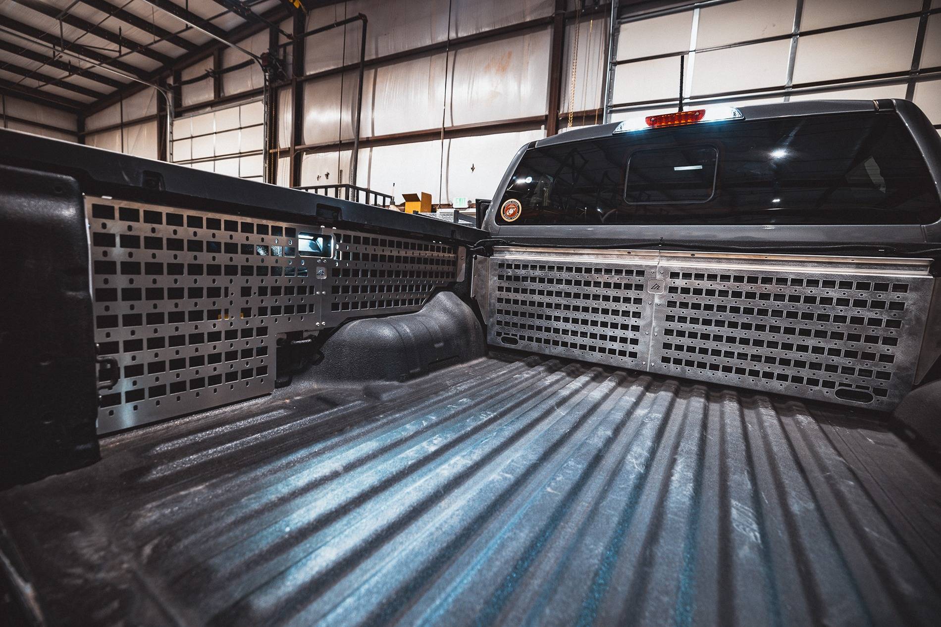

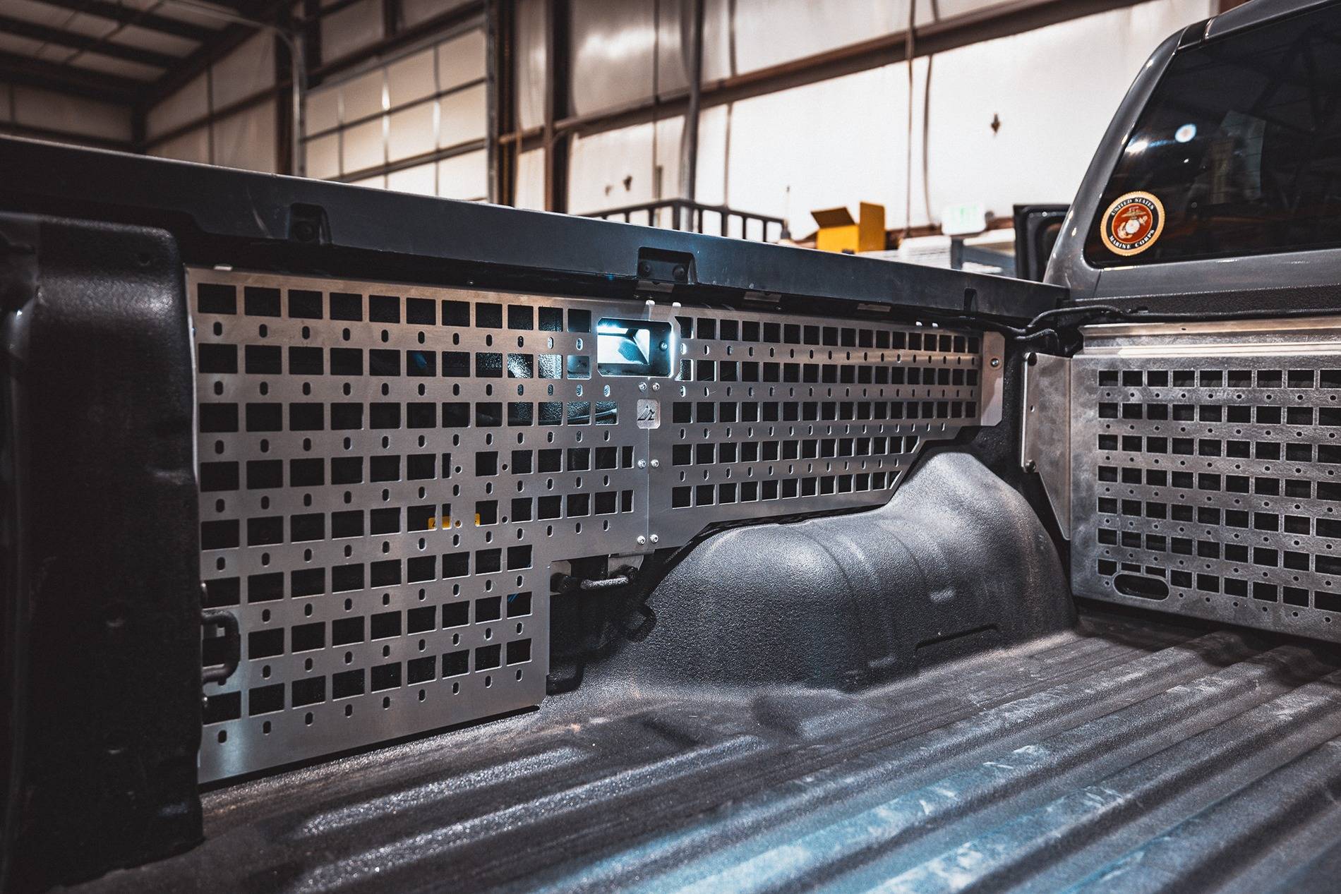

Today's progress! We will have several different "rear panel" versions (driver and passenger variants) for: full MOLLE (as pictured) and Rotopax Deluxe Mount holes pre-cut, Milwaukee Packout, Power Panel access (driver's side), air/up down panel (passenger side only).
The small vertical slots are spaced to work with our Multi-Tool Clamps - https://americanadventurelab.com/product/heavy-duty-multi-tool-clamps/
These can be used in front-only or rear-only panels, but you would see half of the connector bracket in the middle. They will only be sold as a full set (full driver's side and/or full passenger side).

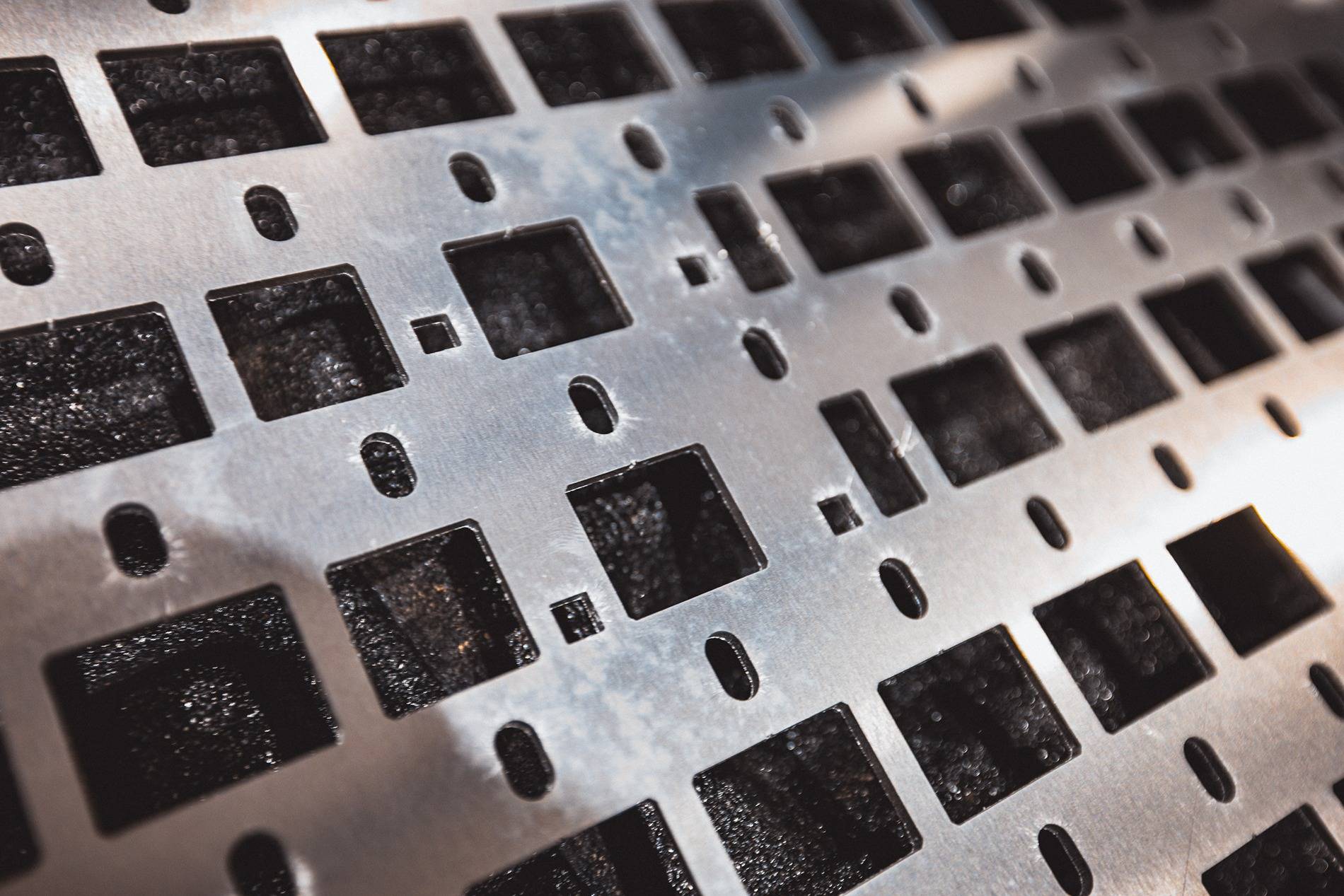

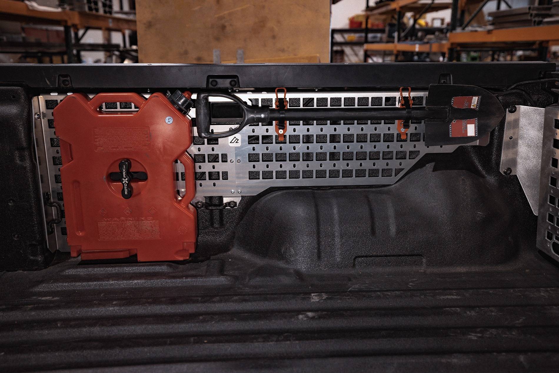

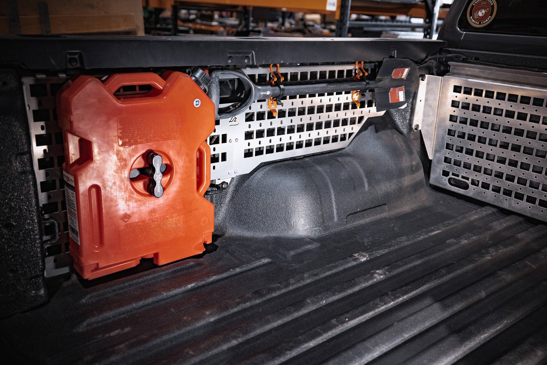

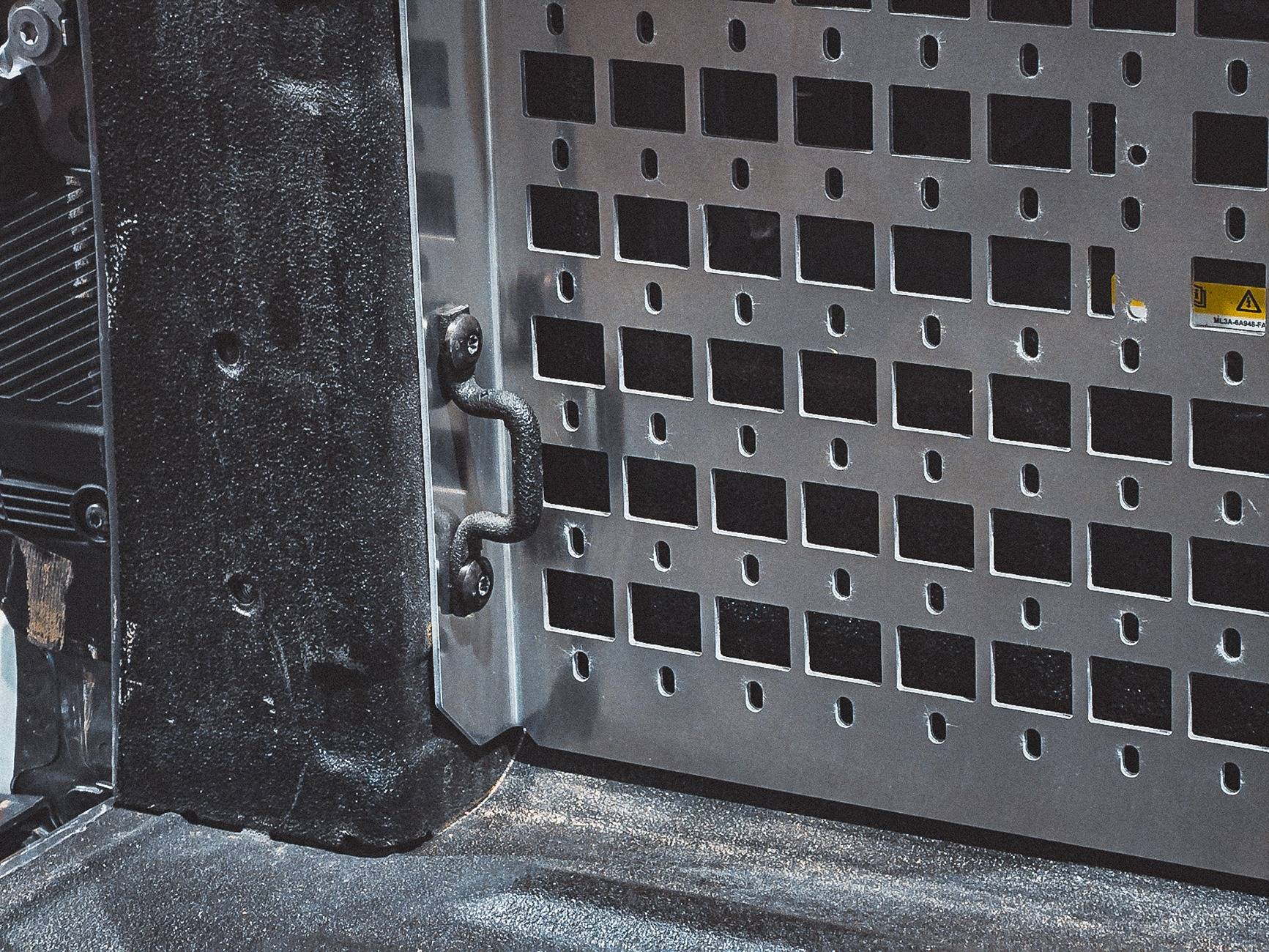

The MOLLE/Rotopax rear panel is good to go! The square holes in the MOLLE pattern (last photo) are for the carriage bolts for the Rotopax mount. That easily locates it in the middle of the two tie down points and provides extra material to support the fasteners for the mount.
The 2 gallon Rotopax can fits perfectly tucked into the bed side.
Next up: Power Panel access for the driver's side. Then, Milwaukee Packout.

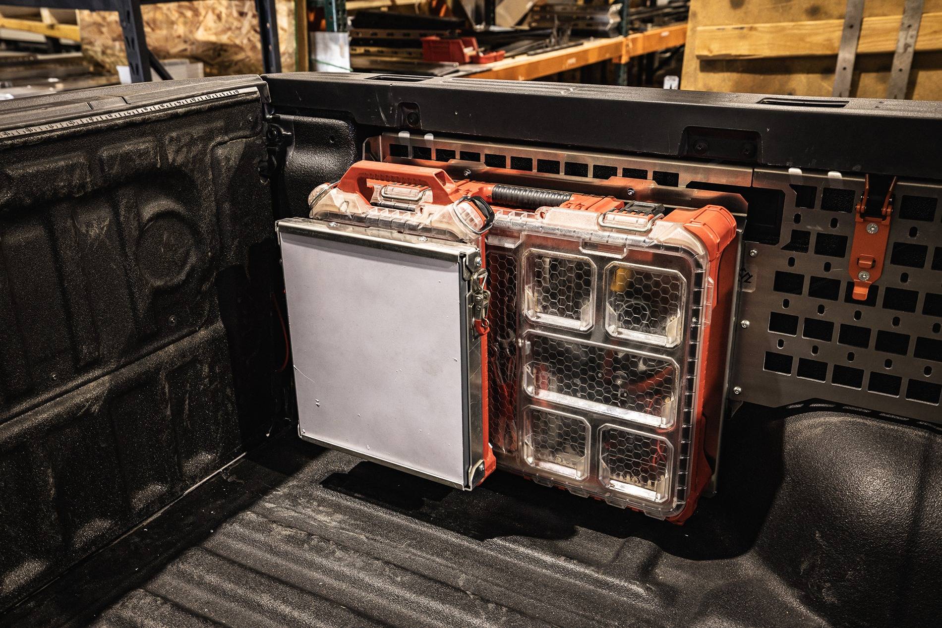

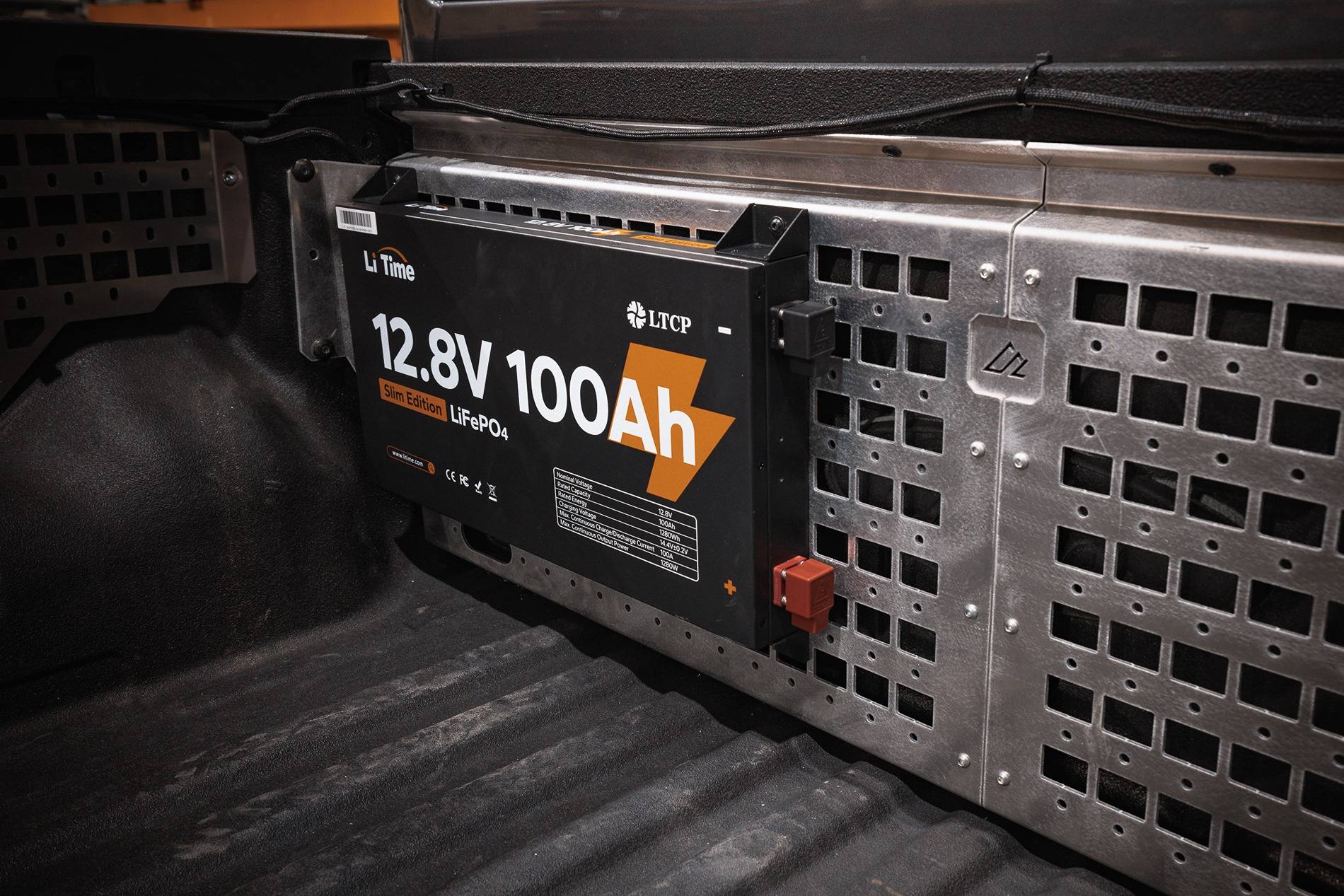

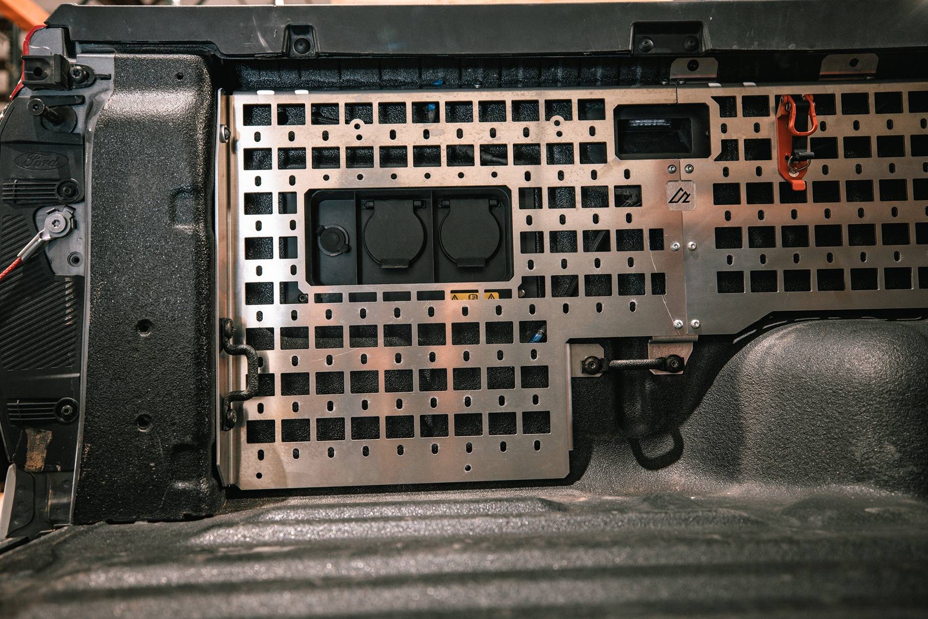

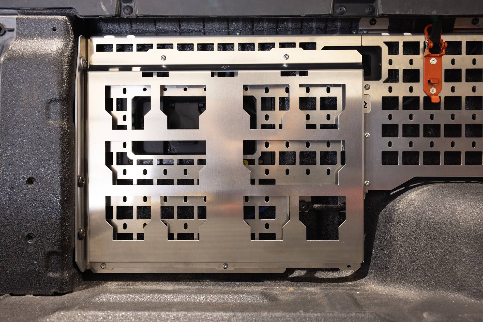

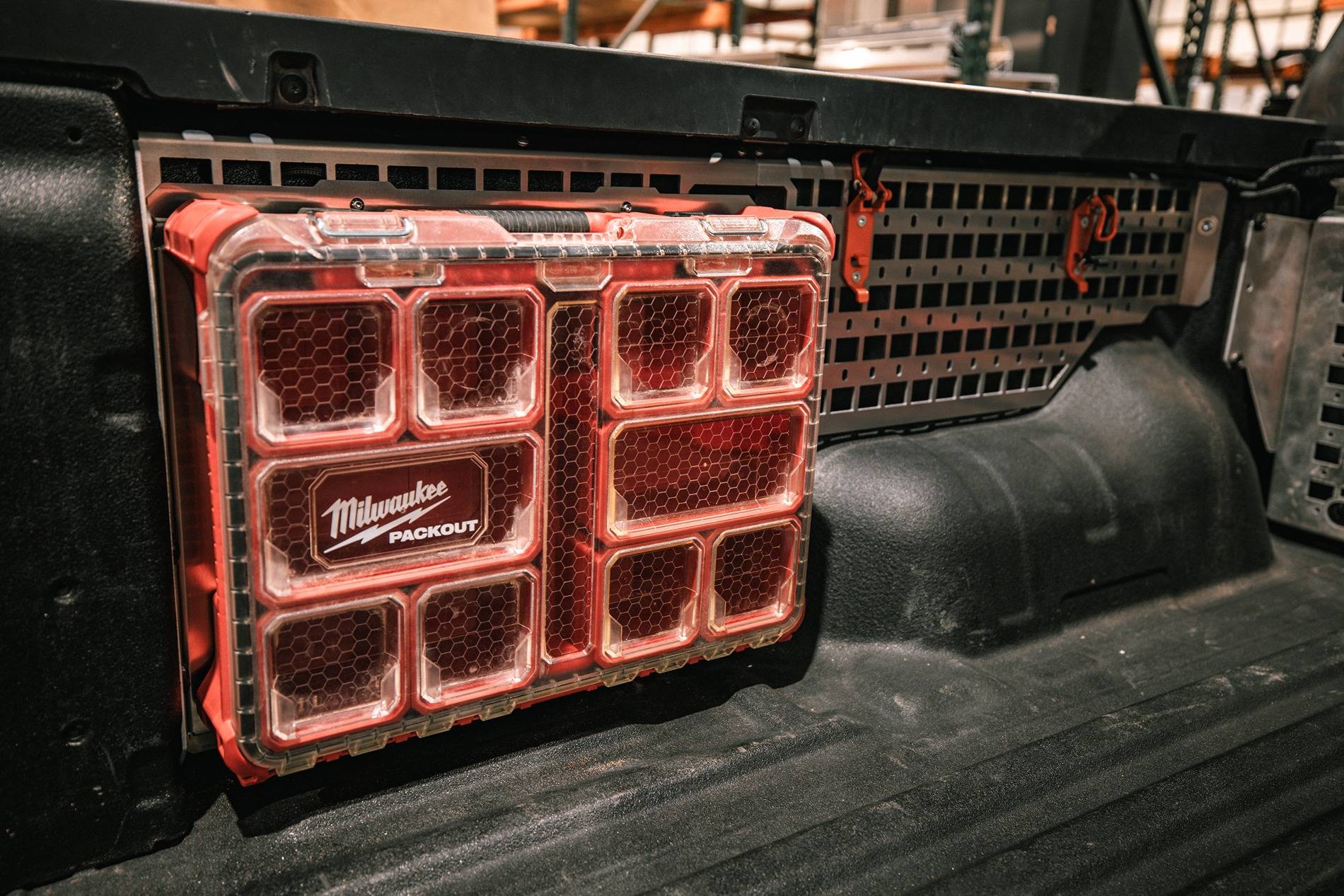

Packout adapter and Power Panel Access. The Packout Adapter pattern will be in all of the rear panels. I thought I would be able to cut that pattern into a rear panel, but it cut into the mounting flanges too much. This will work well.
