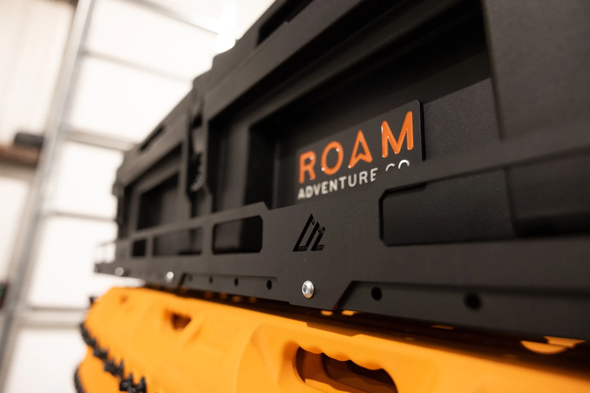

The "textured black" is powder coat. I highly suggest the Mil-Spec coating for the seat deletes. It's considerably more durable, scuff resistant, and non-slip. All of the black photos and videos on the product page are the Mil-Spec coating. It's polyurea similar to Line-X and applied hot.
https://milspecliner.com/
Here's what the powder coat looks like (on a different product). We have sold several with this coating, but if you don't mind an extra few dollars, the Mil-Spec is highly worth it.

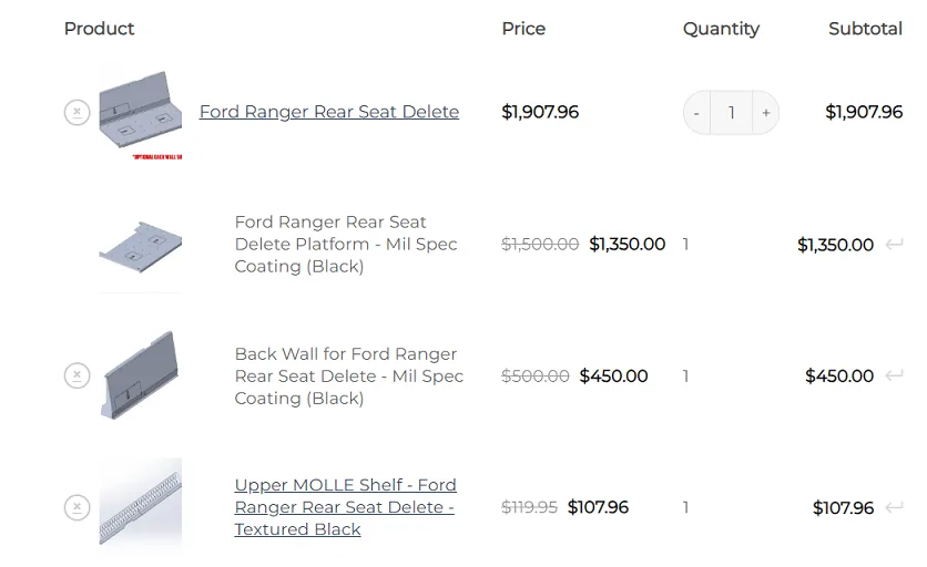

Curious if there is any sort of Coupon codes for Forum members to get any sort of discounts?
This is the order I am looking at.
Curious on the upper rack attachment didn't offer the Mil spec coating.

Everything in your cart is already on sale for Black Friday. Retail is the marked out price you see in the cart.

Sorry. Missed that part. The MOLLE pattern is very specific. If we did Mil-Spec on that, it may not fit with some MOLLE accessories. It sprays at about 1.5mm thick sometimes.
