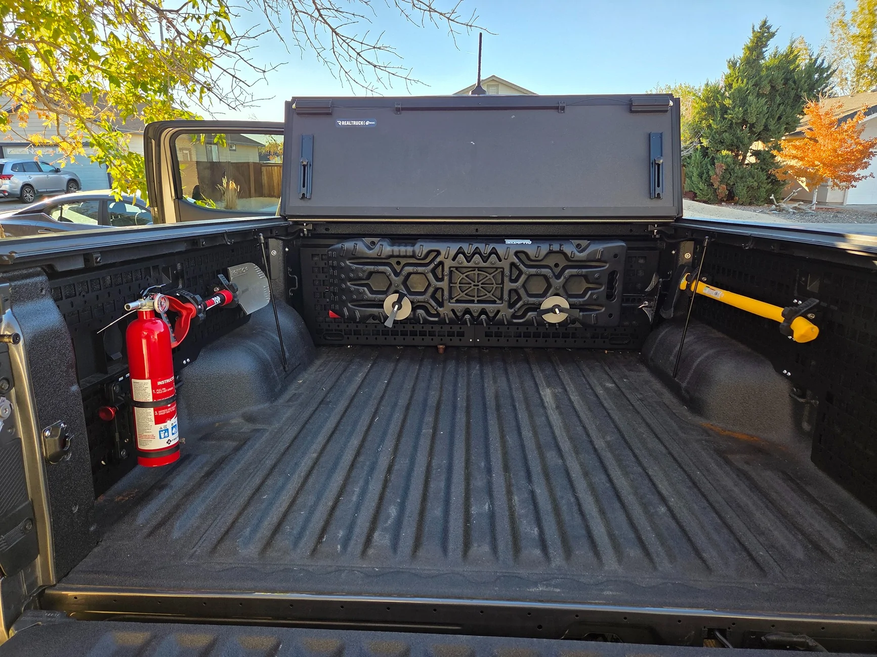

Wrapped up some weekend mods on the 2025 Ford Ranger Lariat FX4 — installed bed Molle panels and mounted all the essentials: farmer jack, recovery boards, shovel, axe, and fire extinguisher. Every tool has its spot. Next stop: the dirt.

How did u attach it to the bulkhead
I used Overland AXIS Truck Bed Rack Mounting Boards are on top of the farmer jack. I also had to drill out the molle panel holes to 3/8 to attach the brackets to the bulk head panel brackets. I still had replace the long carrier bolts that came with it with 8 inch full thread bolts because recovery boards are mounted in front of the jack. I'll be replacing the 8 inch bolts with 7 or 7 1/2 inch bolts. I'll leave a full parts list below this. Maybe you can refine it and make it better.

Thank you . I was looking at my bulkhead and dont see any mid or lower holes that i can install threaded rivets in and i am not sure where its safe to drill a hole and not pierce the outer skin . I have spray in bed liner installed.
I have factory spray in bedliner and enlarged four of the existing molle panel holes to accommodate the brackets. There is enough distance between the panel and the bulk head to not damage it while enlarging the holes. just take it slow.
