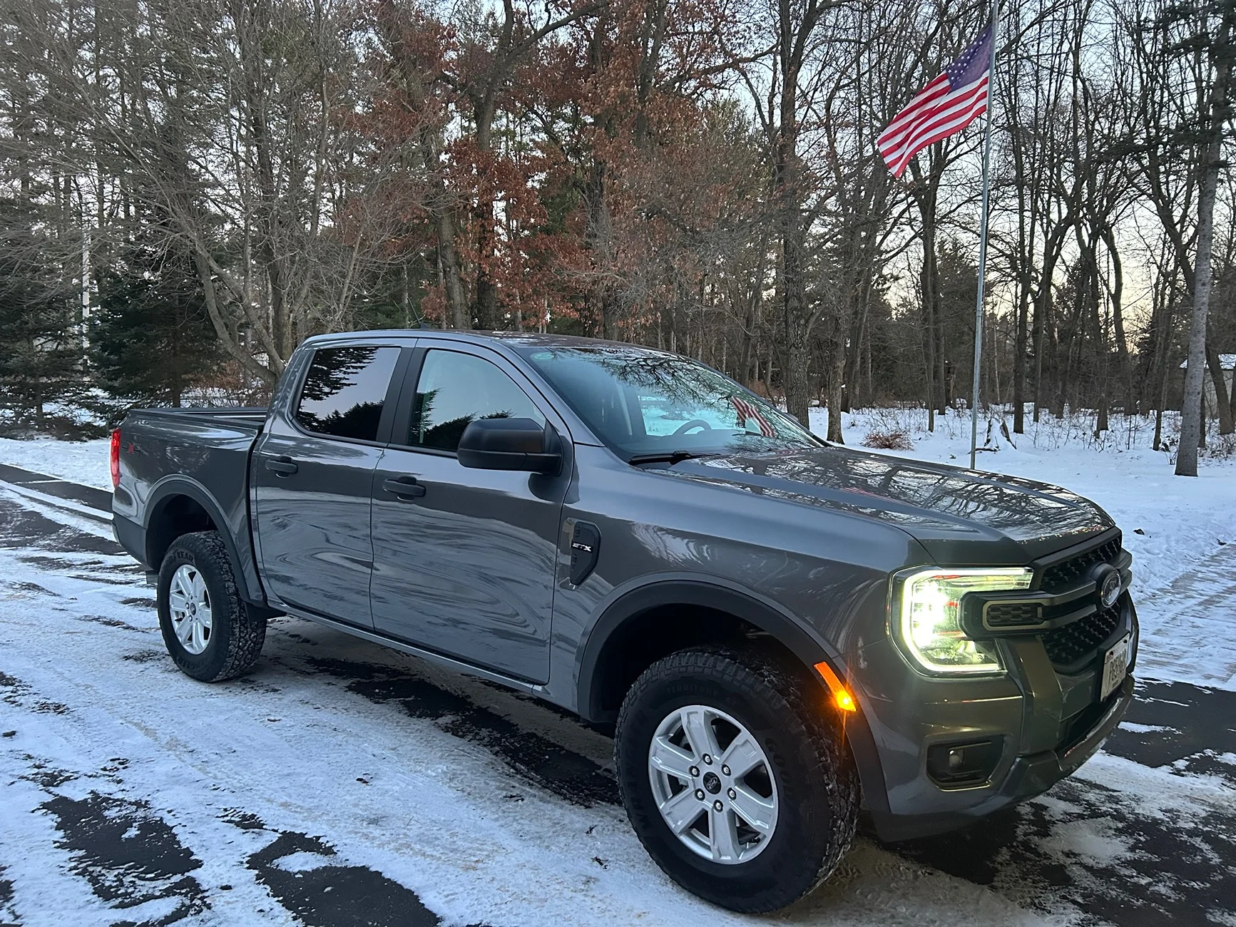

Having a possible issue with my 2025 Ranger.
I have a couple of 30 mph s curves right by my place. Slow down. Get through one corner accelerate and then slow down for the next and accelerate. The issue I’m having is when accelerating the steering wheel and truck vibrate very noticeably under light acceleration, but when I step on it just a little bit more it bangs down a gear and just jolts away. And when I say bang it a noticeable hard somewhat slam shift
is this something the dealer should look at? What do I tell them to look at if my one else has had a similar issue?
the vibration in the steering wheel is also noticeable at 55-62 mph cruising. I had my cruise set the other day at 61 and my hand started to go numb after a few miles of driving from holding the wheel. I know it sounds really really dumb….but I don’t know if there is a fix?
I really want to like this truck. But so far every time I hop in I just dread what new dumb thing it’s going to do next….
I try to absolutely baby this thing because I wanted to get 200,000 miles out of it. Always driven in normal mode truck has 3500 miles.
thank you to anyone with any ideas or input.
