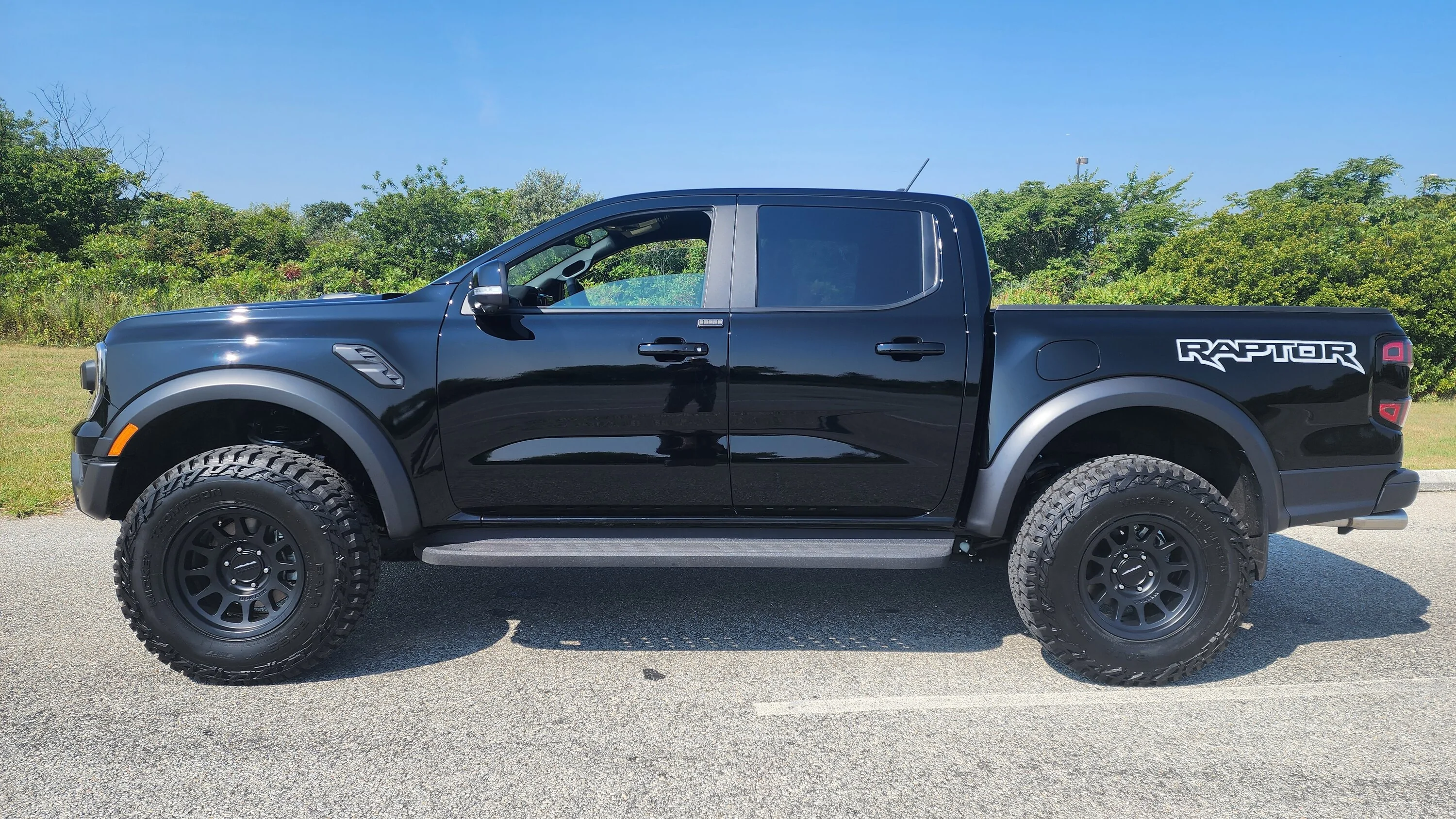

New Ranger Raptor owner, finally joining the conversation here. Took delivery of my Ranger Raptor in July from a dealer in Florida, couldn't find the spec I wanted locally.

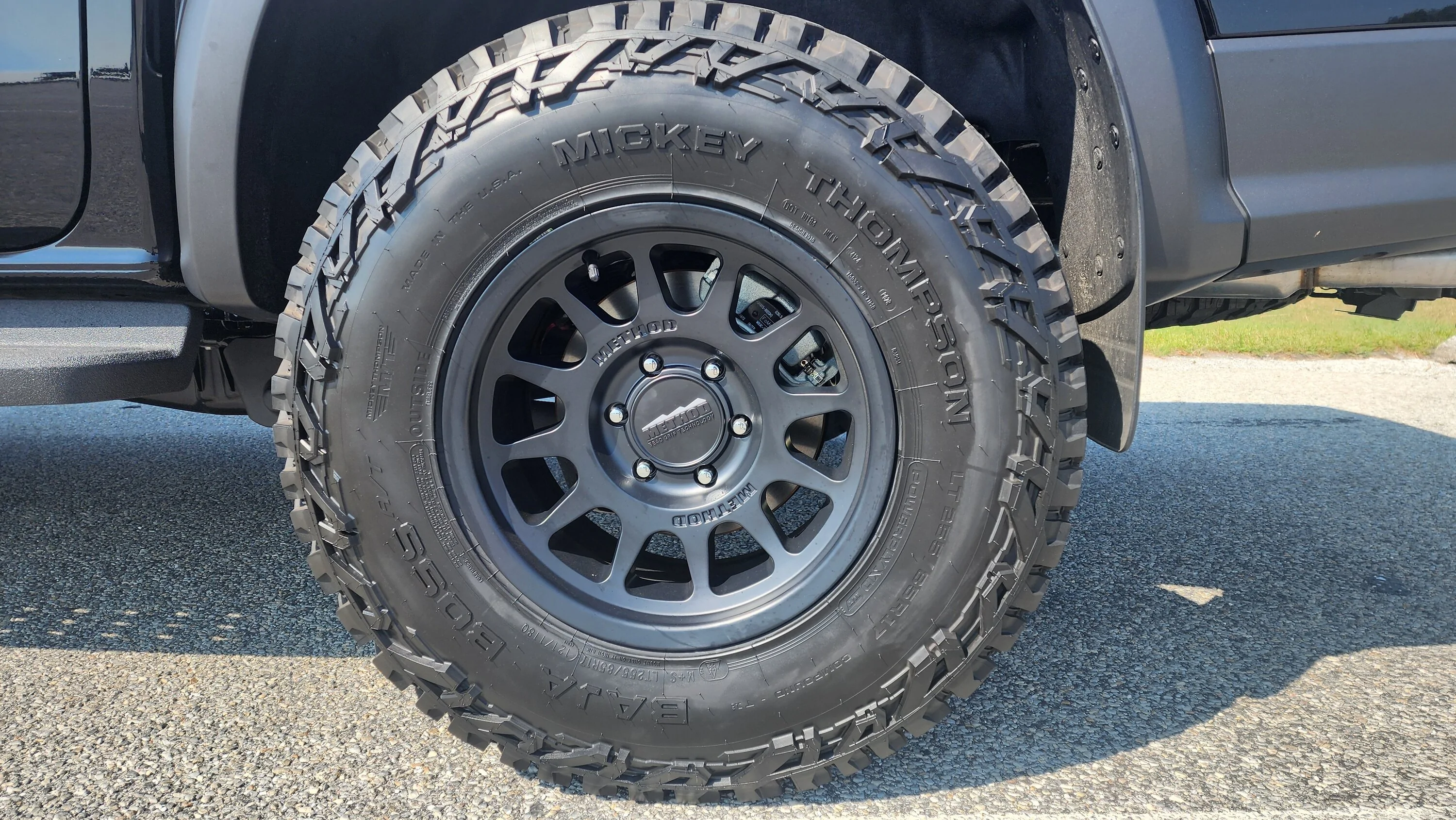

Already couldn't leave it stock, installed the FMI 2.5" leveling kit and swapped out the factory wheel setup for Method 703s 17s at zero offset with MT Baja Boss 255/85R17s [about 34.6" overall]. My local dealership adjusted the ride height after the leveling kit install but now I have a speedo issue as the dealer's telling me they can't adjust the computer settings to recalibrate for the larger tires, anyone else run into this and have a solution?

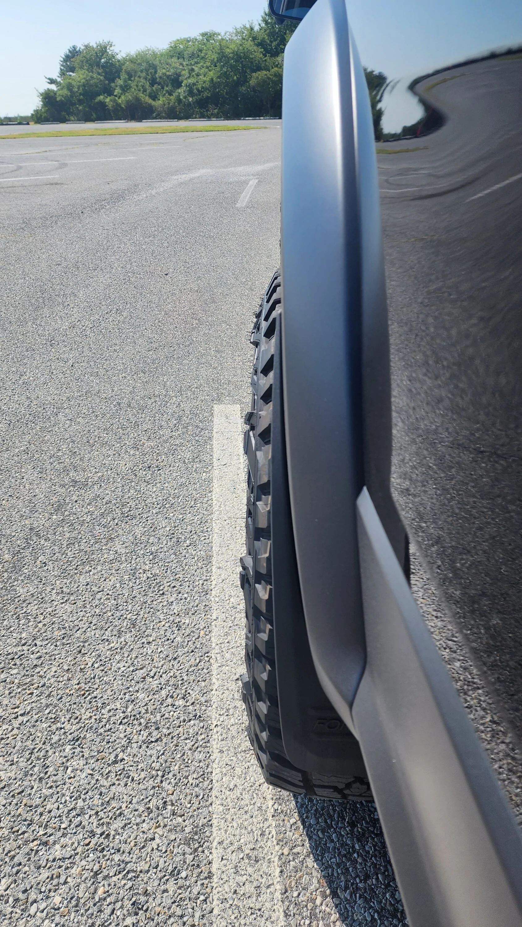

*Note for anyone considering this wheel/tire/leveling setup on their RR, I DO get tire contact on the crash bars at full lock. [This is with 3 sales reps telling me this setup would not rub]
