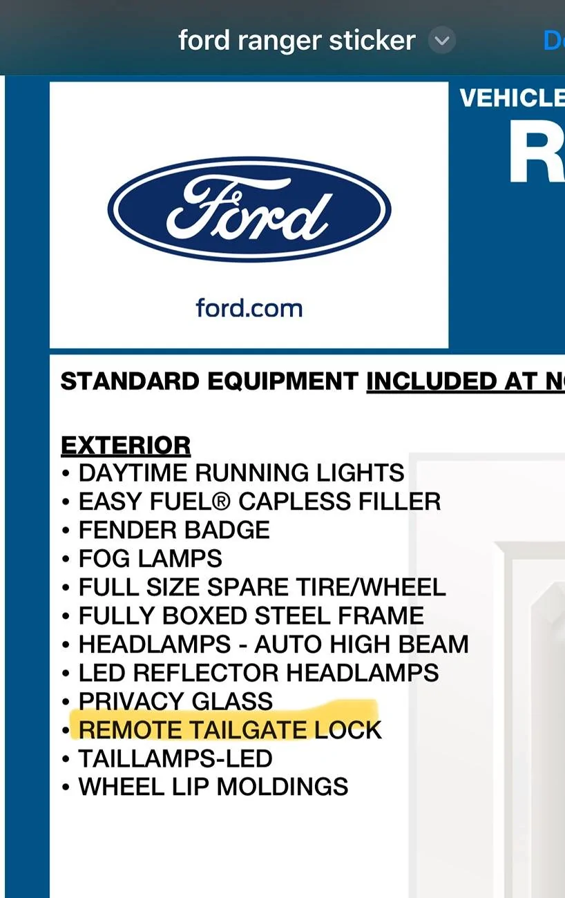

I did not get 301a, but it is listed under standard equipment on the sticker.
Ford Ranger New XLT and New to the forum IMG_3479

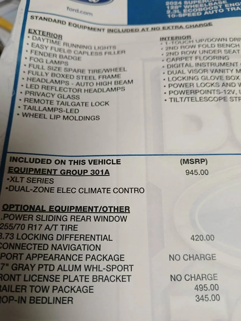

Ahh ha, my bad it shows on mine just wasn't looking well enough:blush:
Ford Ranger New XLT and New to the forum window sticker

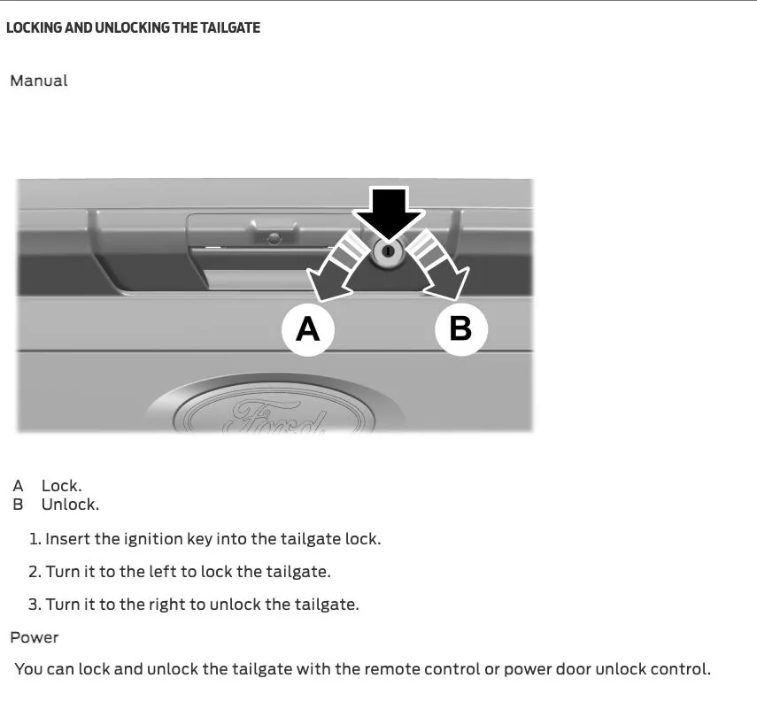

I haven't found anything on the console or in the manual. The manual mentions locking using the key fob and also has a section for manual locking tailgate, but that one has a key lock next to the handle on the tailgate which the truck doesn't have.
Ford Ranger New XLT and New to the forum 1730733587638-z9
