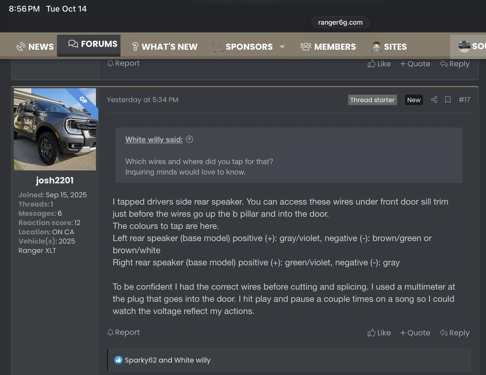

Saw this on previous post, don’t think you need to pull the dash to get a signal for the subwoofer. I plan on adding the Kicker Hideaway next month. replaced my door speakers awhile back so have the Crutchfield directions, let me know if want me to email them to you.
Ford Ranger Non B&O subwoofer T harness recommendations a dash removal tips? IMG_0293
