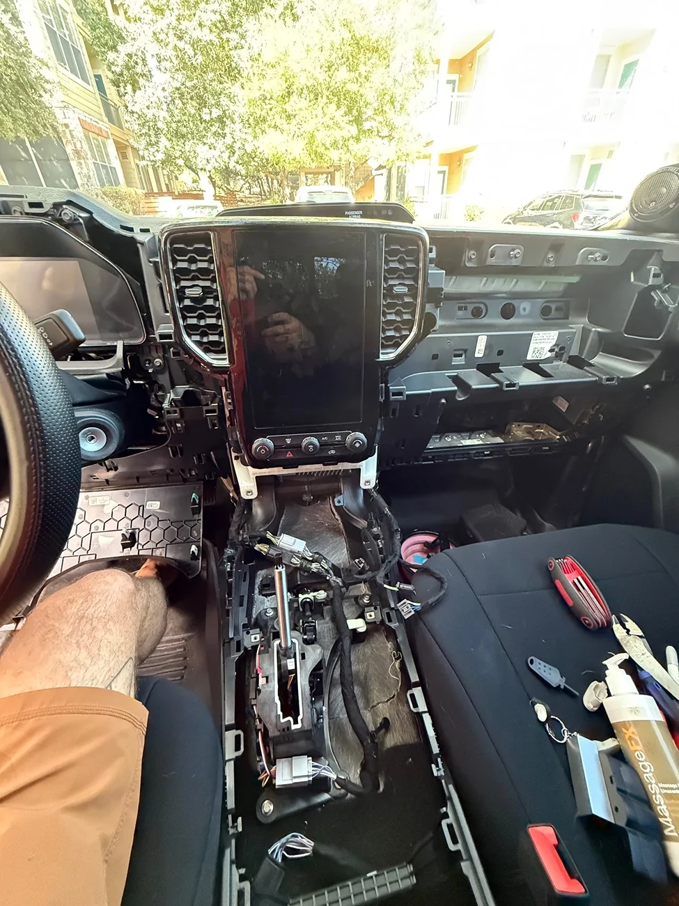

truck is a 2025 XLT with the 12" screen and base Radio.
im adding in a t harness to "easily" add in amplifiers. couldnt find the info on which harness to get for the rangers since most are for the maverick, bronco or F series and all had multiple options.
so if you are wanting to order a harness for a stereo install, i went ahead and tore down the dash to get the radio out and here are the plugs.
Ford Ranger ACM Plugs for T-Harness IMG_0462
Ford Ranger ACM Plugs for T-Harness IMG_0463
4,134
4,025
wow, those plugs are huge

Ford Ranger ACM Plugs for T-Harness IMG_0460
its a good bit of stuff to remove but not too bad, a few hidden 7mm bolts when the center console comes out. i only broke clips removing the passenger side dash cover ( the textured piece) that sucker was tight! but CA Glue will fix it for how it broke
