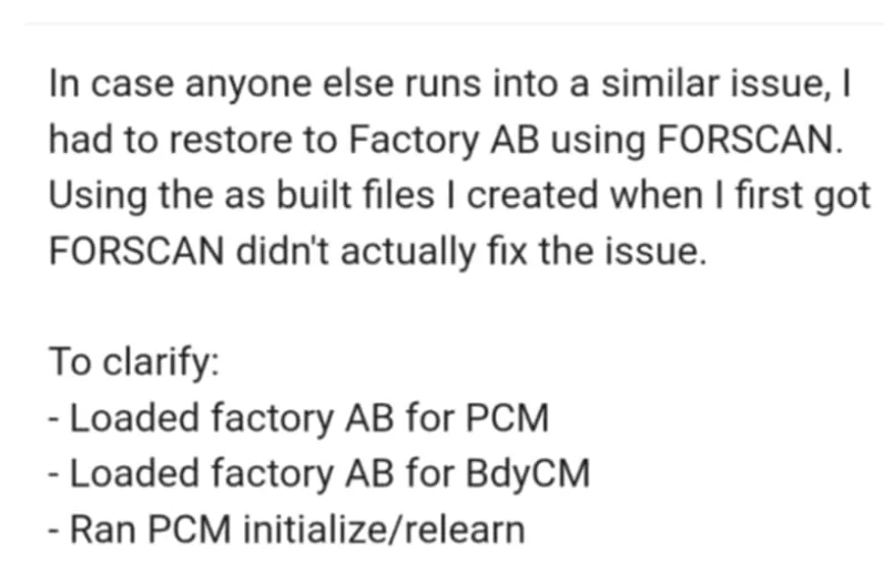

Ford Ranger FORScan Caused Check Engine for Tire Circumference Change Screenshot_20250816_214026_Messenger
Reactions: PAW
