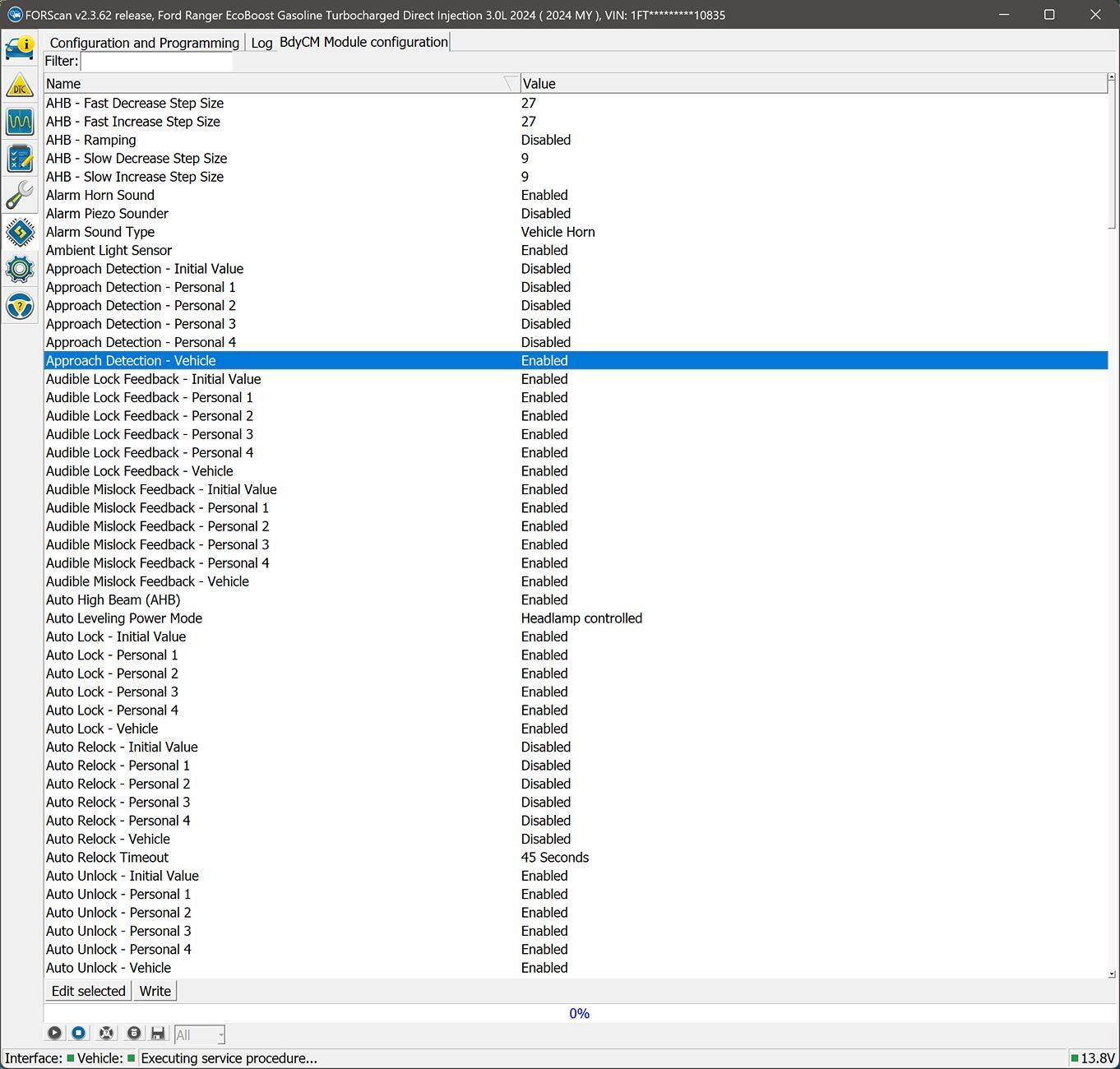

I have nothing in the ”lighting” tab to turn on or off Welcome Lighting, I like this option on my F-150 Raptor, but it isn’t present on my RR. Owners manual mentions it.
And there is no “Windows” tab at all, I’d like to have the Global windows option.
Will I have to use Forscan to turn these features on?
Try this?
Ford Ranger Most Popular FORSCAN Changes 1725912984431-4
