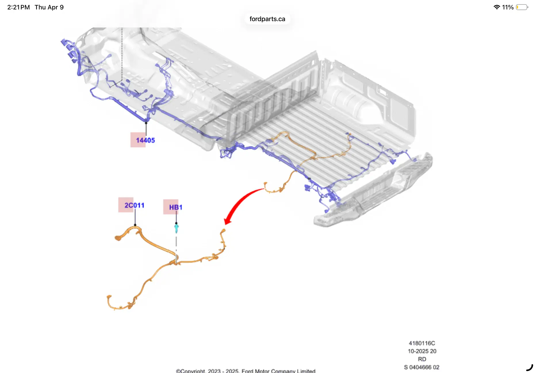

I’d protect the connector with maybe some sheet metal.
I wonder where the connector is?
