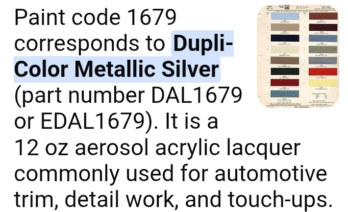

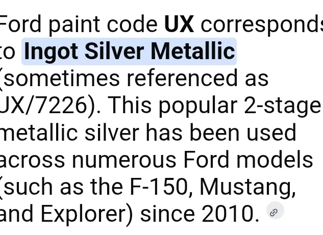

Appreciate your response. Talking to my dealers body and paint guy (actually ran an independent shop for a few decades) other options in play are as attached. He gave me some ux from a can, so I'll paint a small piece of plastic and post up the results. Otherwise I'll give a try with the js. It's a shame that it's so whack a mole with Ford trim pieces. And as far as the Ford ranger raptor bumper, forget about it. It's a matte finish, so really not possible to make a blemish recoated without painting the whole thing, and then using a matte or satin clear coat. He quickly solved the issue by just getting me a new front bumper under warranty, even at almost 36k. Love that guy.

I stand corrected sir, thanks for that info. I was told that info by a parts counter guy at my local Ford dealer. Glad you found the right one.

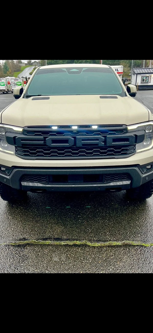

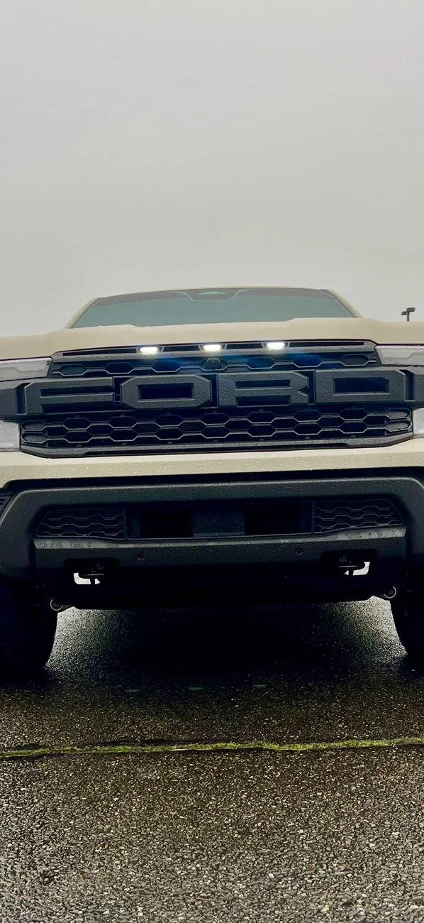

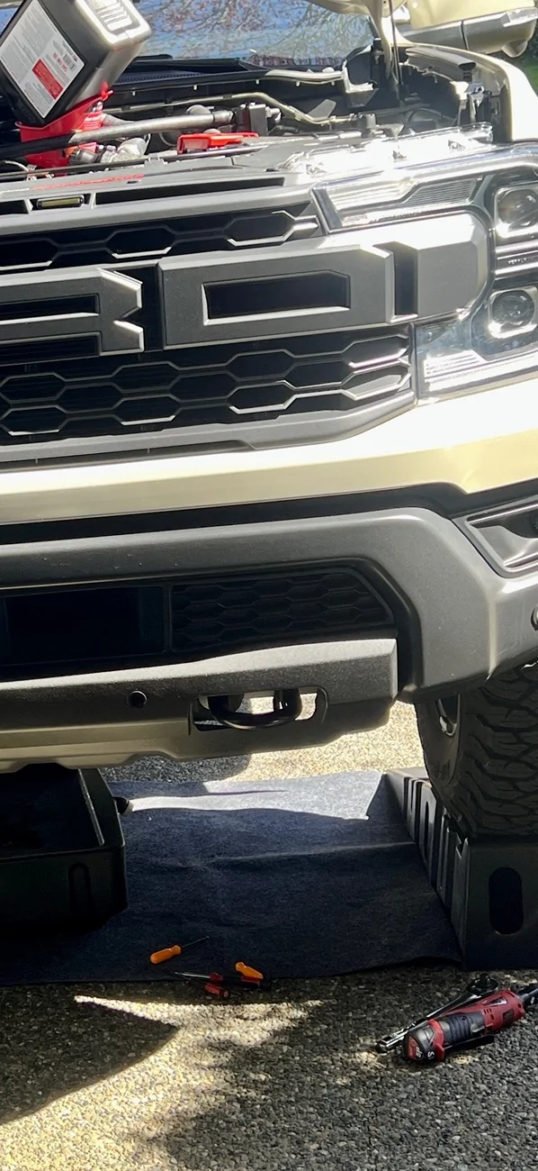

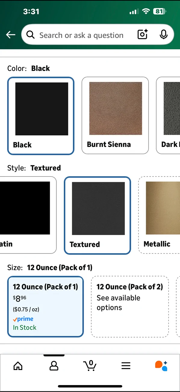

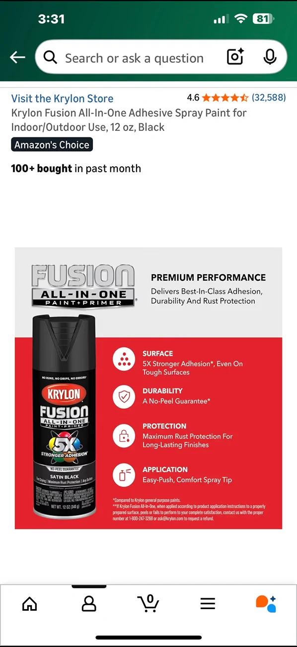

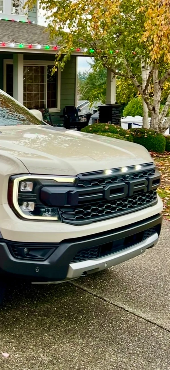

I’ve found this to be a nearly PERFECT match to the dark gray RR bumper & trim. Went from that horrible silver to color matched gray. Yes the can says black, but it has something to do with the way it lays with the textured variety. And by textured it isn’t very much. You don’t really see the texture, but you can feel it. I scuffed it with scotch brite, degreased, 2 coats adhesion promoter, and 2 coats Krylon. Been on there for 6 months. Still looks great!
