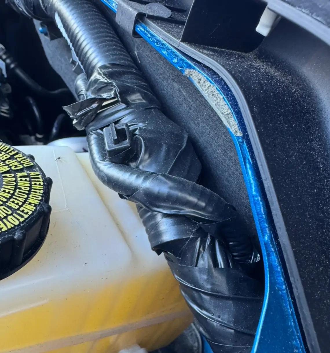

Noticed this spot near the firewall where it looks like part of the weld broke off…should I just use touch up paint on it so it doesn’t rust? Or should I let the dealer look at it?

That was most likely a blob of body sealant that was painted over and has since broken off. It should not pose any structural concerns, but if you have some touch-up paint it would be wise to clean and recover the area.

thanks. What’s the best way to clean before paint?

For something like that which is protected from weather, I would probably just wipe it down with some alcohol to make sure there isn't any oil mist or anything in the area and touch it up after giving it ample time to dry. I wouldn't want to use anything too harsh to clean it and risk messing with either the sealant or the surrounding paint.
