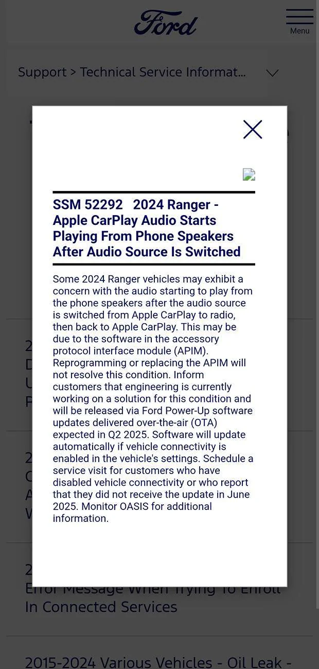

Ford is aware. ETA is Q2 '25 which seems ridiculous.
Android Auto has not given me any trouble thankfully.
with the way it’s written I feel it’s a error where they put 2025 instead of 2024.. but yeah they said it’s take over a year to fix is absolutely dumb. @Ford Motor Company this should be a HIGH priority to be fix… it should not take OVER a year to get fixed
