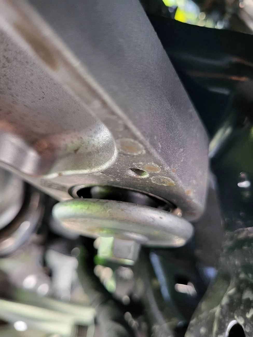

Pretty sure I found front end clunk this isolated bolt for the rack and pinion slaps into mount this bolt is tight but still make steel to steel contact. Back to the dealer when wheel senser comes available they can adress both
Ford Ranger Xlt multiple issue under 500miles 20240706_144020
