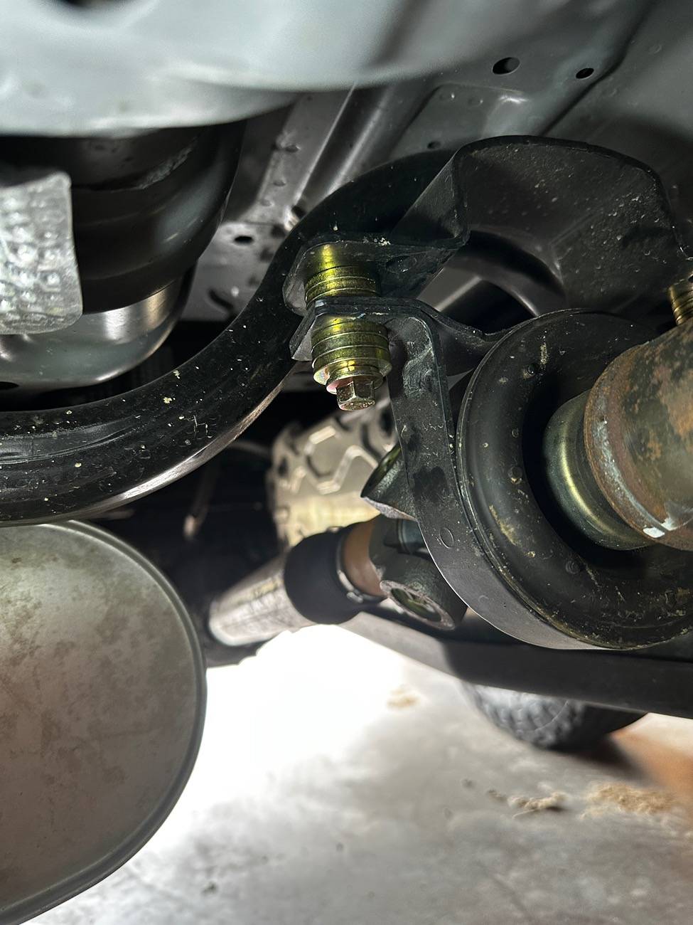

So finally got the spacers installed. Very easy. I don’t think the vibration is completely gone but it is much better. I’m satisfied.
Ford Ranger Post Lift Install Vibration IMG_3091
