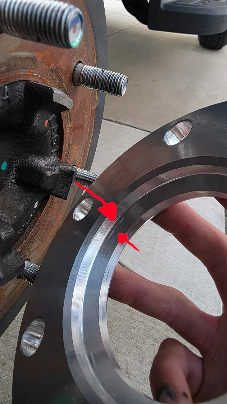

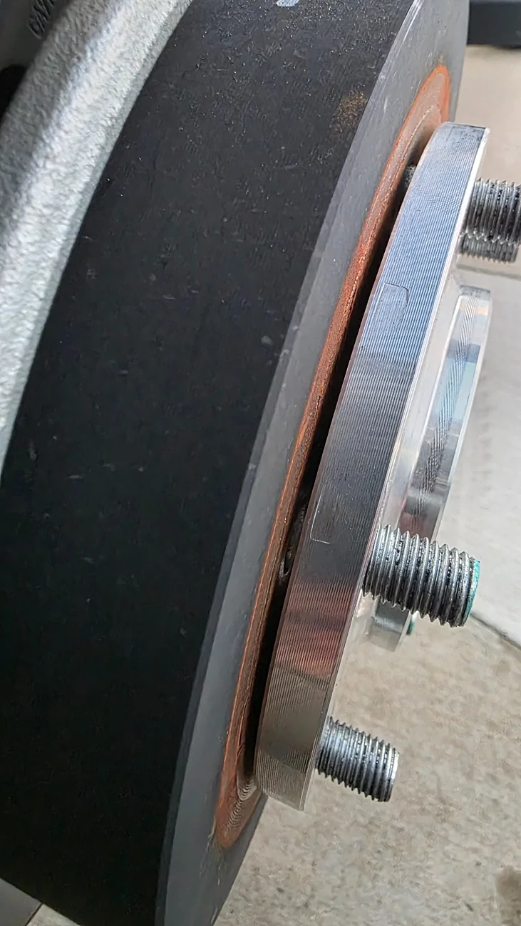

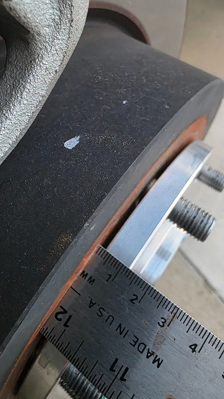

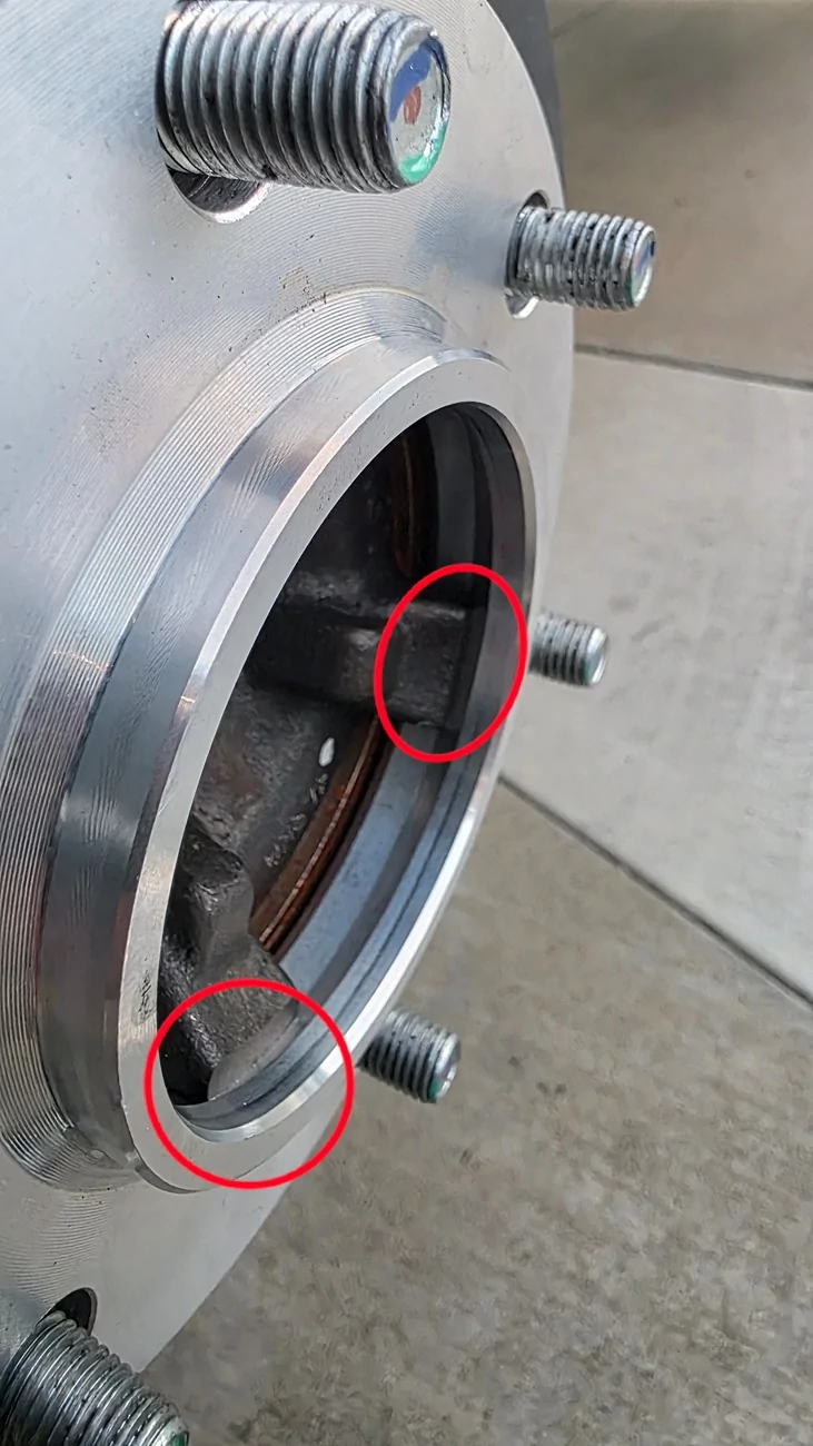

The 3/8" (10mm) hub centric spacers from "Wheel Adapters USA" do not fit on my 2025 Ranger Raptor rear hubs.
They are about 2-3mm from sitting flush! Not good and now I have to waste my time trying to return them. For someone who isn't looking closely this can be extremely dangerous! Also, their extend lugs don't fit through the RTR wheels
