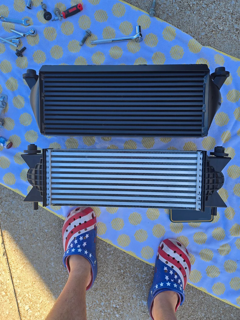

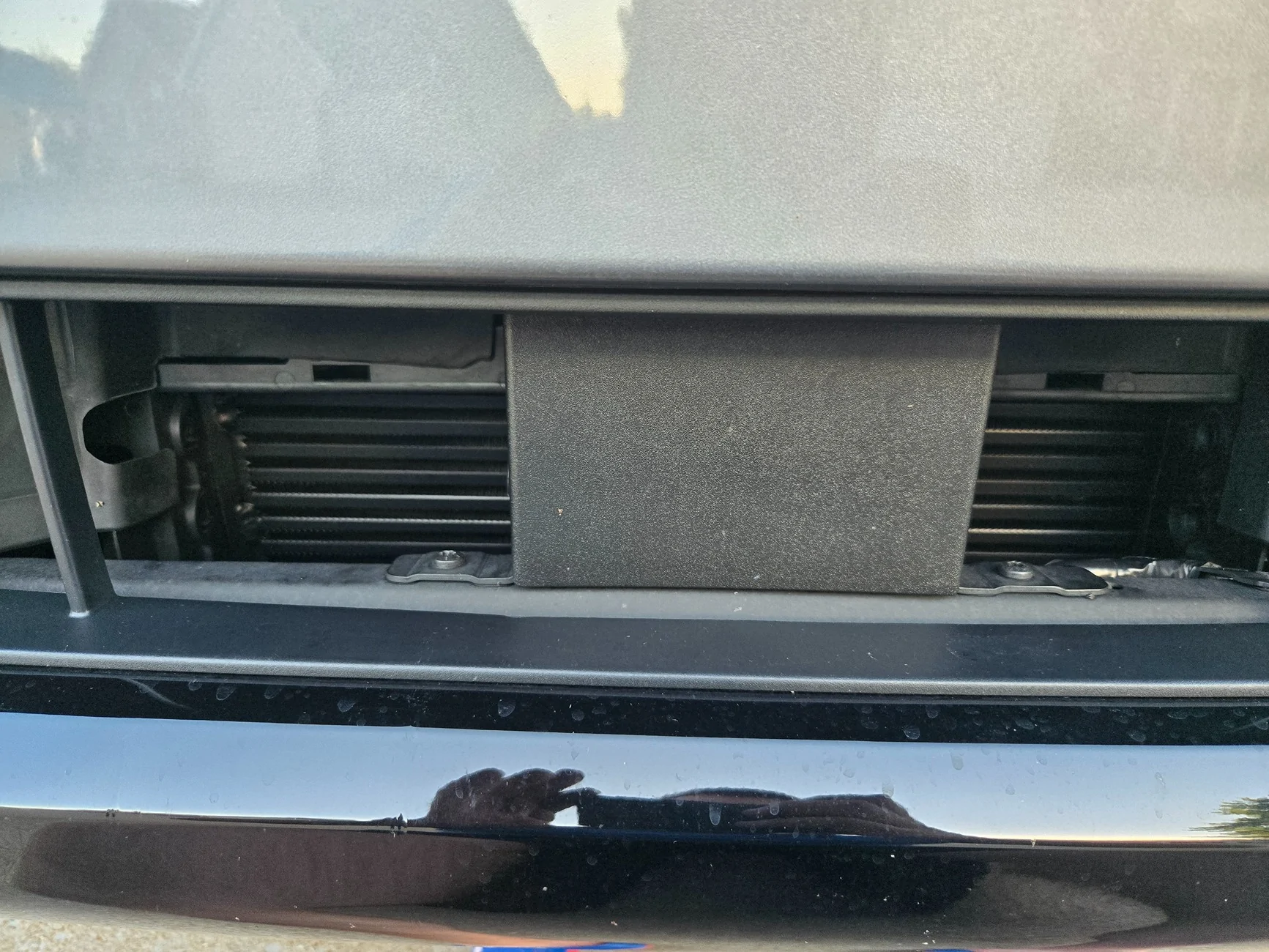

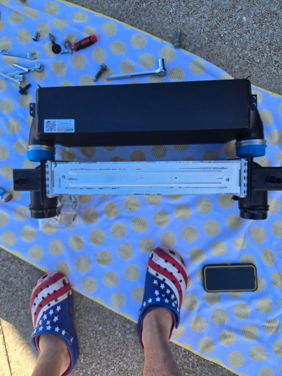

With plans to utilize Raptor intake/chargepipe/big intercooler scrapped due to the 2.7s EGR i went with the largest stock placement intercooler currently available for the 2.7s, you could throw one on the 2.3 as well.
Wagner only lists thier intercooler for the 2.7 for the bronco, but it fits the Ranger and it is the largest by frontal area/volume stock location intercooler. Its the same exact wagner intercooler as the Raptors with a different (single outlet) cast end cap. You can see from the pics that the intercooler is taller and unable to use the top grommet locations, you have to remove the front louver/intercooler cross support bar, and that is where the hanging brackets for the Wagner mount, where others go for a deeper cooler with stock frontal area for easy stock mounting. Just FYI for thoseshipping.

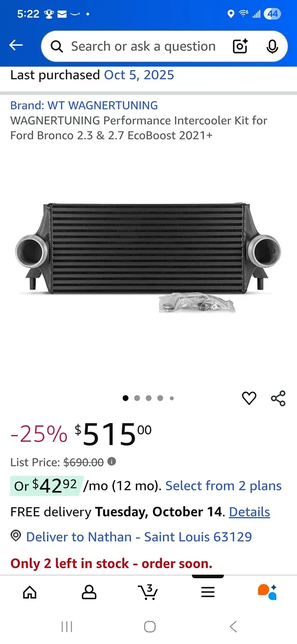

This intercooler is also available from Amazon for $515 with free shiiping.
I used this thread https://www.ranger6g.com/forum/thre...tion-diy-how-to-for-2024-ranger-raptor.15033/ and was perfect for any questions I had during the install process, with the caveat that non-raptors do NOT have rear louvers on the intercooler.

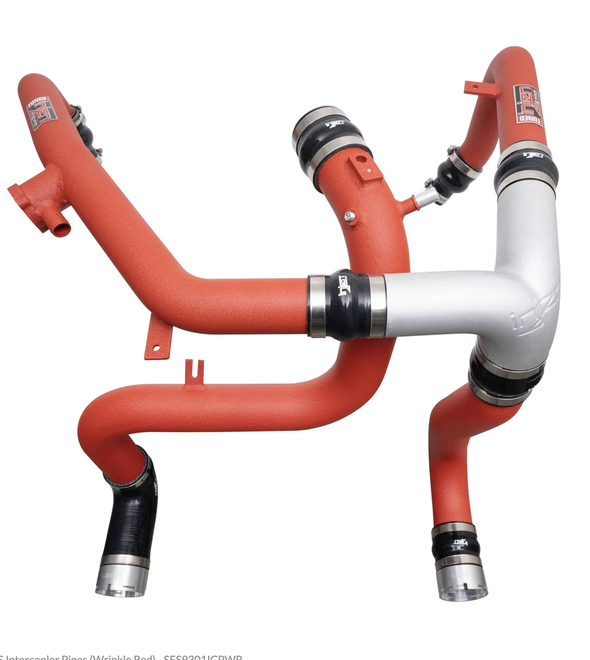

Im going opposite direction. Gonna try your 2.7 setup. The two hotside pipes are so tight when you increase the diameter.
Well glad something good came of the 2.7-3.0 mod swap ideas 😆. Yea the 3.0 deff makes a tight space with upgraded charge pipes all in the front right corner.
I was hard looking at these exact pipes, then Injen responded to a question i sent a while back saying their ceo just bought a 2.7 Ranger and they are developing intake/charge pipes, etc. at the moment. So im ecited to see what they put out
That thing is up to $690 on Amazon now. Do you have a catchcan on your 2.7 as well?
