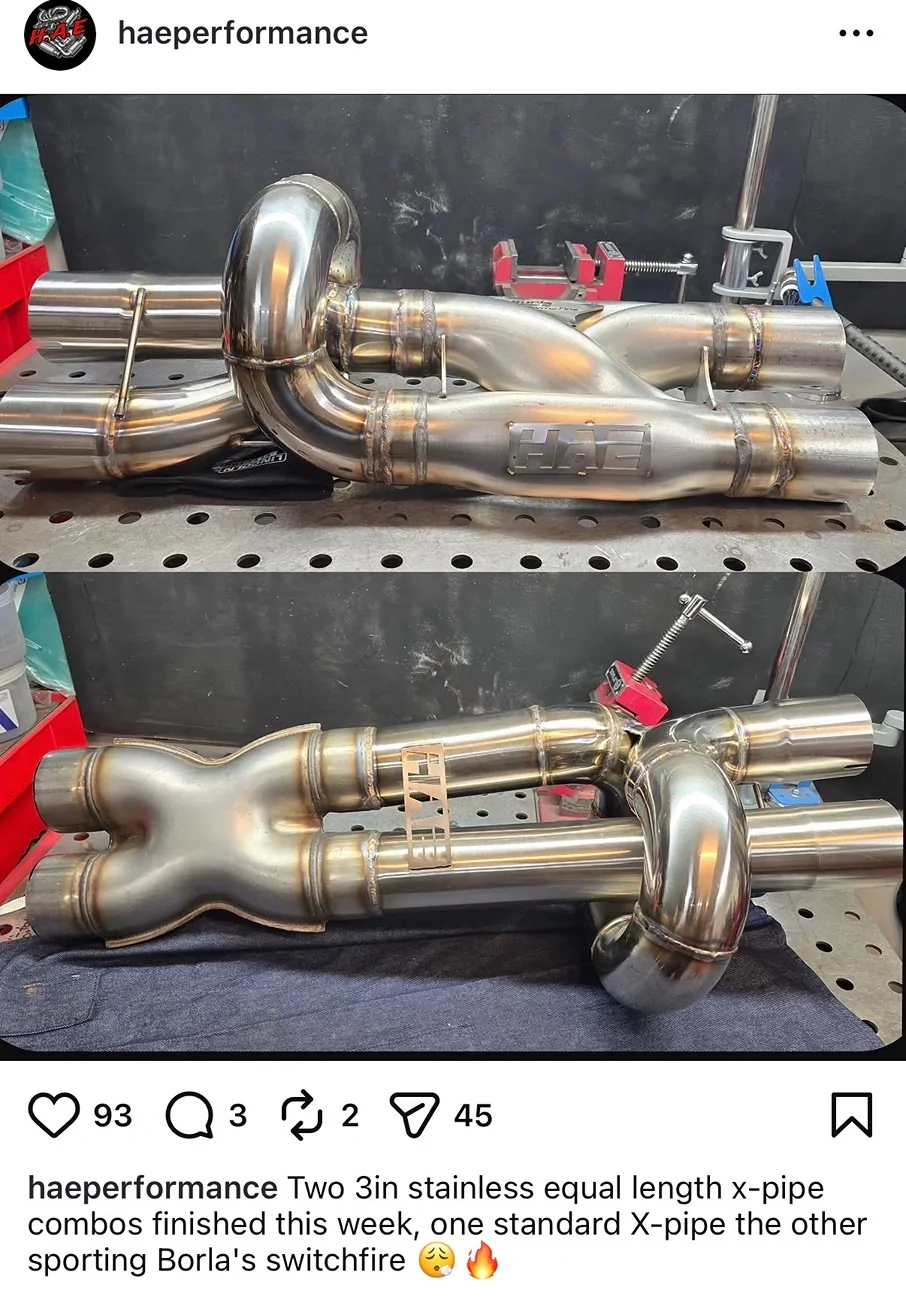

I know there are a few 2.7 exhaust options .
Also Spd and Xforce are working on systems but they may be next year before released to im chewing on having a custom system done.
Would 2.5 duals be best or 3”?
Id like to do a trombone loop from Hae performance then possibly dual resonators and dual mufflers.
Thoughts on the best resonator and mufflers on these?
Or am i better off just doing the borla
