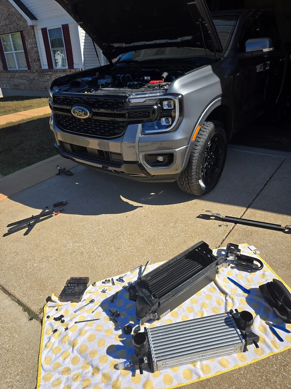

Any stock location new Gen bronco intercooler made for the 2.3/2.7 will fit on the rangers, put a wagner intercooler, only listed for bronco on my 2.7 yesterday
Ford Ranger 2.7 Intercooler on Ranger? 20251009_121630
