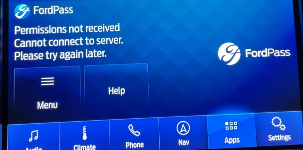

Thank you soo much for your reply! The cars which are sold here by the official retailers come from the US as far as i understood… the modem is installed as far as i can see in the menu, since it allows me to initiate the setup. But when setting up it tells me following, see attachment. It was not advertised especially by them but they said it comes with maximum configuration the car… i would not mind just exchanging the modem…. Haha hope you can somehow further help me? would a foto of the modem help?

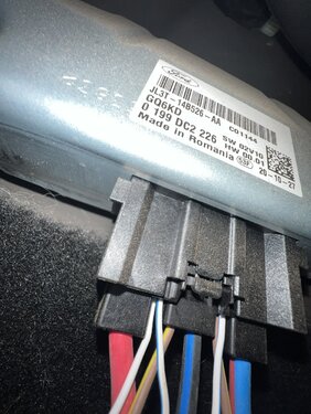

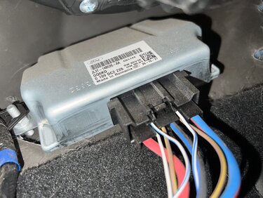

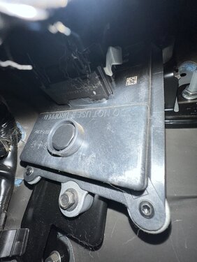

So what i could find were this 2 parts see files attached… I guess it must be the silver one and not the black one, because the black one looks like the transmission control unit (tcu) since it says fomoco on the other side. The silver one sadly says nothing i can make use of :(
None of them are the modem. Unfortunately the only documentation I have on it is for right hand drive vehicles, and I can't extract the pictures out. Maybe you don't have the modem, if it's disconnected the option will still be in Sync but you just get an error apparently.
