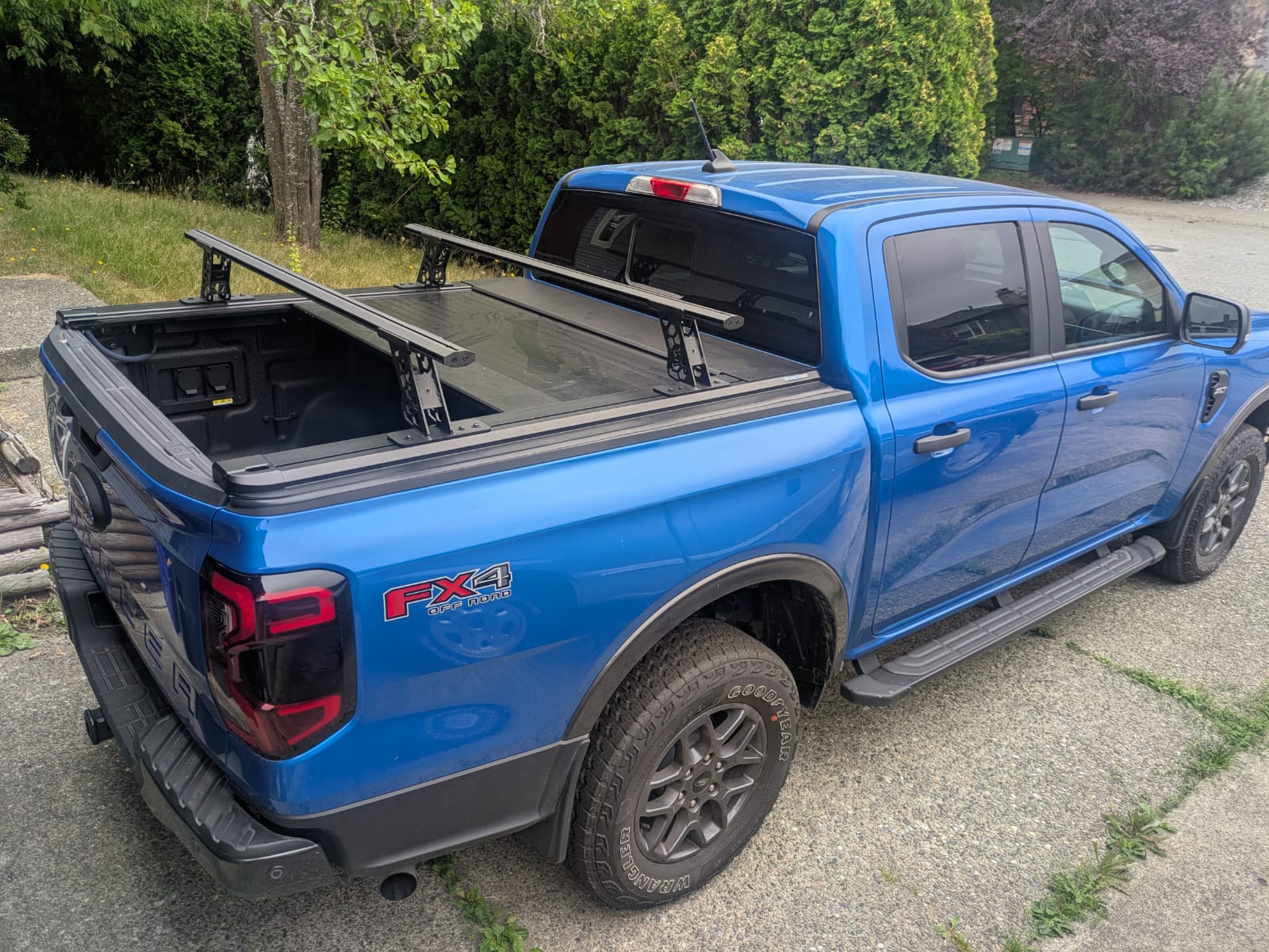

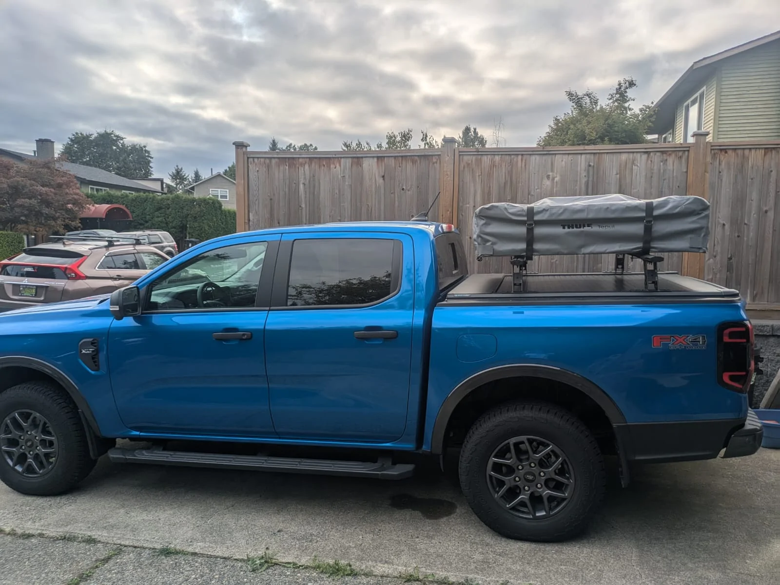

If you can find a local distributor (Amazon?) I went with Go Rhino XRS 5935015T.. about 7" height above the tonneau which kept my tent closer to cab height. T-slot model (or standard as an option). Rated 600# static or 300# dynamic. 1/4-20 bolt heads slip into the crossbars on all 4 sides to mount accessories - tent mount bolts around.
Stock hardware is a metal bar with 3 tapped holes so they require T-slots with removable end caps, but I found unistrut nuts fit perfect in (my) slots
