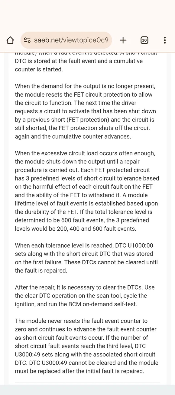

Like several of you I tinted the side makers on my Ranger Raptor. While I do like the look of the tint on my all black truck I’m not thrilled with how much the tint reduced the light output.
Has anyone replaced the OEM bulbs with something brighter and if so what did you use? Are the OEM bulbs LED’s?
Thanks

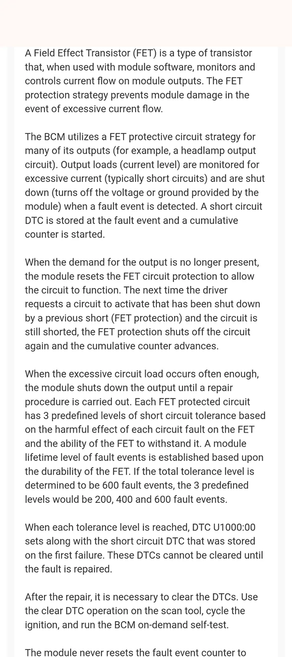

If the side markers are anything like the base model they are led, there is no access to a bulb, it's just a sealed unit. That's as I understand. I tinted my markers and it substantially reduced light output. I also found out that an additional ~60watts can be tapped off the markers, I over loaded it myself at least a couple times and thankfully it reset, I researched this and came up with the pictured info.
