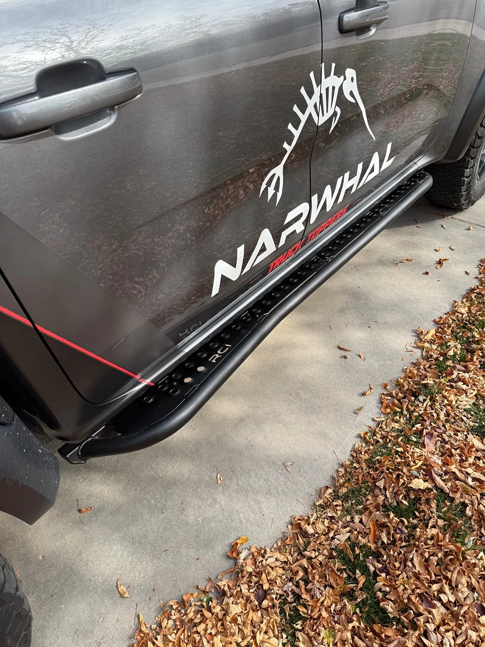

To echo many comments above. We have run the truck hard without steps, and this results in a lot of rock chips. PPF is a must if you’re going to run no side steps long term. We are running RCI sliders now. They look great and add real protection from impacts and debris.
There is debate around whether bolt-on frame sliders could compromise the frame. Only time will tell, as we have not seen anyone report that their frame was bent as a result of a significant impact on the sliders.
There are a few slider options that install in the same area as the factory side steps, and several members seem to be happy with them so far. We have several photos on this forum of our setup, as well as videos on YouTube showing the truck with and without sliders. Hope this helps.
