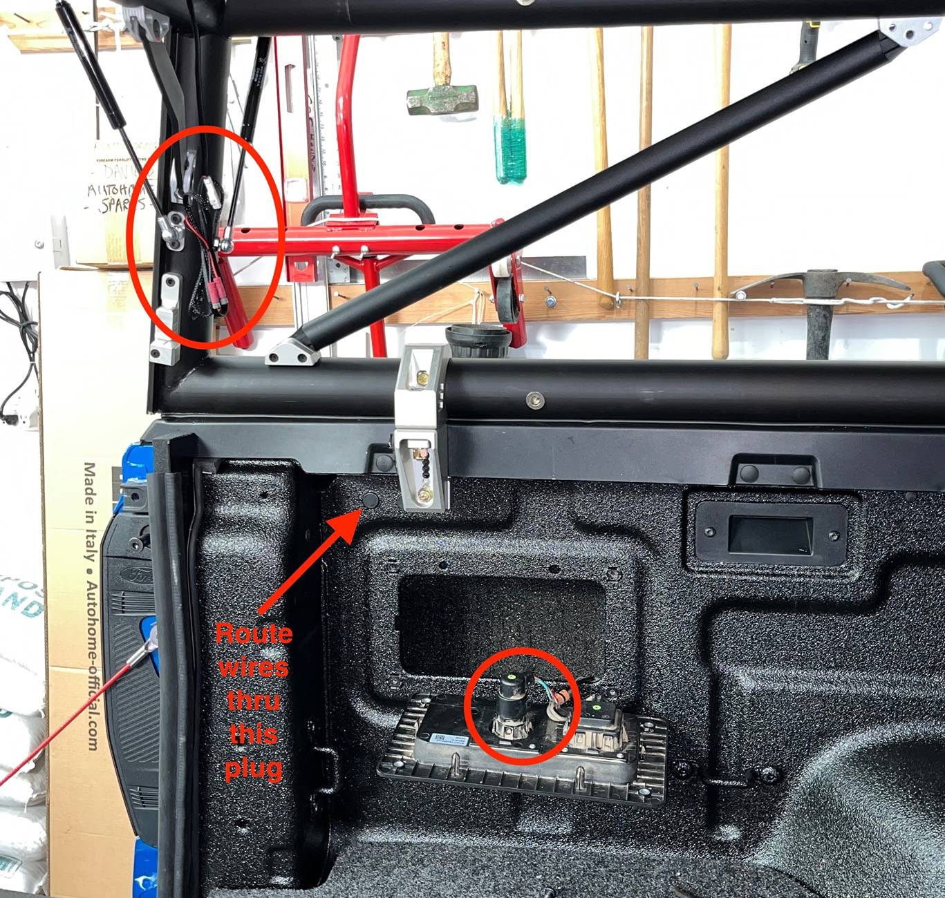

GFC allows 60 minutes for installation, so they definitely do NOT wire the third brake light. Here is my solution, it worked well.
https://www.ranger6g.com/forum/thre...-light-i-have-a-12-volt-power-question.15723/

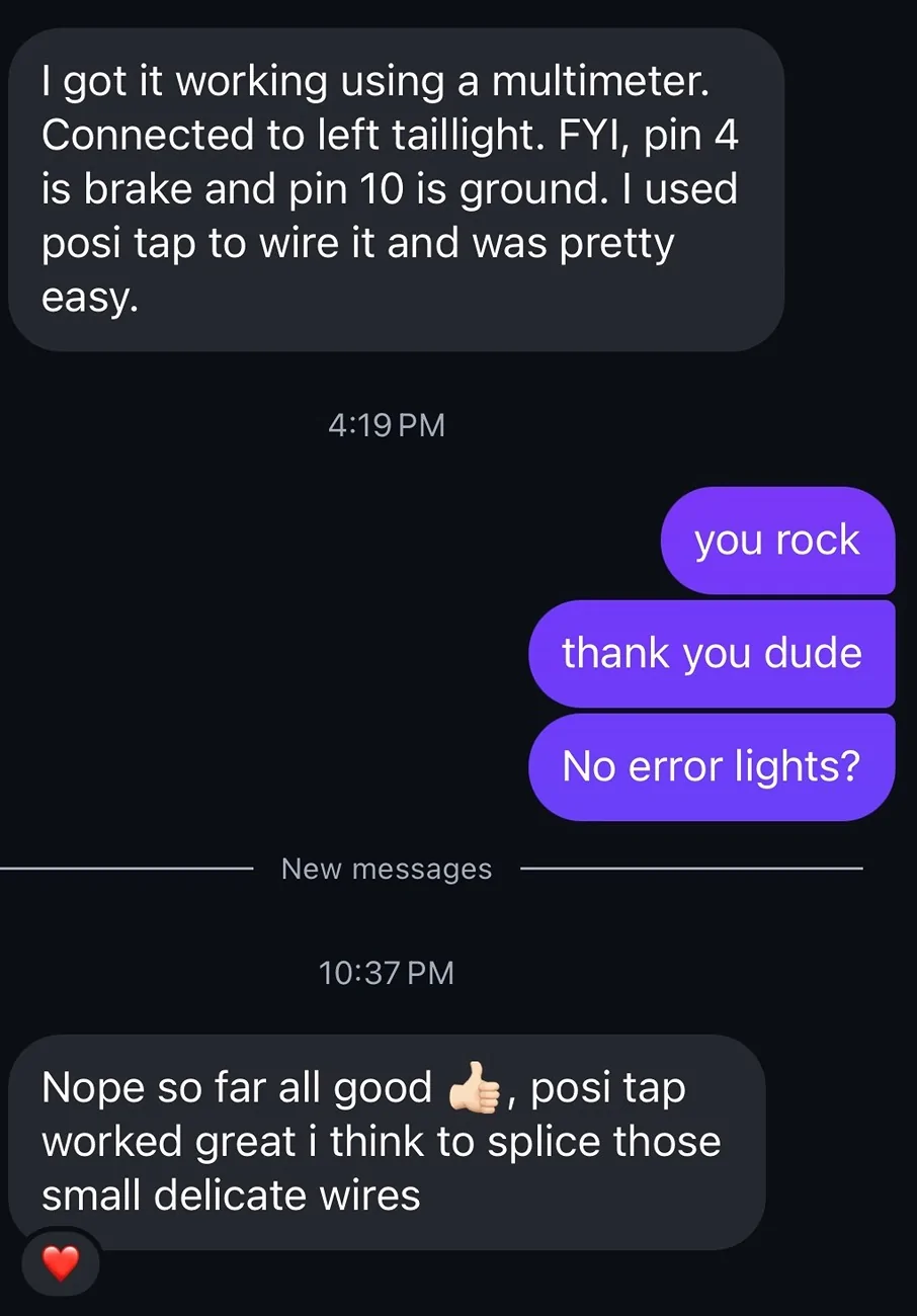

Use a multimeter and check voltage at the tail light. I haven’t cared to do it but it’s easy.

You cannot just splice into the existing wires, it will trigger strange warnings, you have to use an adapter.

All you’re doing is pulling power and a trigger from the third brake light. Did you try it and it had problems? I know multiple other people who tapped in with no problems.
