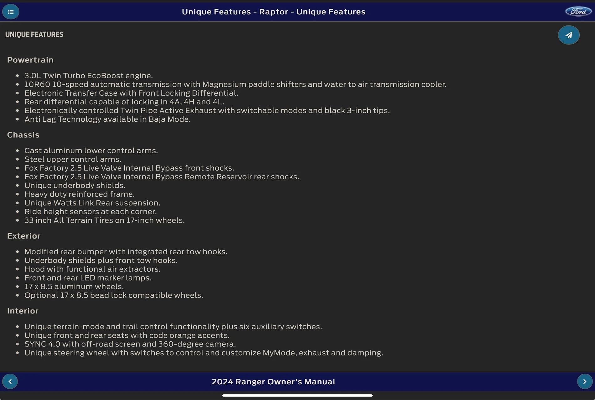

Here’s a list of Raptor unique items from the On line owners manual.
