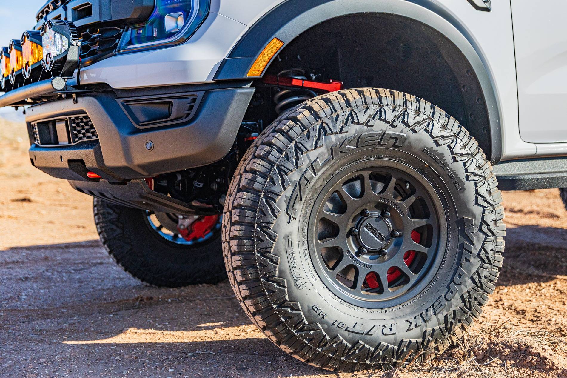

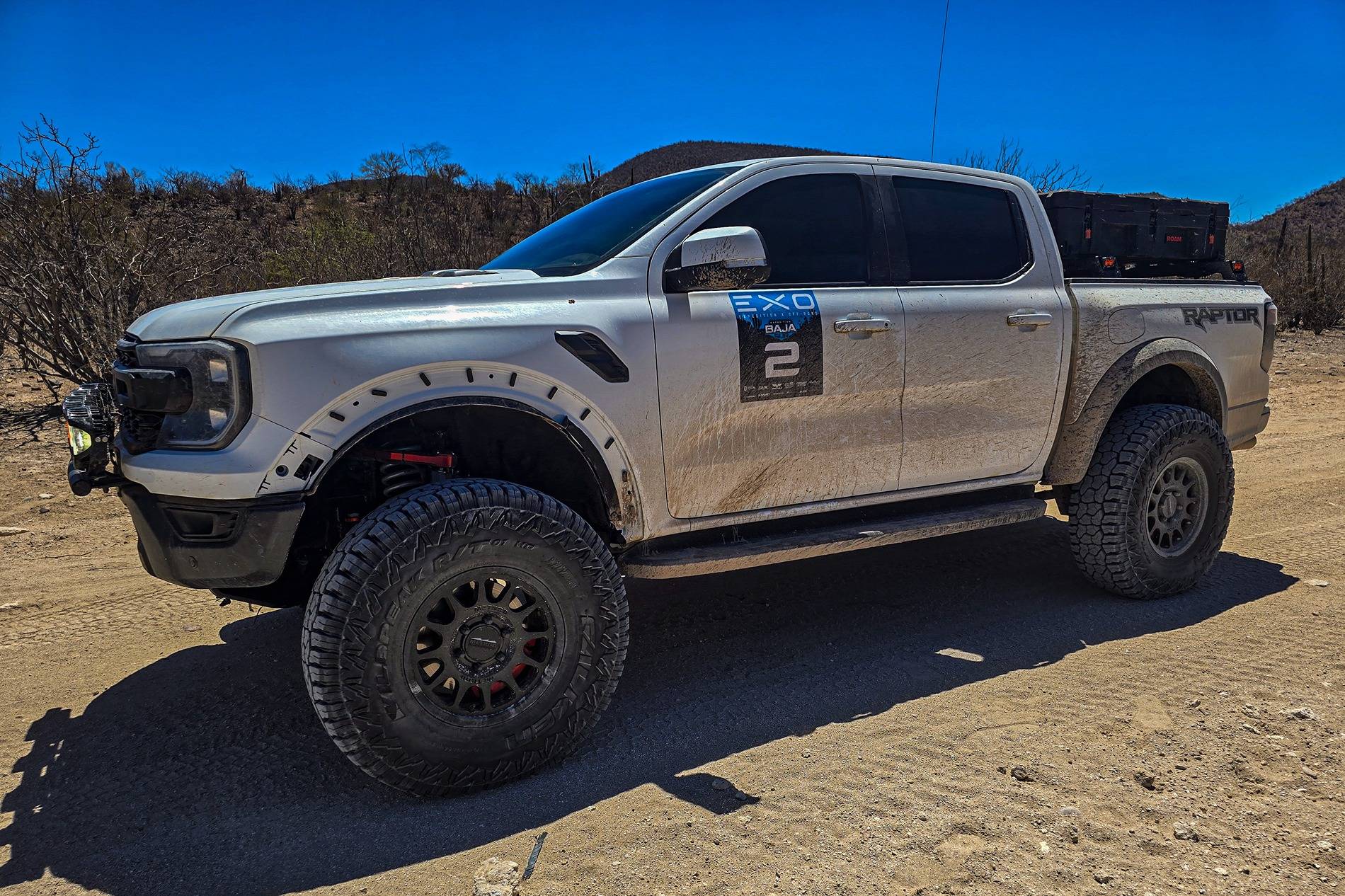

Just ran these in Baja last week. SOLID! We still have rubbing under full load with our 37" Falken tires so not yet "perfect" but definitely help.

Portals too? What springs on the rear.

Yes on Portals. I posted full rig in rig builds. Search for "ultimate". No springs on rear yet and no rubbing on the rear (but the rear bump stops got lots of work).
Eibach has promised 2 levels of upgraded springs in the fall. Both same length. One "slightly stiffer at 500lbs and one "much stiffer" for rooftop tents, etc. at 1,000lbs.

These trucks look so good on portals. It's the space between the wheel and fender that does it, IMO. I really wish these were in the cards for me.

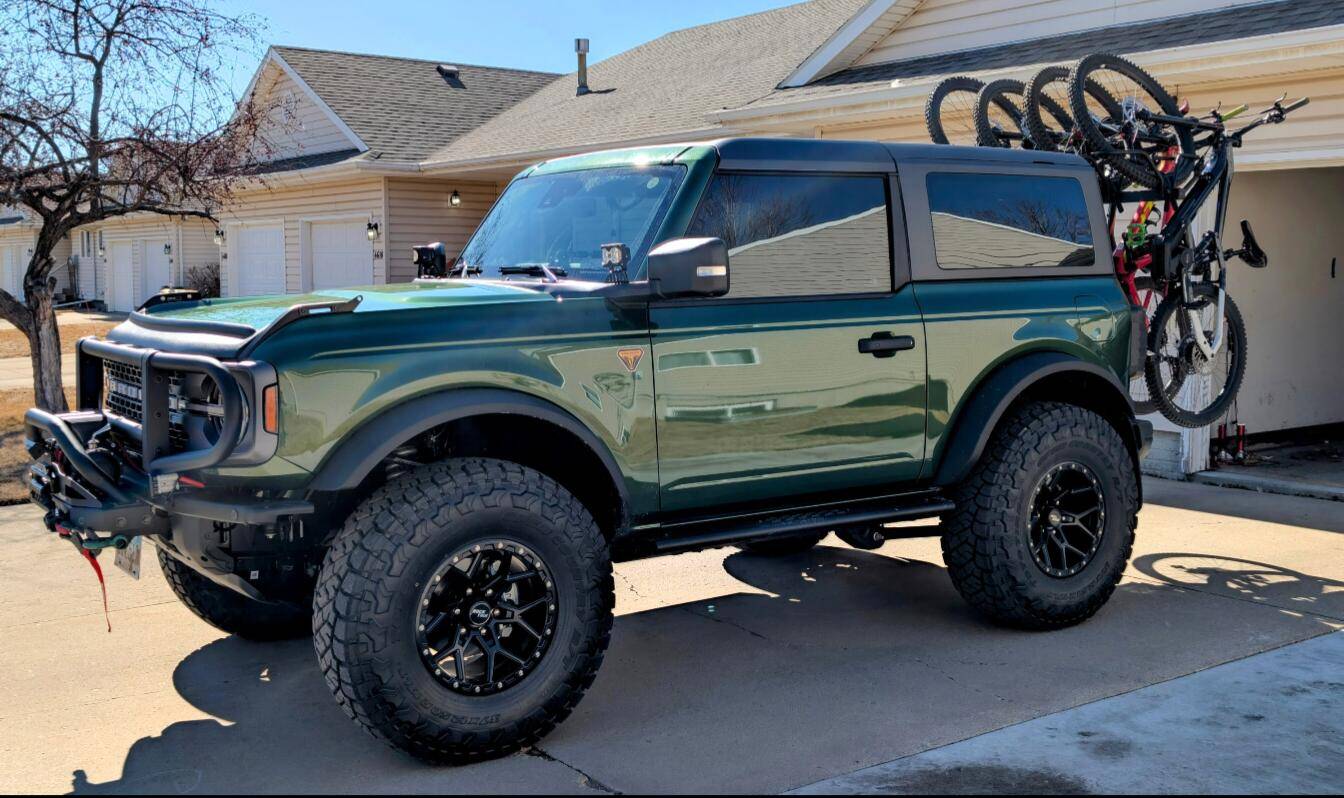

Has the ride changed? I was looking at the level 1.5's. You have the lift springs that are supposed to be matched with the rear small lift springs. The 1.5's are the leveling ones. But if they are bouncy I make look at doing a small puck instead. I have the Eibach coilovers with the HD springs on my 2024 Bronco 2.7 bl sasquatch 2 door on 37's. It rides slightly better than the oem RR suspension does.

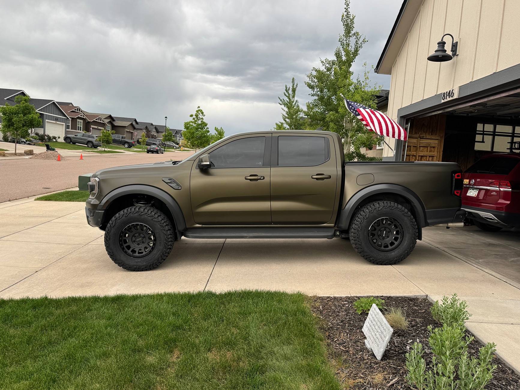

I just found out that I need to “zero” thevLive Valve after the lift is installed. I just ordered a very cheap windows computer so I can use FORScan to make the changes. I’ll probably know more in about a week as I’m away from the truck right now. One thing I will say is that my new 35s help cushion a little bit more.
