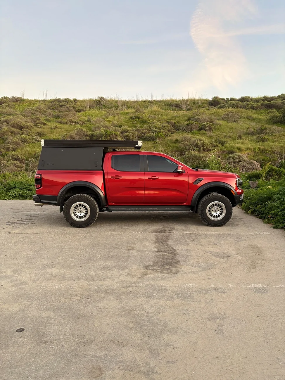

Wow. That's about my stance with my tent and rack on stock springs. How heavy is your setup? Mine is about 230lbs because I have the tent mattress out, so I'm going to guess you're pushing 700lbs?
That’s 330# in the bed of the truck in that picture. At 500# it sits exactly like stock and rides exactly like stock too.
