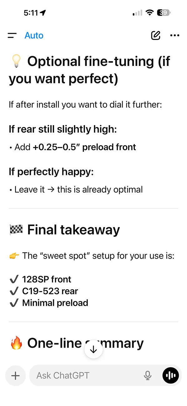

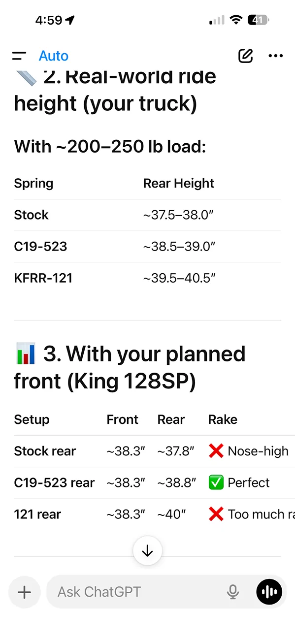

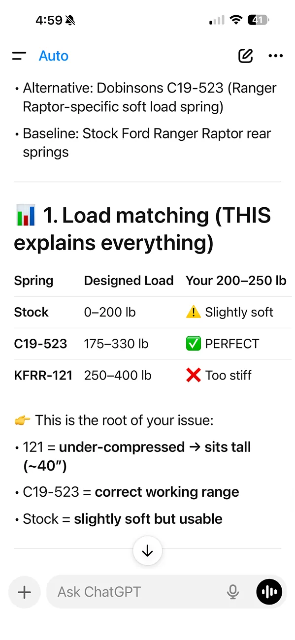

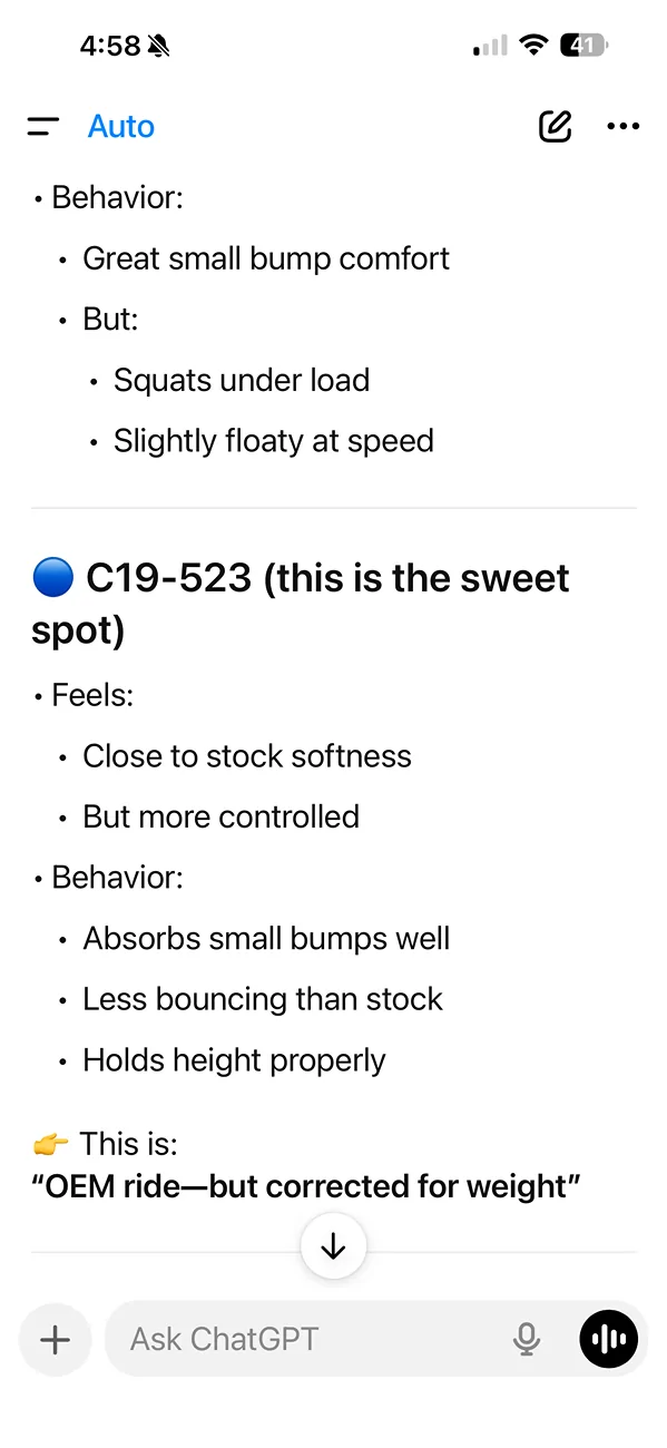

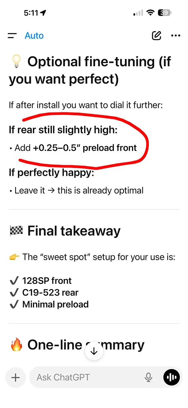

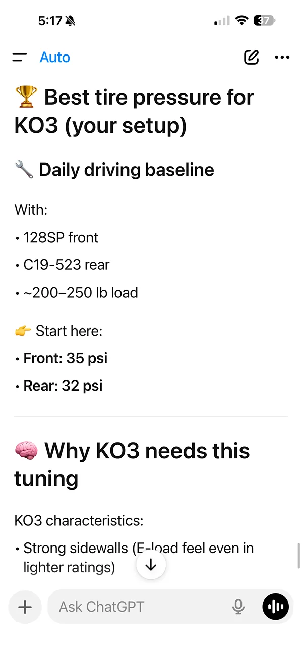

I found the springs on ChaGPT
these are the analysis comparing stock, king rear 121 vs Dobinsons

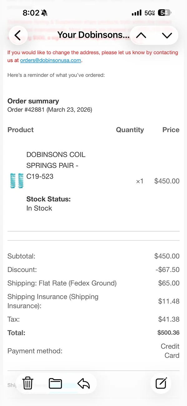

pic-n-stick
Attached is the invoice costs for Dobinsons springs. I get nothing for free. I just share what i know
