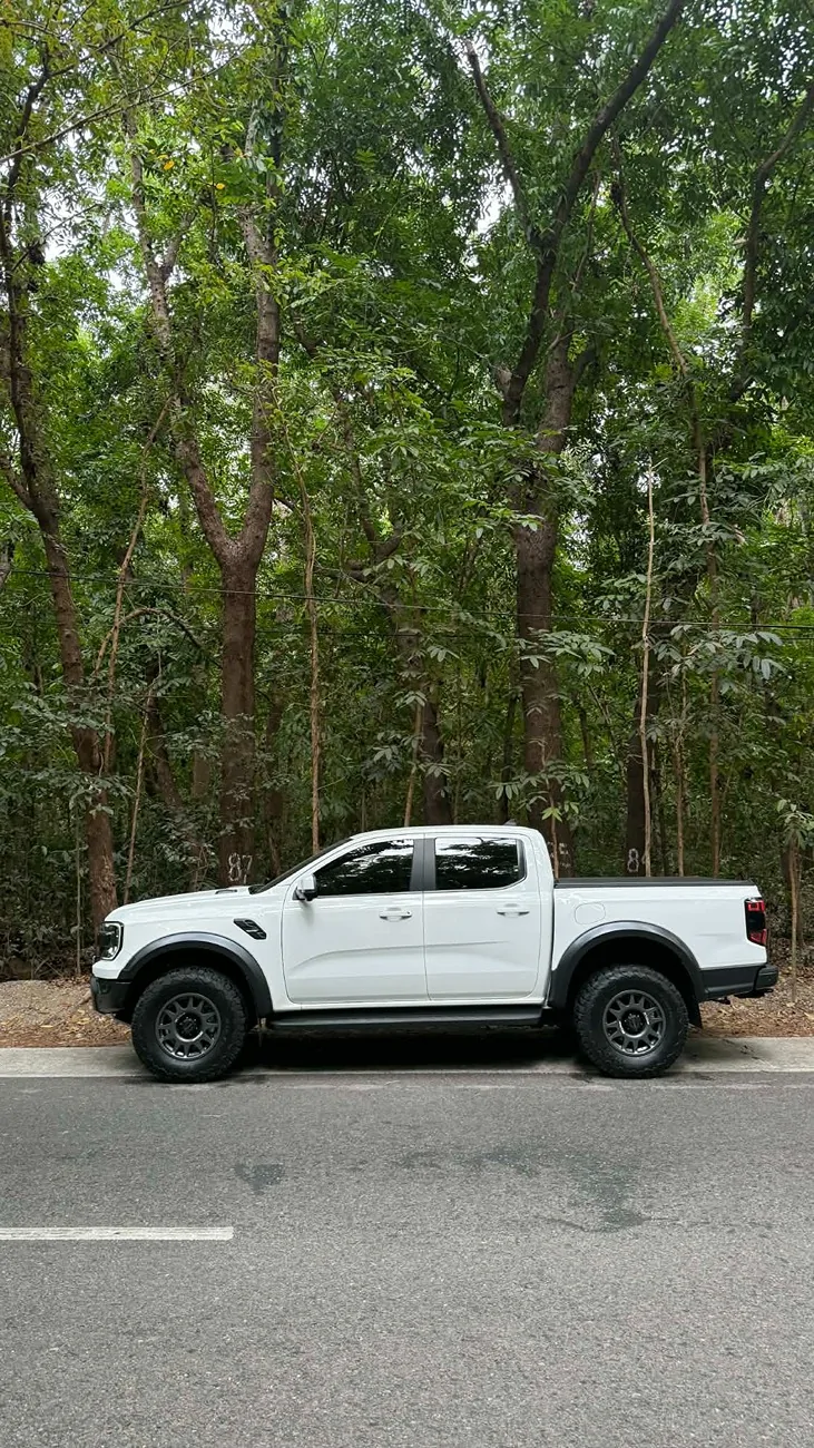

Hi! I recently upgraded my rims to Evocorse (17x8 ET+20), paired with the stock KO2s. I'm planning to upgrade to a 2" coil spring kit so the truck doesn’t look too low (and eventually upgrade to bigger tires as well).
Between Kings and Dobinsons, which would you recommend? I’m leaning toward whichever offers a more comfortable ride, since I really enjoy the stock coils' comfort.
Thank you! Cheers.
