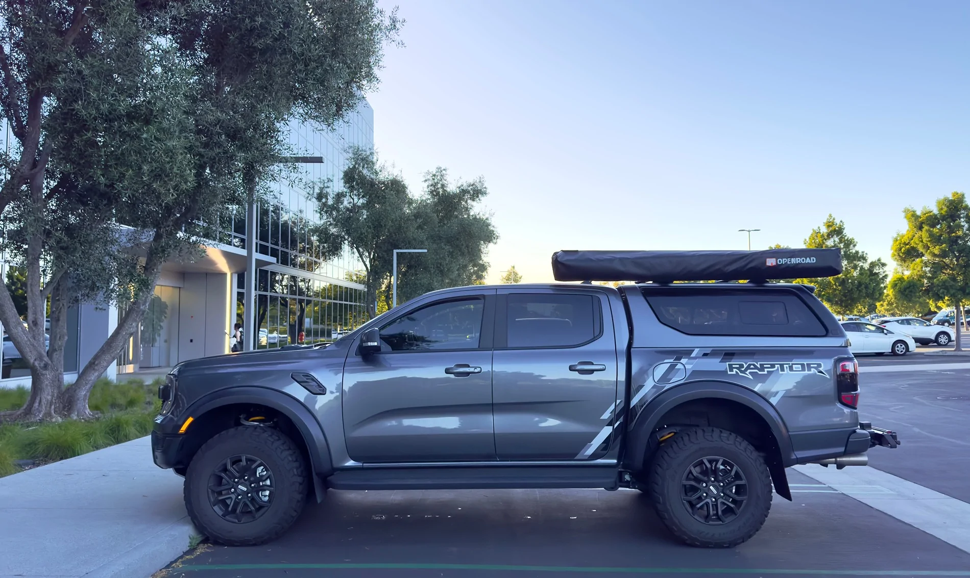

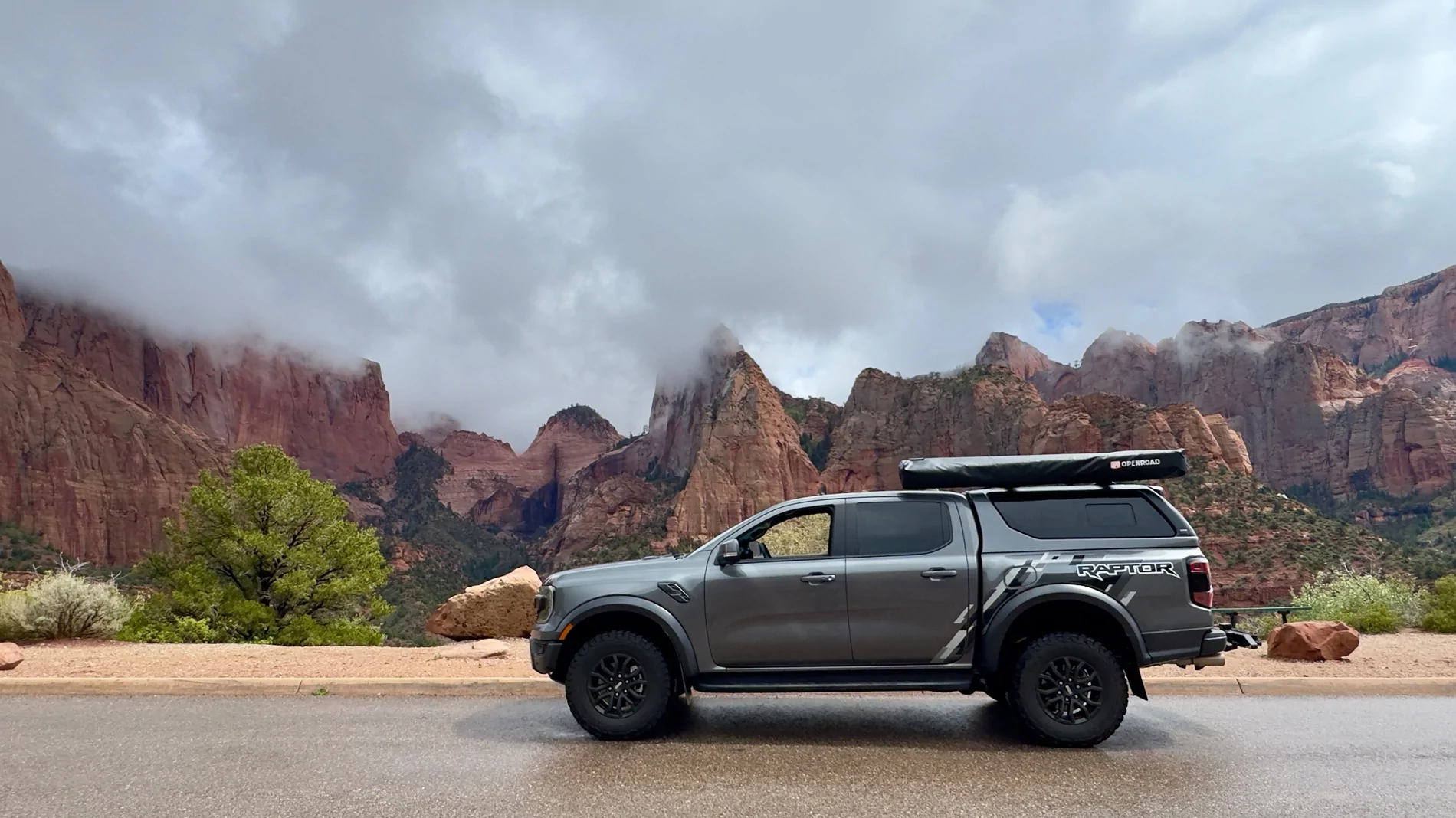

Thanks and go advice. I don’t really want lots of lift. My intention was to increase spring rate to take care of additional weights in thr back from adding the canopy, awning, ski racks and another 100 lbs.
Totaling about 400 lbs at most.
Im waiting for another rear springs that will have less spring rate and shorter length i was told will bring down the rear by about 1 inch.
what i noticed driving to Utah that the truck was more stable than the stock suspension going around corners especially down hill.
My goal is to keep within 1 to 1 and 1/2 inches within the factory specs
Thank you telenerd.
By any chance you ski Telemark?

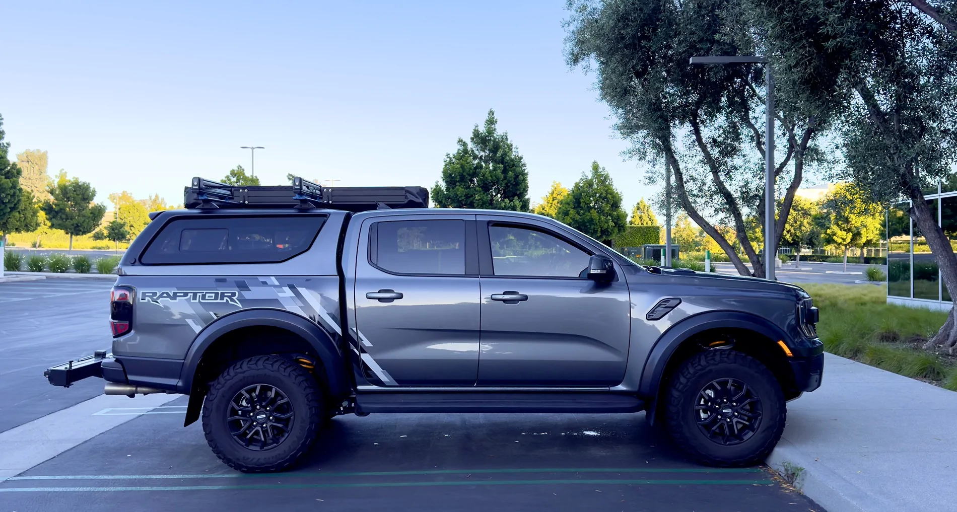

Anyways, done with rambling. Here are today installation of Kings front springs 128SP.
Hopefully will fix the rake close to factory and shift the weight backwards to load the rear more. It drives firm but control. It is not the factory design ride and I am in some ways disappointed. I cannot have all the benefits of factory soft ride and weight loading with the stuff I have.
Here are some photos and current ride height for your reference. First photo was before and after. Thanks for reading

Did you recalibrate the shocks? That might help with the ride quality.
This. You need to recalibrate the ride height sensors to maximize the ride quality as much as you can.
Why not the Eibach 300 lbs springs?
I'd do a 1" strut spacer up front to help with the rake.

BrrrRaptor I was traveling in Asia just got back. I need to get someone to recalibrate ride heigh.
Aonarch, I saw on YouTube that someone with rear King Springs 121 with 400 lb rear loading still retain close to factory ride comfort so i bought them. I added to front to level back to factory rake. I drove my truck a bit and find the control better than stock but stiffer than what I like so next step is calibration.
