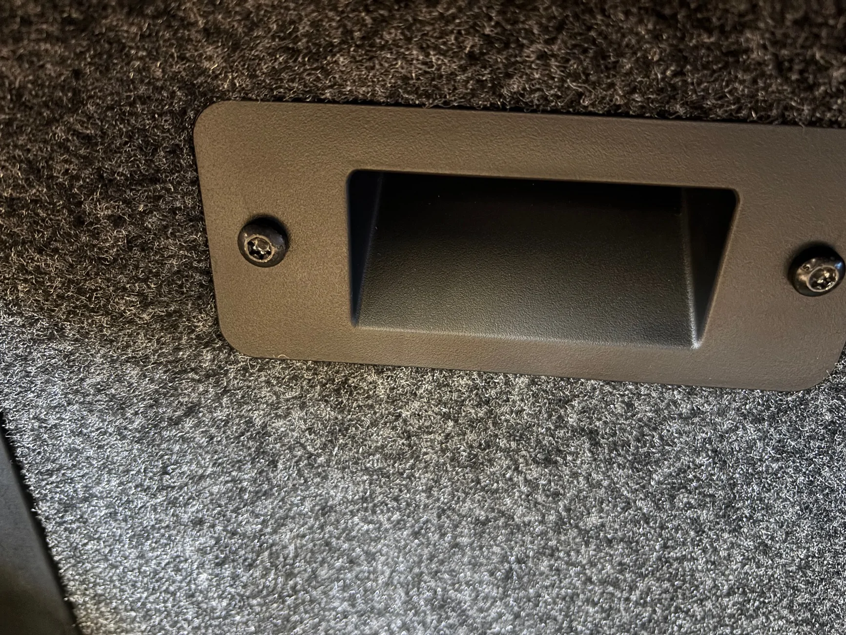

Can anyone offer how to remove passenger bed light on the raptor. I’m installing a retractable bed cover and carpet bed liner and want the light over the bed liner. While doing the drivers side I accessed the light from the hole the electrical cover provided. The light has two click tabs that are my challenge. Should I simply apply pressure and hope the click tabs survive the assault. Worse case they break and I buy a new light from the dealer.
Ford Ranger Raptor passenger bed light removal. IMG_1573

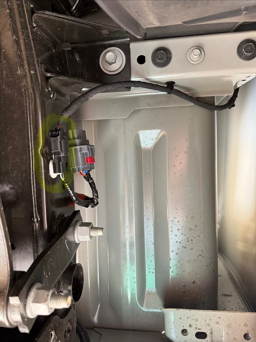

Under the frame rail disconnect the wire here. Try a gift card or similar on the top to depress the tabs. Should be ok to remove, I’ve done it.
Ford Ranger Raptor passenger bed light removal. IMG_6221
