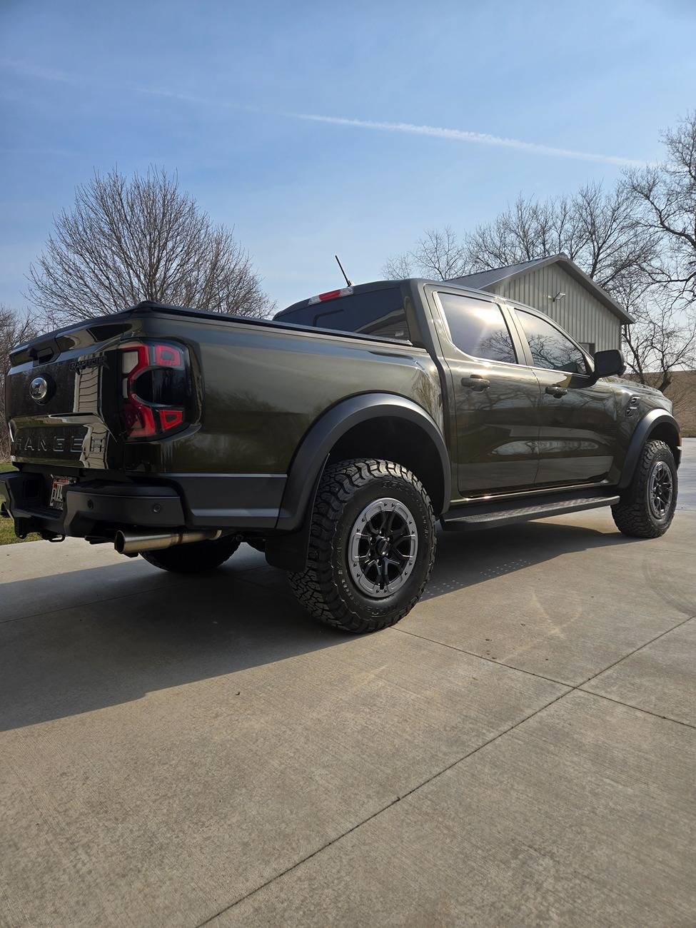

Follow up: Well, it was really simple after all. The decals pulled right off and then a wash with Dawn dish detergent and bingo: a clean look just like the photo above only green.
Thanks everyone for weighing in on this. Mine was probably simple because it had only been on the dealers lot two days.

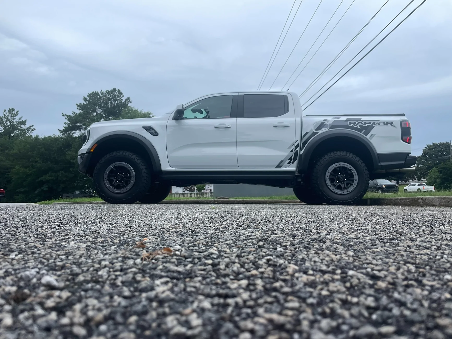

I personally like the graphics as you may notice:
Decals:
I like the graphics... the wife said a white Raptor without graphics looks like it needs a DOT number on the door because it looks like a work truck:

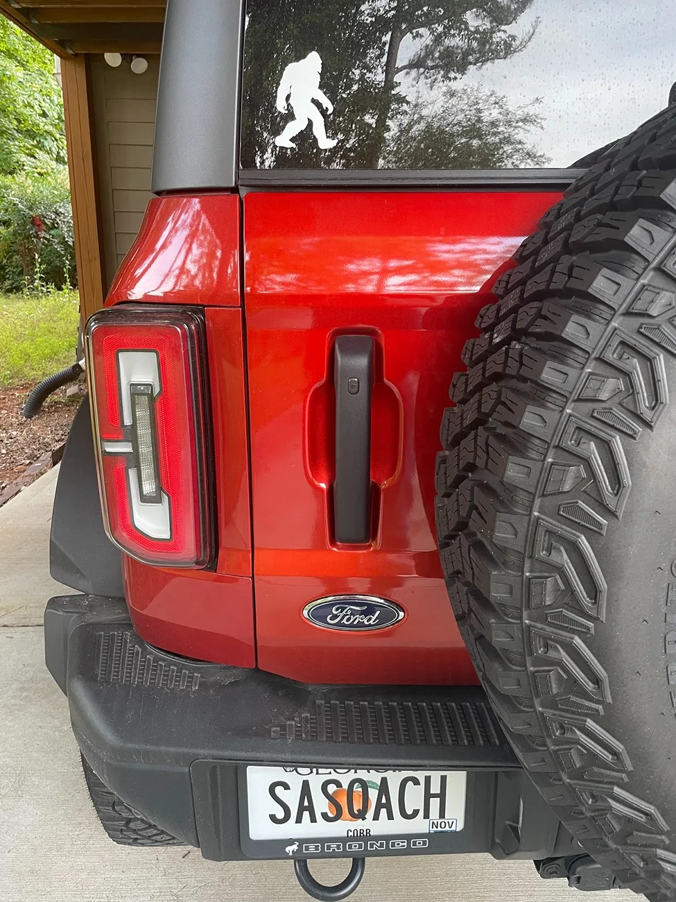

I even put silly "stickers" on my Bronco:

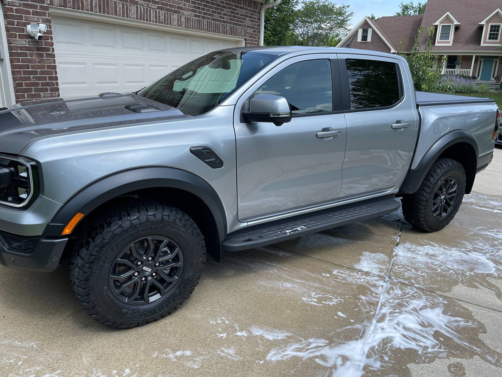

Just did mine. Set my heat gun to 110C and used a plastic razer blade style scraper to get it started. They came off really easily and in one piece. Still need to buff out the outline though.

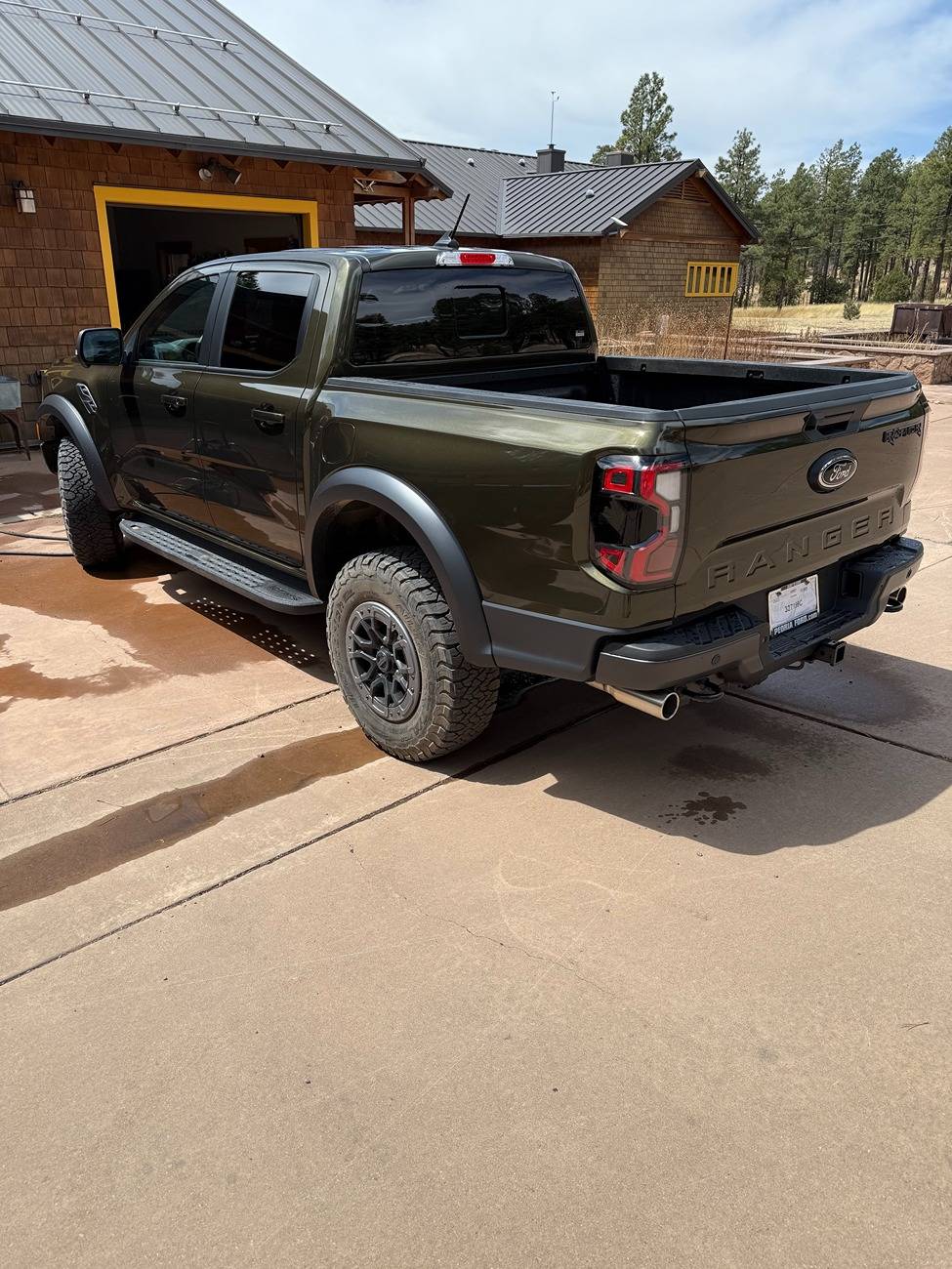

I removed the side decals from my Oxford white RR, and yes , it was a cleaner look, but missed the way the decals accentuated bulge in the fenders. I ordered the flat black, with light grey decals from Rocky Mt. Graphics . Turns out the new decals look good, similar to OEM, but slightly understated, less cartoonish. I will try to post a photo if I can learn how!
