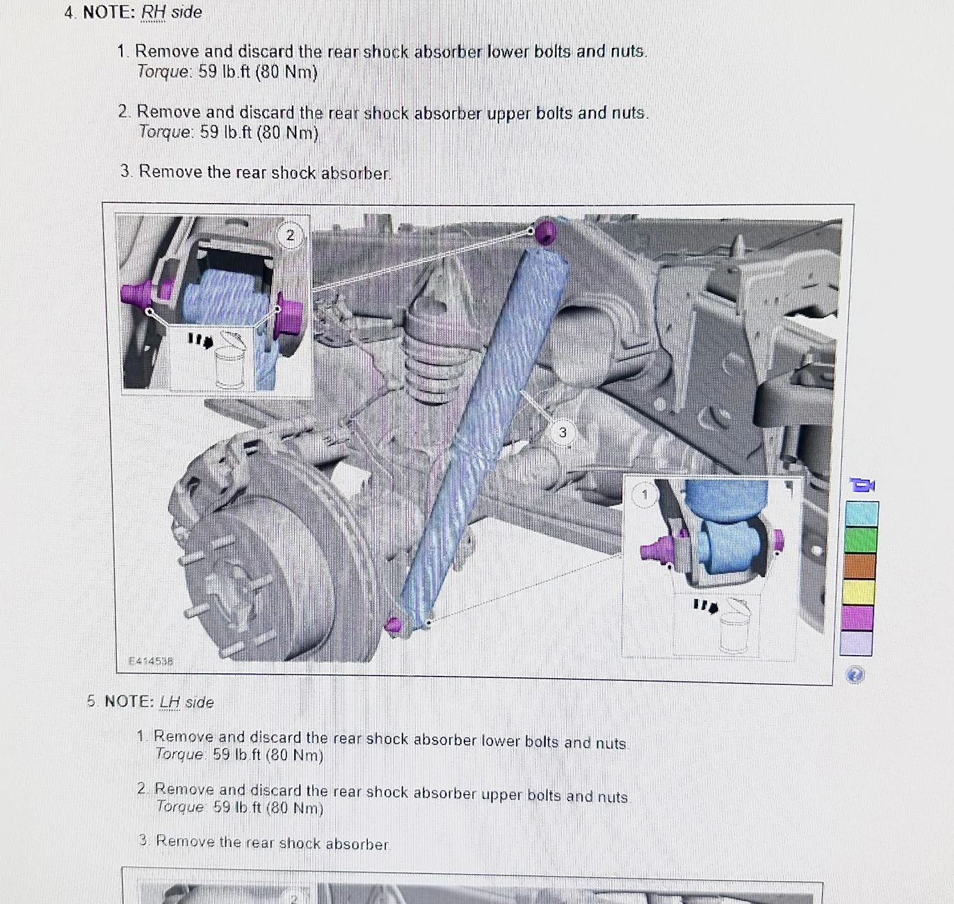

I ordered a set of Bilstein 4600's for my Ranger. Does anyone know what the torque specs are for the mounting bolts?

@BB1959 did you find the answer yet? My 4600's just arrived (well, they arrived a few days ago but the tax man gave me detention)
Edit: I just found the repair manual on usb drive I’d bought when I bought my paper copy of the owners manual; I’d misplaced the thumb drive and forgot about it until today. Anyway, that manual indicates 59 lb. Ft. (80 Nm) for both upper and lower bolts and nuts.

Thanks, I didn’t get an answer but torqued them to 60 ft/lbs. that was a lucky guess! 😬
