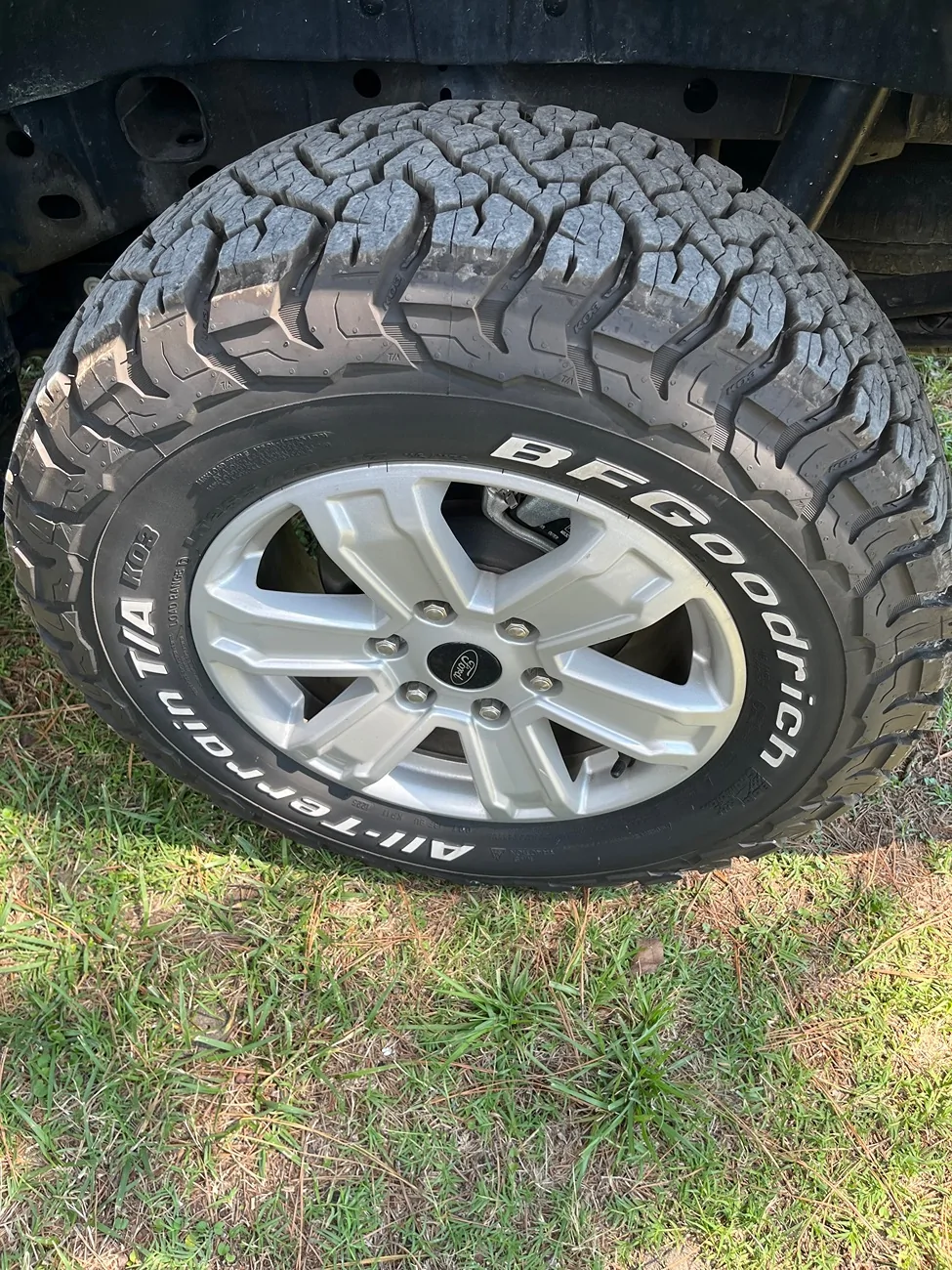

I tow a 20ft travel trailer (3800lbs) with our 24 2.3l. It’s a single axle trailer, and consistently swayed a lot, even with a weight distribution hitch. I replaced the stock 255/70/17 Goodyear A/T with the LT255/70/17 KO3 LRD. What a huge difference! The LT planted the truck, and wildly increased stability. I lost about a mile a gallon because of the AT tread, but it was an investment that was well worth it!
