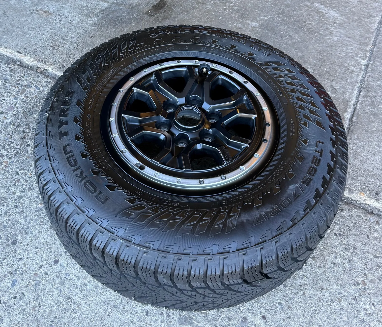

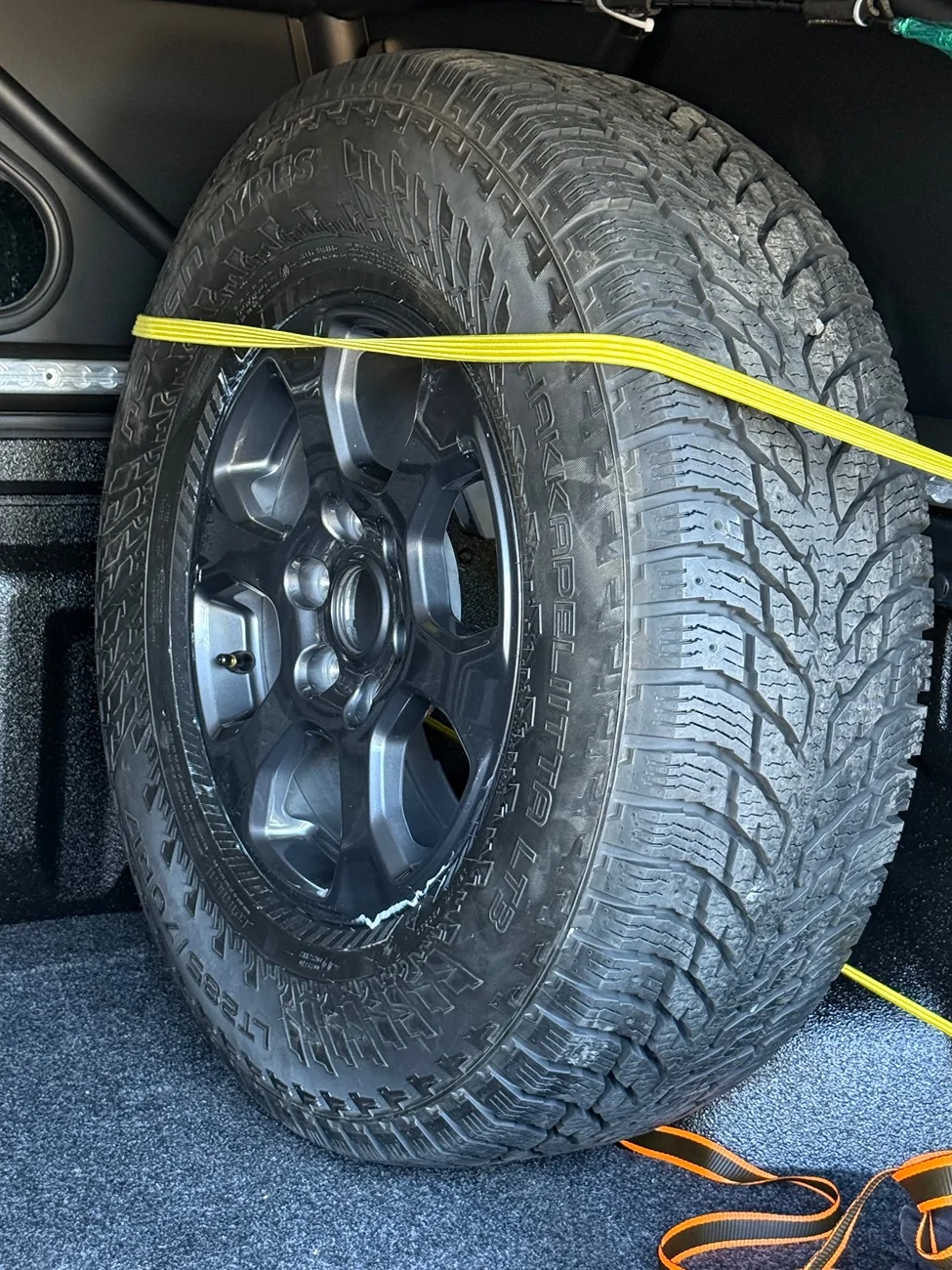

Fix your thread title, it says 27” wheels…..Yes, you are crazy, why not the Hakka LT3 in the stock RR size? It is a super fine winter tire, and your speedometer will not read fast. The stock Beadlock Capable wheels are a very poor choice for winter, they are 38 pounds each (with trim rings installed, I removed mine) and very hard to clean. The non BL ones would be fine.
https://na.nokiantyres.com/snow-winter-tires/nokian-tyres-hakkapeliitta-lt3/
My tires were just swapped over to my new Bronco wheels and I saved 56 pounds of rotating mass and those will be way way easier to clean.
Ford Ranger RR winter tires on stock 17" IMG_2043
Ford Ranger RR winter tires on stock 17" IMG_2045
