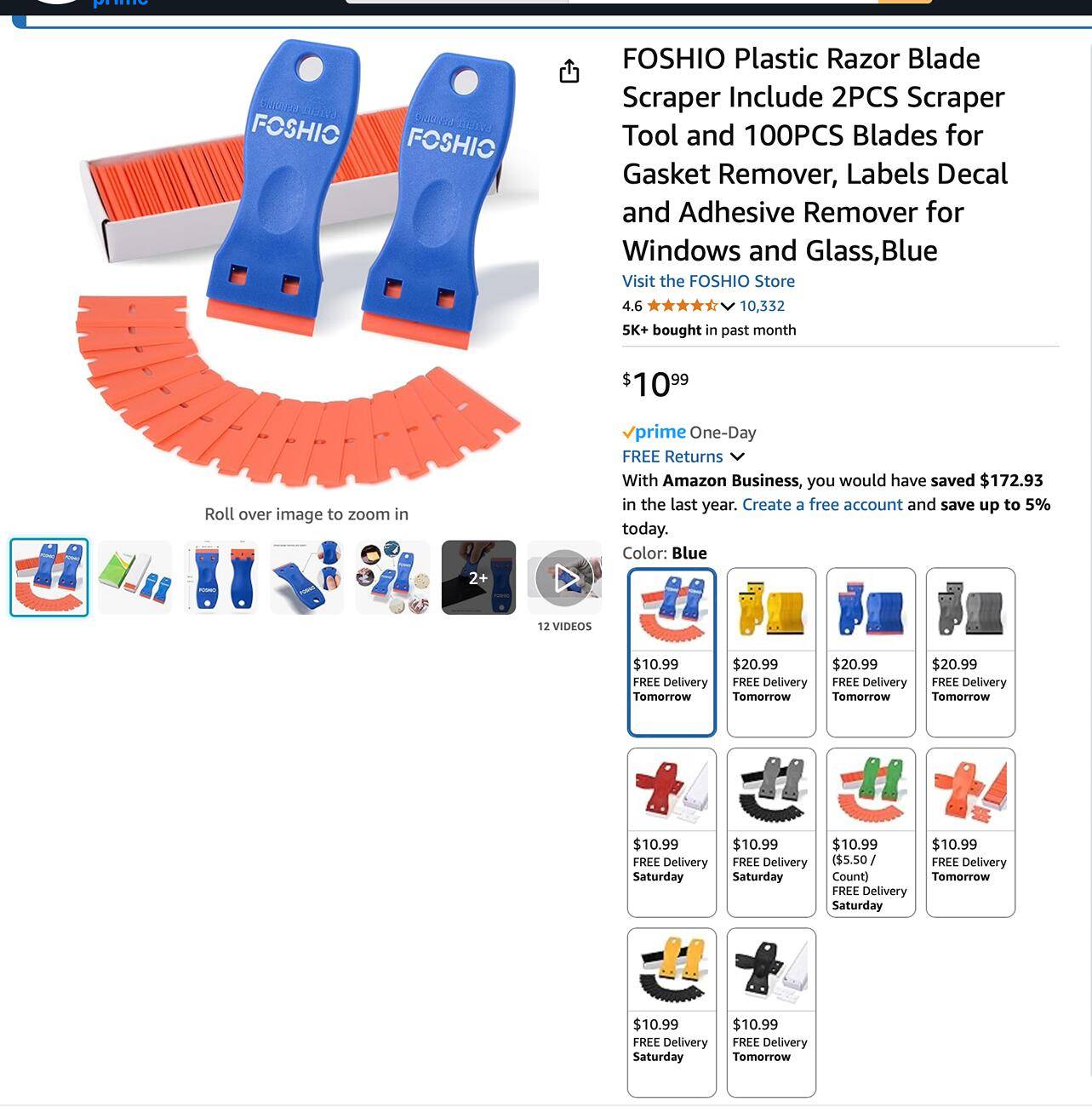

You can chill the sap using ice, it will make it more likely to just pop off with ***gentle*** pressure from a plastic scraper like this:
FOSHIO Plastic Razor Blade Scraper Include 2PCS Scraper Tool and 100PCS Blades for Gasket Remover, Labels Decal and Adhesive Remover for Windows and Glass,
