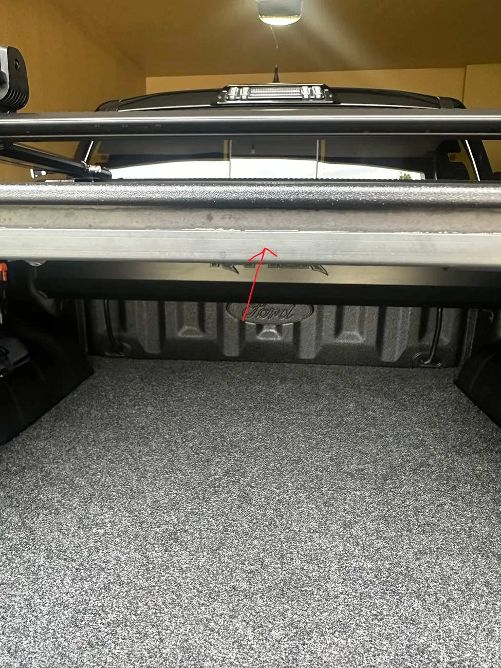

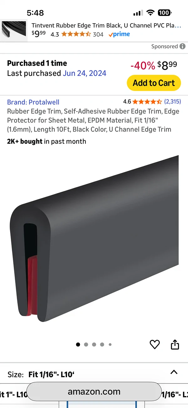

I have the Retrax cover and the weatherstripping was a tad too short from connecting with the top of the tailgate thus letting in water.
I used this and added it to the tonneau seal to extend its length. Worked well.

The arrow points to the Amazon piece installed on the weatherstripping on the cover like a taco shell. It goes the whole length wide and gave about an 1/8” more in depth to match up with the tailgate.
Oh hell yeah thank you
