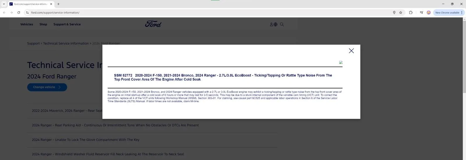

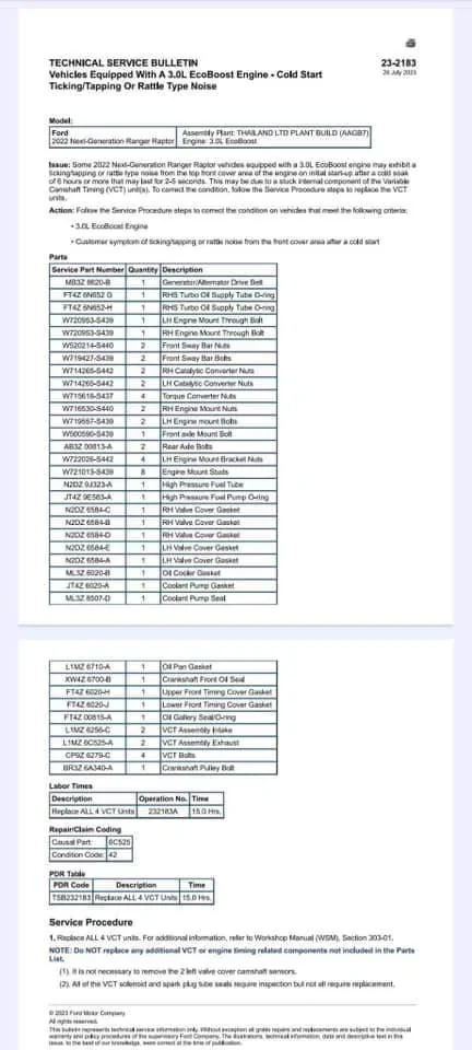

So, it seems like my Ranger Raptor has/is starting to get the cam phaser rattle issue on cold start.
The technical service bulletin documents a fix for the issue, but it does involve some taking apart of the car, which may or may not affect the car in other ways. On the other hand, if I do not do the procedure, I’m not sure what the effects of running the car with the issue are.
Ford Ranger Seeking advice on cam phaser issue 8bfb7082-1c6b-40ef-a376-701d913898e3
Ford Ranger Seeking advice on cam phaser issue IMG_2279
(Apologies for the blurry image, it’s the best copy I can find so far.)
Considering the pros and cons, what do you advise I do?

You 100% have bad phasers. The video you posted proves that. I was worried about the replacement too but ford has done so many of these now it’s just a common procedure at this point.
