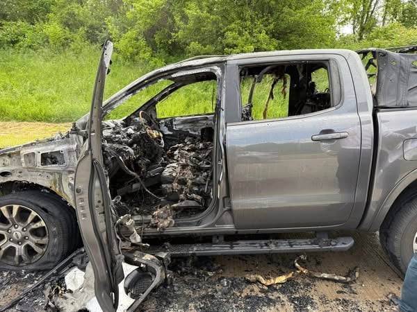

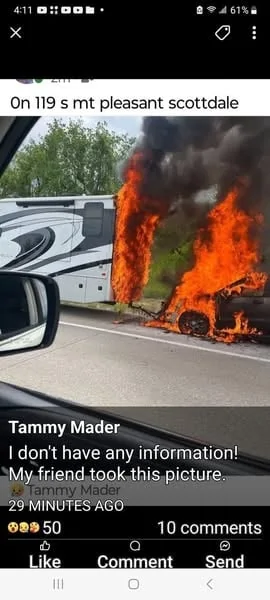

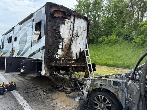

We spoke to Blue Ox and the rep said June 4th and July 9th for 2025 baseplates to be shipped out. Totally disappointed they didn't get ahead of this. We have an RVI3 braking system to go in ours. After seeing pictures of a ranger burned up behind a motorhome recently, make sure your battery won't go dead. Some software idiot thought it would be a good idea for the transmission to be changed automatically to park if your battery goes dead. Not good if you are flat towing!
Ford Ranger Setting up 2025 Ranger for flat towing Messenger_creation_21386D29-93E7-40DF-9175-389DCB8FF088
Ford Ranger Setting up 2025 Ranger for flat towing Messenger_creation_714FE463-6ADF-47CA-AF92-A64B91A127A2
Ford Ranger Setting up 2025 Ranger for flat towing Messenger_creation_298B684B-D45A-4F40-814E-D7D8A969BCC0

This is the very reason that ford said the 2024 is NOT flat towable, but someone decided to go ahead and flat tow it anyway. Any year prior to 2024 does not have this risk nor does the 2025.

Good for people to know, thank you.

This confirmed it was a 2024 model year?
If not can that feature be disabled in FORSCAN? (2025)
