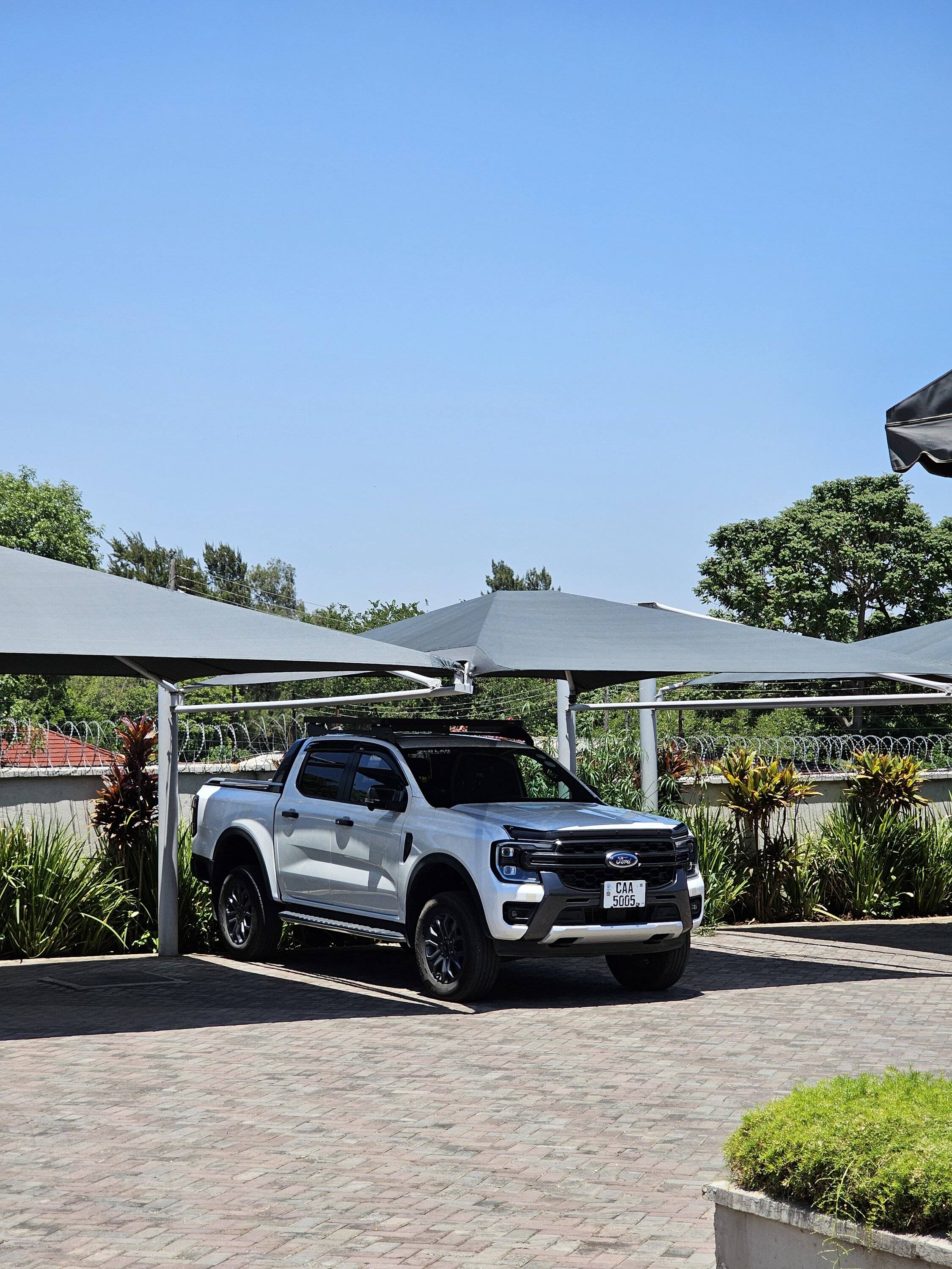

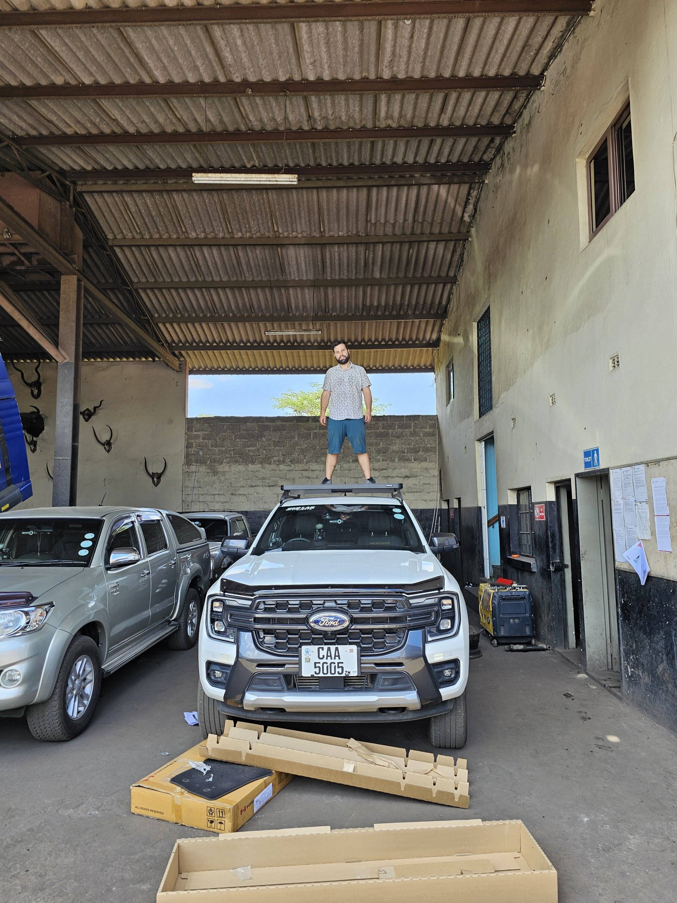

Pictures are just for attention and to show you my beaut! Its going to look very different very soon! Can't wait!
