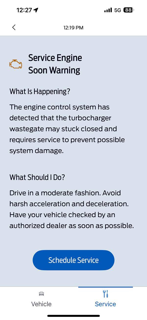

Update:
I drove my Ranger in to my dealership this morning, and I showed the assistant service manager the warnings that I posted here. She asked if I saw them on the vehicle, or only on the FordPass app. I told her that they appeared on the dashboard of the vehicle. She said “Ok. No problem. This should be covered by your warranty. The only reason that it might not be is if a rodent chewed through something.”

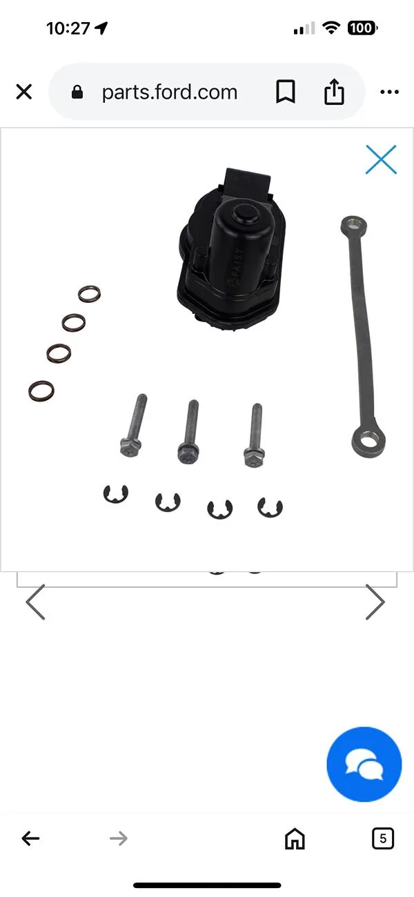

I waited for about an hour, and she came out to see me. She told me that the tech found that some parts were missing from the factory, and it was recommended that I do not continue to drive the vehicle so they were going to give me a loaner. I asked if she had more details on exactly what was missing. She explained that “some clips on the turbo wastegate are missing from the factory.” She explained that the parts would take a day or two to get and that my vehicle should be ready by the end of the week.
