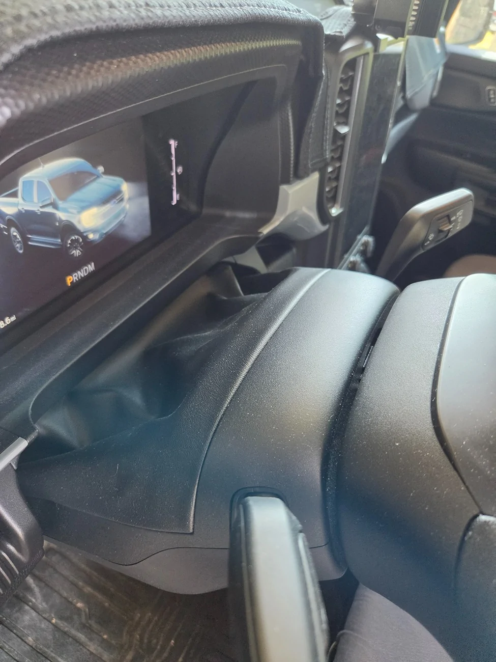

Can you take a picture? I am picturing the little shroud around the stalks inside the column housing. The dust covers, I geuss
This is the part I'm talking about

I never noticed mine being crooked but I will have to look. I had move my steering wheel when I got it and nothing looked odd but that was two years ago so maybe I missed it
Ya, I'm not too bothered about it being wiggly when adjusting wheel because like you said, how often are we really adjusting the wheel? Haha.
Just annoying it isn't straight

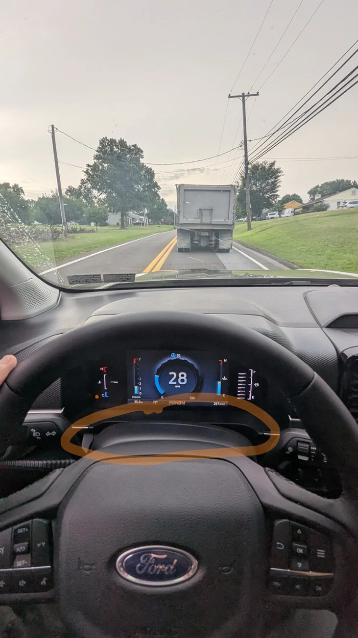

Here is mine.
Ford Ranger Steering column shroud crooked, goes loose when adjusting wheel 20260813_165345
Its straight when I adjust the wheel
